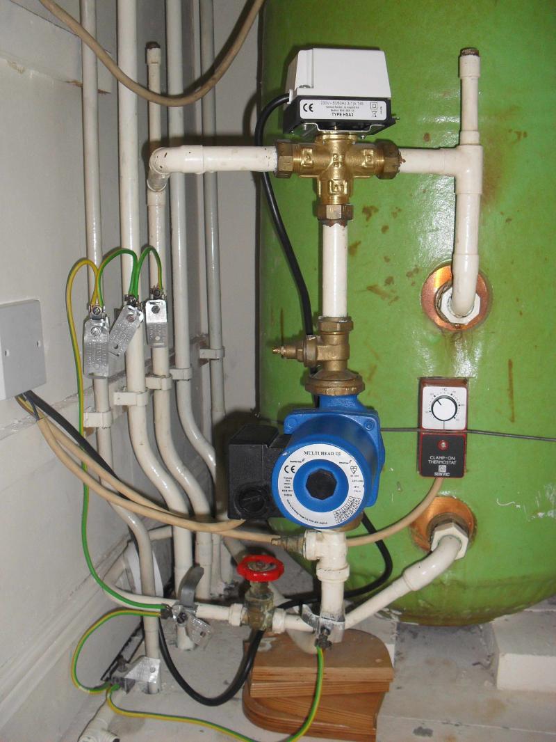

Thanks for the thoughts and advice so far. Here's a pic of the gear in the airing cupboard if that helps at all?
Looks like a standard Y plan system. The valve and pump are not original, although the cylinder thermostat probably is.
Likely that when the pump and valve were replaced, the wiring was messed up, causing the problem.
This should be an easy fix for someone competent with heating system wiring - which is not necessarily a gas or boiler person.
Sounds plausible. Thanks for your time and advice Flameport - much appreciated. J
