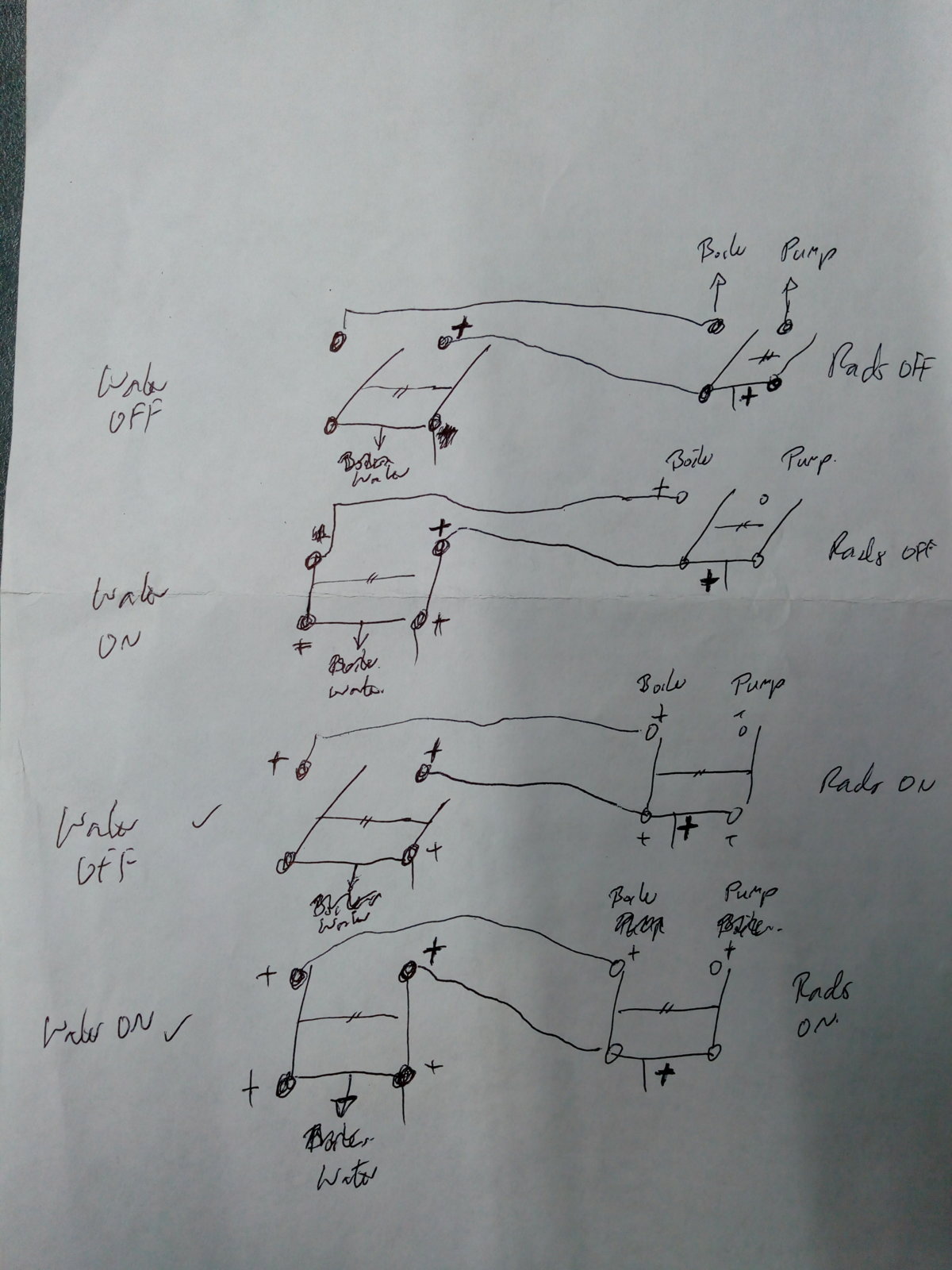

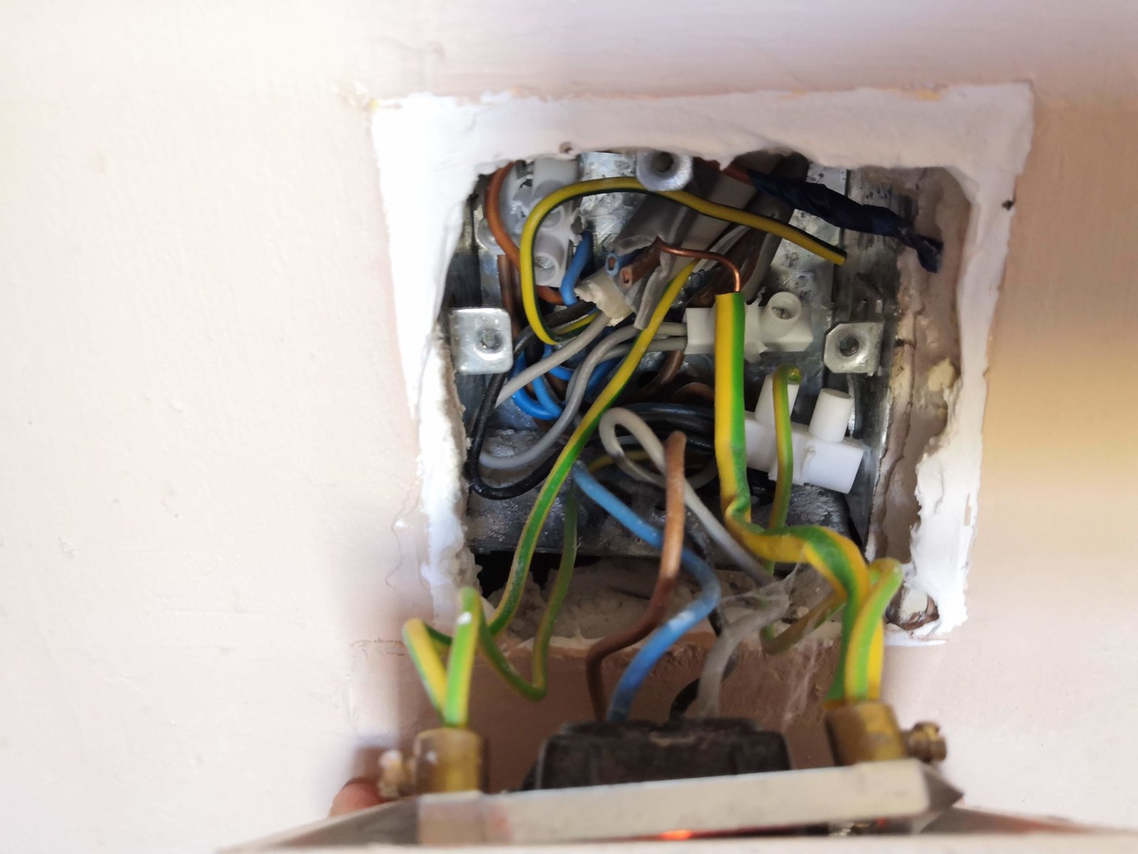

Looking at your pic of both switches I see the 'water' switch neon is on with both switches off, I also see a blue wire behind the 'rads' switch. Is there more than in your wiring diagram? and how have you assertained the circuit diagram, ie how did you identify the wires?
It's not that there is no neutral, it's just that they don't seem to be wired to these switches, which effectively seem to just on/off the live feed to the boiler/water pump for the Water switch and boiler/rads pumps for the heating, presumably the neutrals are connected directly, outside the switches.
In these shots you can see that there are plenty of other wires in the back boxes which are not connected to these switches. It's just difficult for me to follow where those go.
My wiring diagram before is just reporting what I find with the multimeter, in the format
L2 N2
L1 N1
Water heater...
Rads switch:
or one pole turns the boiler on
the other pole turns the CH pump on
but the wiring looks too modern for it to be like that (gravity HW)

There is a cable which seems to have been chopped so it seems likely at one time there was more control, however one would need to use a meter to work out what each cable does, not really some thing which could be sorted over a forum.
I consider the wiring mess in this house for the heating, and wonder if it had been bought by a non electrician how they would have sorted it out, the plumber and oil fired central heating guy I found to do pipe work and boiler service did not seem to have much idea of how to wire.
So it seems neutrals are available, I have found two pole push timers, but one pole has to be neutral, so only way I can see how it can be done is with relays, so it would seem a central heating programmer is likely the best option, I have the same problem myself, I want a relay to work part of the central heating, but it seems can't buy a simple self contained relay, I need to build it from adaptable boxes, din rail, relay base and relay. Then one looks at how to mount and look OK. Not so bad for me, room in cupboard next to boiler, but as to some thing which would look OK on the wall, not so easy.
