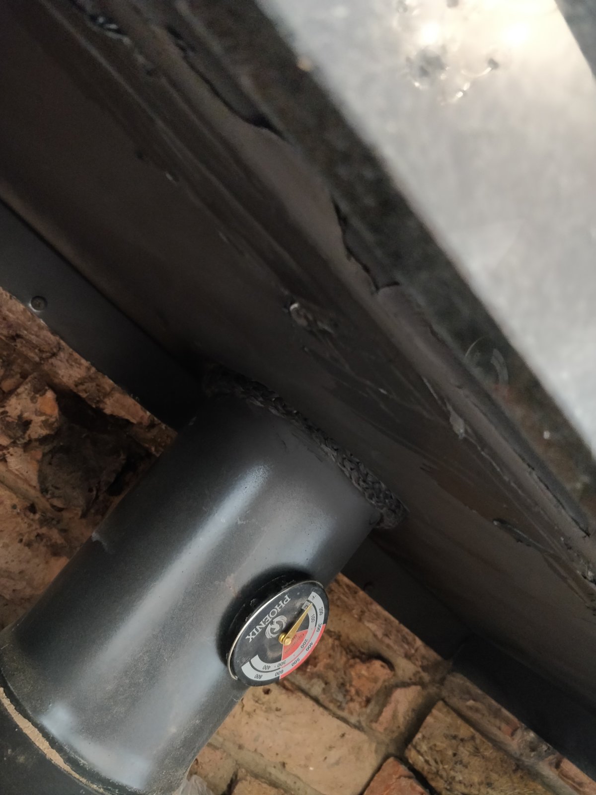

Wood burning stove

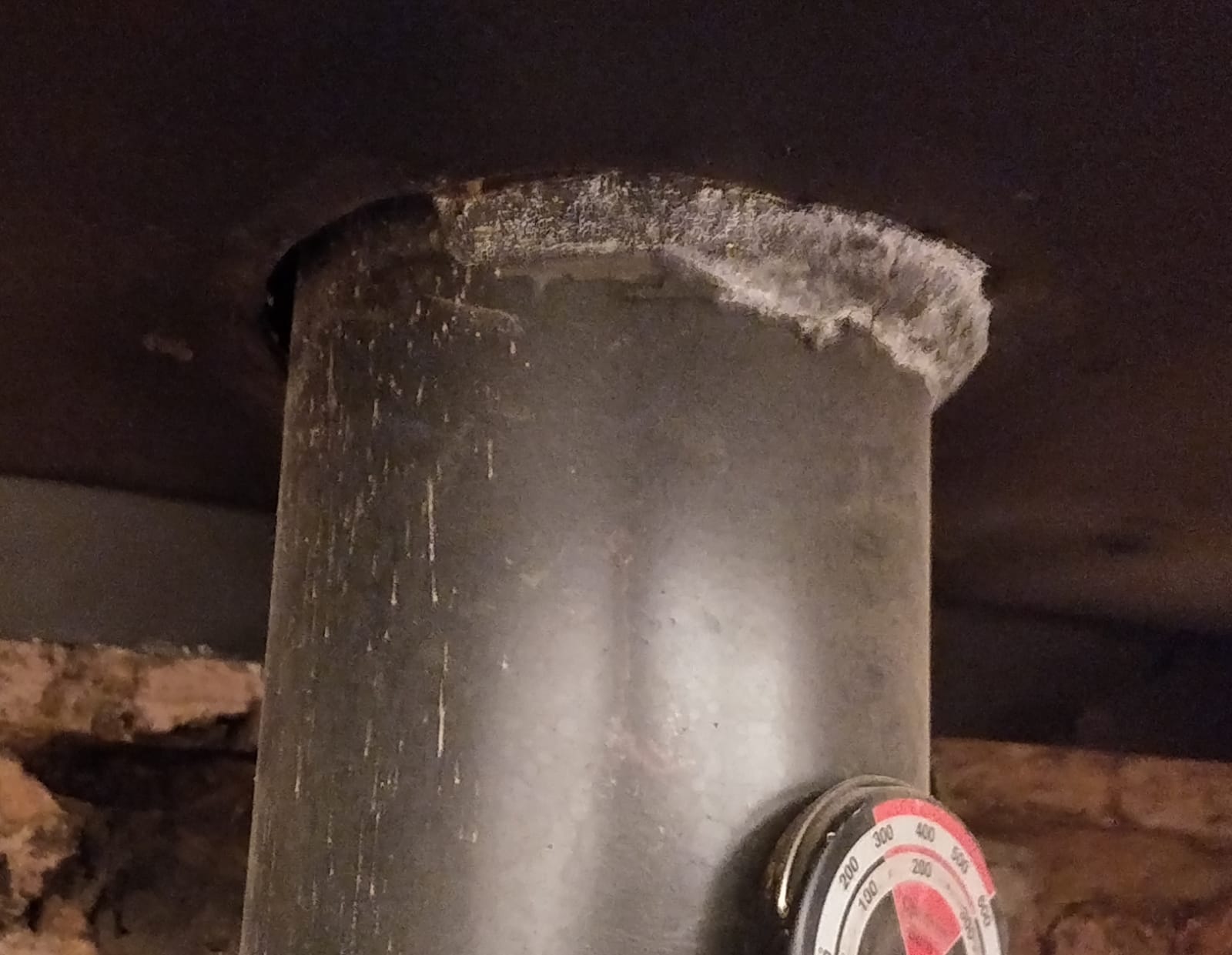

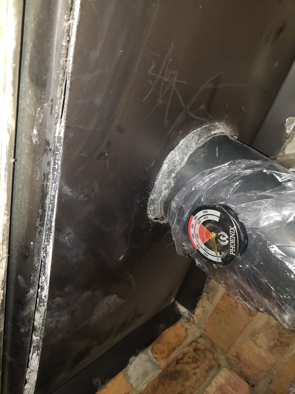

Thank you for all your replies. I will go to the house tomorrow and will take more pictures. There is a plastic sheet around the stove, simply because the house is being refurbished and there is a lot of dust.
I have contacted the installer, who is sick at the moment. His reply was:
" Yes that doesn’t look right and unsure what’s causing that"

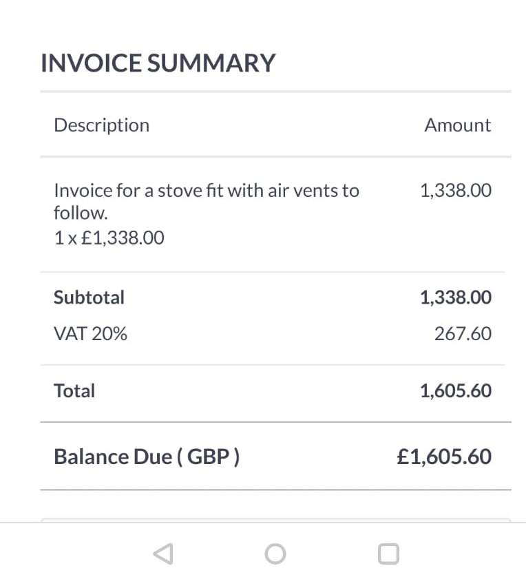

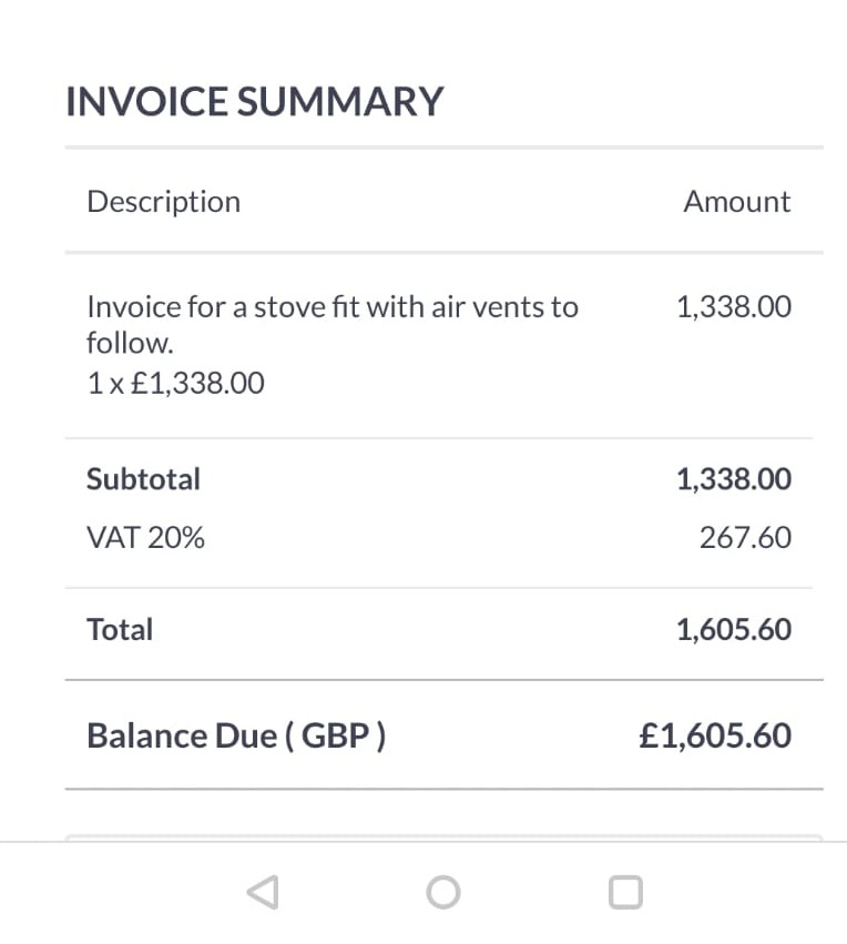

He installed the stove in less than 5 hours and I paid him 1.6k, and that's one thousand and six hundred pounds ( vat included). He didn't install air vents but they appear on the quote.
they appear on the quote. not the receipt? therefore you should have pulled him up on it before paying.
did the same person build the surround -brickwork etc?
Hello, I am still waiting for the installer to come back. I really wish to highlight that he only spent 5 hours at the property. I have now taken over the refurbishment of the house, however, as the invoice clearly shows, the installer was paid for installing air vents which he never did.
The plastic sheet is there to protect the stove from dust as the floorboards were taken up during the renovation.

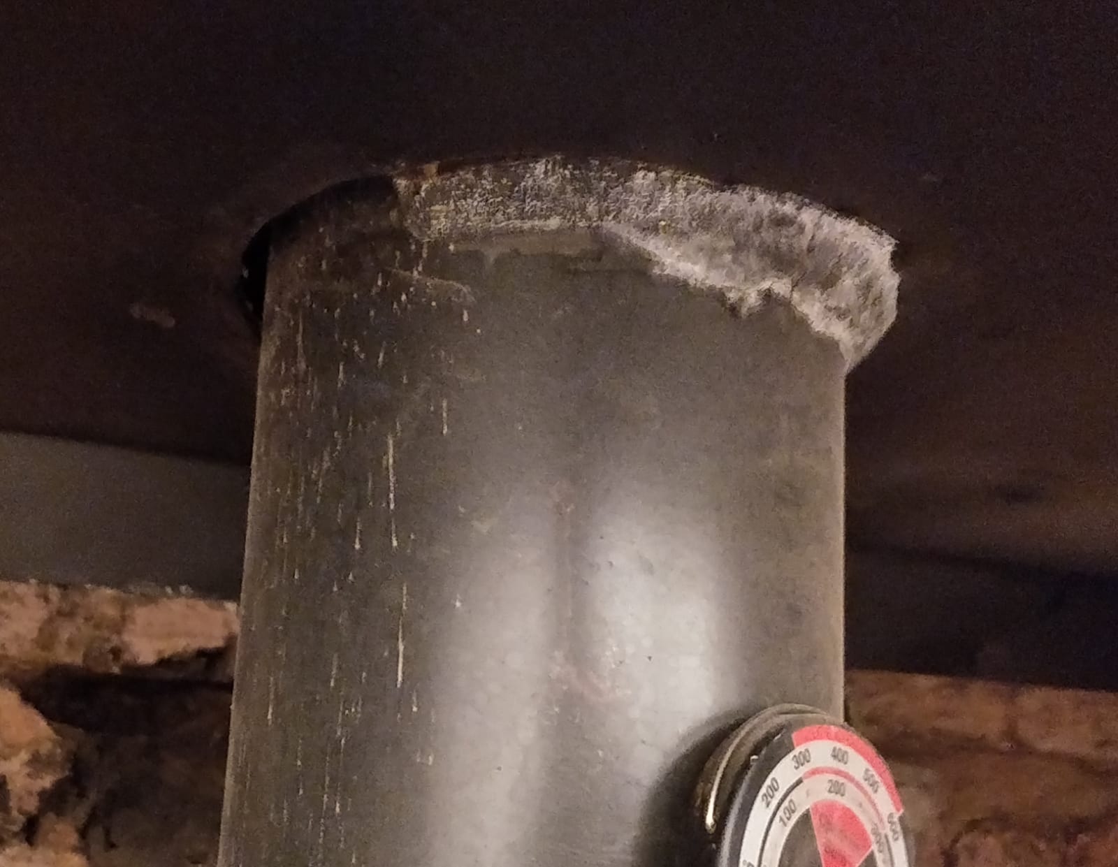

All you can do is to tackle him about it once he returns.....at the very least you need the register plate sorted and a collar fitted around the flue pipe where it goes through the plate....fireclay cement rarely lasts for ever in that position. You need some money off for the lack of vents.
Can I ask if a liner was fitted to your stove, and there's not an air inlet pipe at the bottom of the stove, which ducts to outside?

How much money do you reckon B. should refund for not fitting the air vents?

Air inlet pipes are strictly part of the stove's design - they are not compulsory. They are good though because a 'normal' stove draws its combustion air from within the room.....with external venting it doesn't, which prevents draughts.
I'm pleased to hear the stove has a liner.....much easier to sweep that way. The debris coming down is just soot coming from between the liner and the existing flue....even after a good sweep it won't dislodge every bit.
I've no idea what sort of ventilation B was going to provide.....dead simple if you have suspended timber floors, or its a hole in the wall if not - again if the stove is 5kW or less no external venting is required.

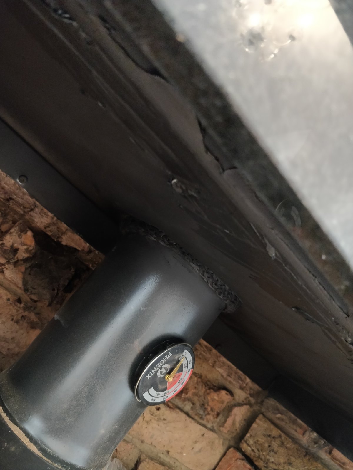

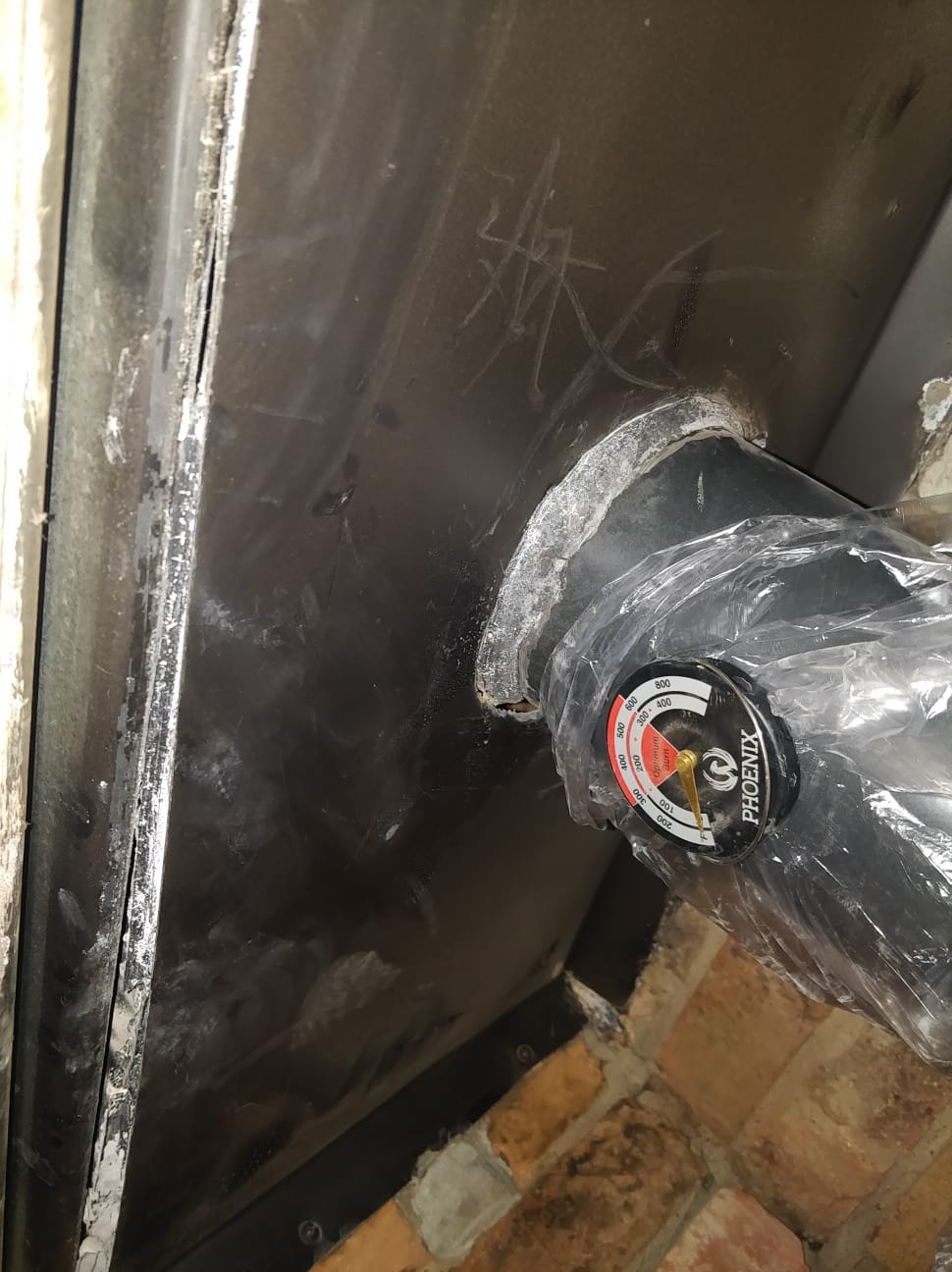

Hello,
I managed to get B. back. He has removed the old fire cement around the pipe and he has fixed the register plate.
Picture attached.
Does it look OK to you?
Thank you
It looks like he's spread on some intumescent mastic and done a runner.....
Do you know if he's actually fixed the register plate in some way, or just filled the gap?
Looking at where the stove pipe goes through the register plate, I think he's stuffed some stove rope in there, where a collar would be so much neater.

He used a drill to fix the register plate. At least for now the plate seems to be OK.
Thank you for suggesting the use of the collar. If what B. did doesn't resolve the problem, that will be next on my list.
