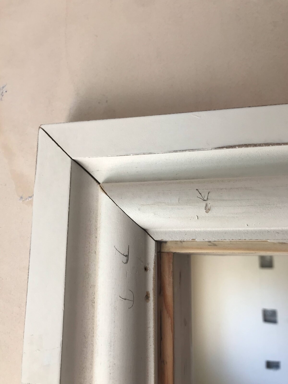

Hi, I have installed a number of new MDF architrave sets and need to fill some gaps at the corners (see photo). For these gaps, would 2 part wood filler or caulk be best? I also have some internal corners on skirting boards that could do with filling also. Would the same apply here? If Caulk, which is the best brand to go for? Cheers.
Caulk and 1-part fillers invariably shrink, so 2-pack wood filler is always going to be a better option, providing you have a machine sander (it is nearly impossible to hand sand the stuff - very, very slow going). Good brands include Everbuild and Metolux, although you can actually get by with a 2-pack car body filler, which is much the same sort of stuff
But I am left wondering why the gap at the mitre? Ideally you should have pushed the joint up tight and glued it together with a 2-part mitre adhesive (e.g Mitre Mate, Mitre Bond, etc), let that set (30 seconds or less), then nailed/pinned the architrave legs to the door casing (assuming you followed the traditional approach of fixing the head first). The judicious use of a sharp block plane can correct minor problems with the fit of a mitre joint
Thanks. Do those two part fillers have any resistance to cracking? This is upstairs so wooden floors and stud walls. There is no noticeable movement but i can imagine over the years things will flex and shift etc.
As for the gaps, put simply i am a first time DIY'er so i am still learning the tricks and best ways of doing things. I have managed to get the gap round the door casing even all the way round and when filled and painted hopefully it will look half decent!!
If you glued your architraves they shouldn't move. If they do move, then you have much bigger problems. Outside corner mitres on skirtings should also have been glued, if not then need to be cross pinned, so they can't move. Despite your concerns mitres rarely move if glued and properly fixed
I seldom disagree with @JobAndKnock but with your existing mitre gap, I would use a "lightweight" filler such as Red Devil OneTime or Toupret RedLite rather than a two pack filler given that the gap is pretty small. He is a carpenter par excellence, I am a pretty good decorator.
I would however agree that the mitres should have been glued. You might benefit from pushing some PVA glue in to the gap (wiping away the excess). When dry, fill with the light weight filler (and not a tub of 1 part old school filler- or powdered filler that you add water to).
The light weight fillers do not shrink. Please be aware that the "regular" tubs of 1 part filler will shrink, as will the fillers that you mix with water (as @JobAndKnock said). A disadvantage of the lightweight fillers is that that they are very soft but they are ideal for tiny gaps (and pin holes). I normally sand them using 180 grit silicone carbide paper (the grey paper).
2 pack fillers do not shrink, but they are not flexible. If, for example, you were to fill a counter sunk 5mm screw hole in MDF skirting board, After a year or two, the filler will be pushed out by about 0.25(?) mm as the MDF expands and contracts. Regular (rubbish) 1 part fillers will possibly (almost) fall out after 10 years. The light weight filler will be the most forgiving but given the hole size it is the most difficult to sand flat without leaving a very, very, slight divot. If you had timber architraves, given the gap size, I would have used 2 pack filler, on the flat surfaces.
One major plus for the light weight filler is that you will be able to sand it (by hand) without cutting through the pre-primed finish on the MDF. It might sound silly but once you hit the brown of MDF, it takes quite a few coats to obliterate the colour change.
Where the architrave meets the plaster and door liner, I would use a decent caulk. My go to brand is Everbuild 125. I would however prime the door liner first with water based primer. If you don't you may find that the caulk will soak in a little bit to quickly and when you run a wet finger over it, the thinner (outer) edge may be slightly ragged (ie not smooth)
Personally, I hate painting pre-primed MDF architraves. The manufacturer routers them and then sprays waterbased paint on them without any consideration of the "grain" raising. If faced with your architrave I would expect to spend an hour trying to flatten the finish on the rounds/curves. If it were timber, 10 minutes. Sorry, not a criticism of you, I understand why people use MDF mouldings but if you want them painted to a high standard, it requires a lot more work than well machined timber.

Thanks for the advice on fillers. I'll bear that in mind, although I would point out that in general I make my mitres and splices as tight as I can so as to avoid the need of filler completely (often by the use of a block plane to fettle the joint), but that when I do fill stuff I lay it on with a very flexible stopping knife (with nice rounded corners) with which I get the filler into the joint with very little build above the surface. That way I minimise the amount of sanding required and I minimise the amount of sand-through that occurs. I had wondered about how good the Toupret filler with fibres in it was (and for that matter what it is now called)

I'm not so sure I'd bother with the PVA. Probably better to remove the legs, mitre glue them and then renail. Trying to squeeze a wee bit of PVA isn't going to prevent the mitre opening (a problem with softwoods but not with MDF), and in any case PVA really doesn't hold a mitre joint together all that well unless you can cramp it together for a while (which is what "mitre spring cramps" were created for)
