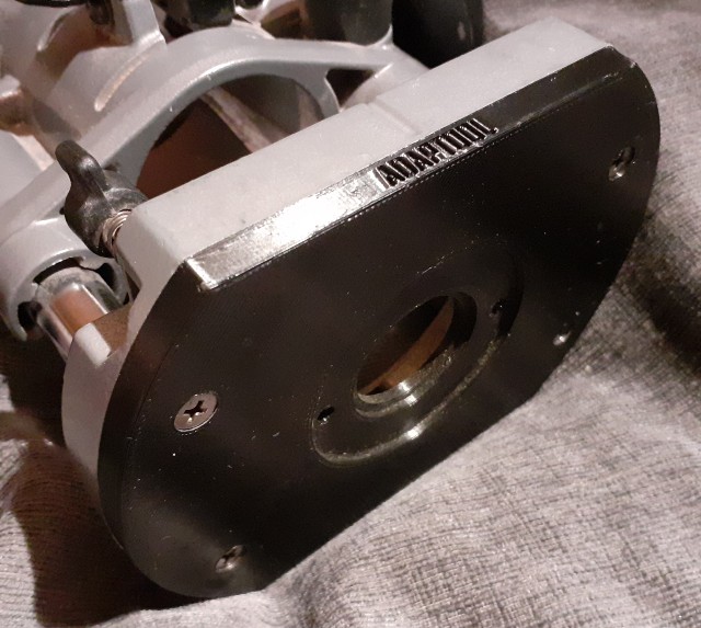

The base you showed has a built-in 30mm guide bush - the main problem with that is that there aren't many manufactured jigs suitable for small router which require 30mm guide bush - 16mm is more commonly used, surely? That is the guide bush size required for the Trend hinge jig (in conjunction with a 12mm router cutter) and a number of other cheaper copy cat jigs. My own preference is for a baseplate which can accommodate a range of jigs - like the one below which will accommodate Elu MOF96/Trend T5/deWalt DW615-style guide bush (incudentally, that is a Katsu plunge base, not a Makita one, but they are almost identical and 100% interchangeable):
The OP stated that he was on a budget, so I didn't think that getting into jigs at this stage, either home-made or manufactured - rather I thought it would be more important to learn the basics before tackling more advanced techniques. Sort of learning to walk before he tries to run?
