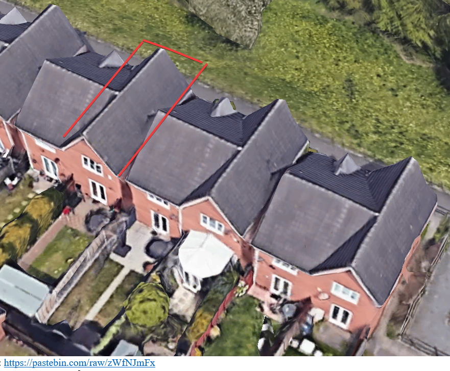

If your house is 2-bed with a truss roof, presumably its a relatively modern terrace- or semi-detached house, right?
Truss roofs are not the easiest to convert, but it can be done. In that case, a dormer loft conversion would probably need four steel beams - one for the ridge, and three for supporting the dormer and floor (unless you use the Telebeam proprietory system noted by Wessex - though likely to be expensive).
In some cases, you can build the dormer front directly off the inner skin and so avoid one steel beam.
The rest of the dormer, ie floor, dormer front and cheeks, and roof is usually done in timber.
Can you post a pic of the plans (with address deleted)? Would be interesting to see how its 'all done in steel'.
It's semi-detached. I included the photo with a marked house in question. I will PM you plans shortly, there is lots of drawings/calculations and I'm not sure what is relevant to your question.

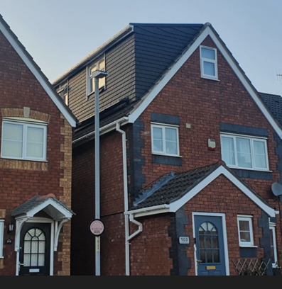

I'm looking for this type of conversion:
It's a permitted development area so just building regs.
I hope you are 100% sure you have complied with all the permitted development criteria or got a lawful development certificate from the council.
Otherwise that could be a very expensive mistake. I'm not sure why anyone would want a loft conversion like that where you can't have proper windows.
I got the lawful development certificate from the council. The windows will go on the sides of the dormer. As you can see there are limited options and this seems to be the best way to get extra space.
