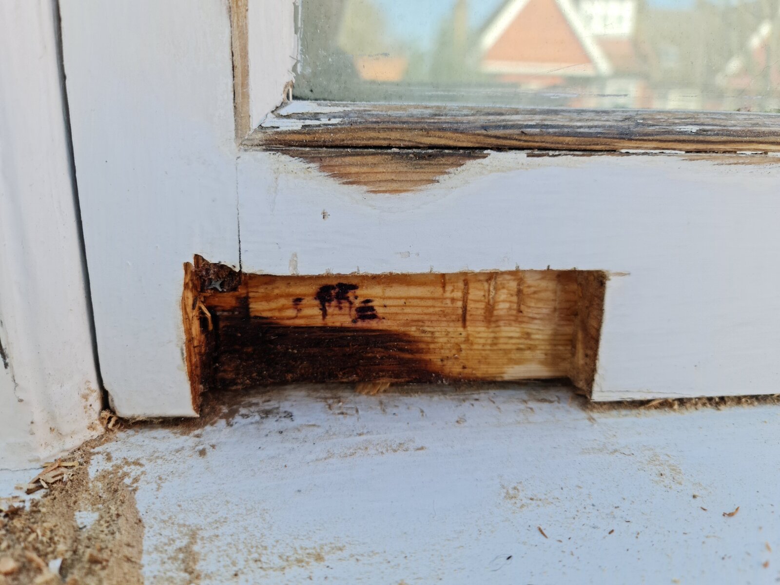

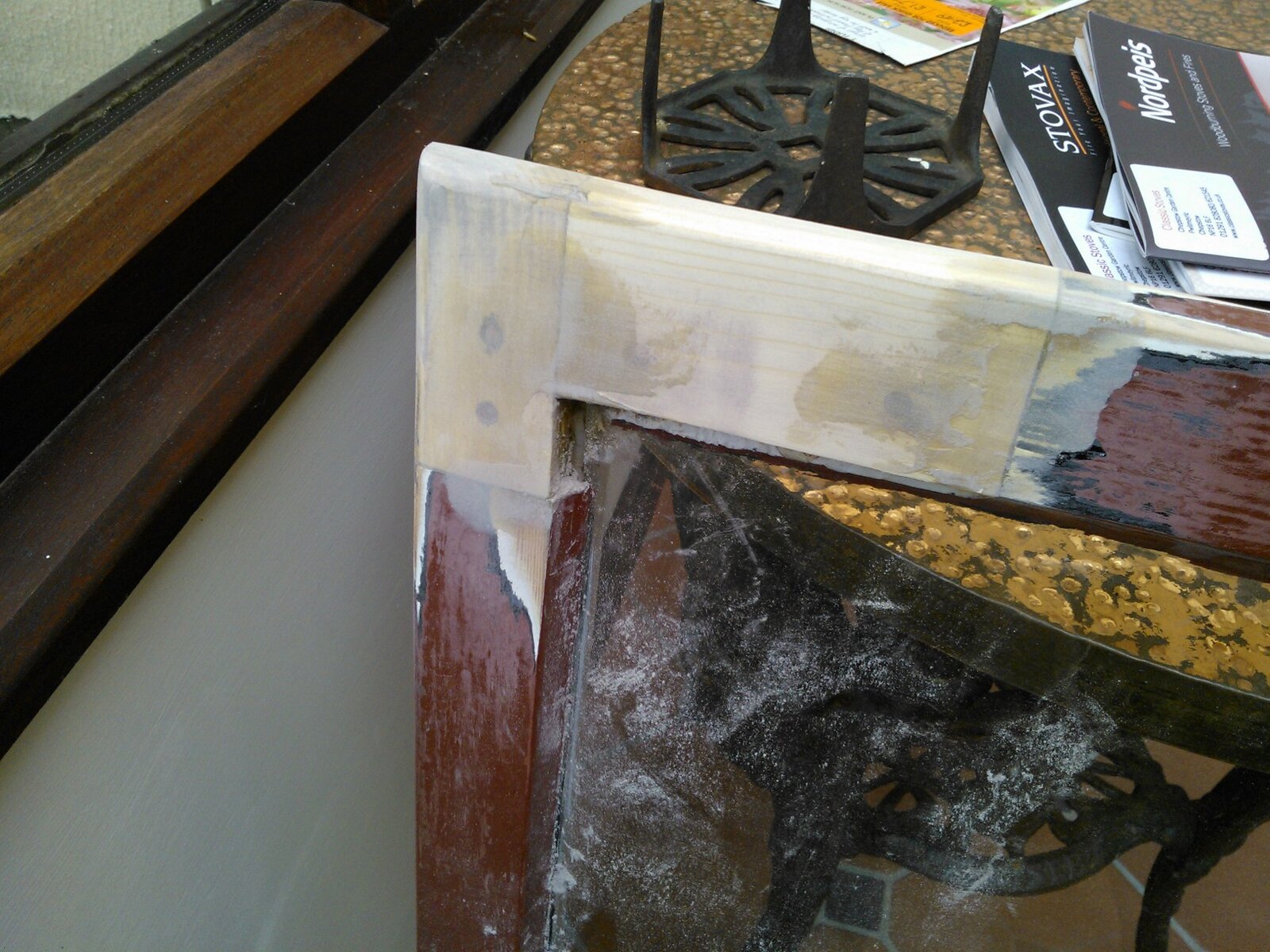

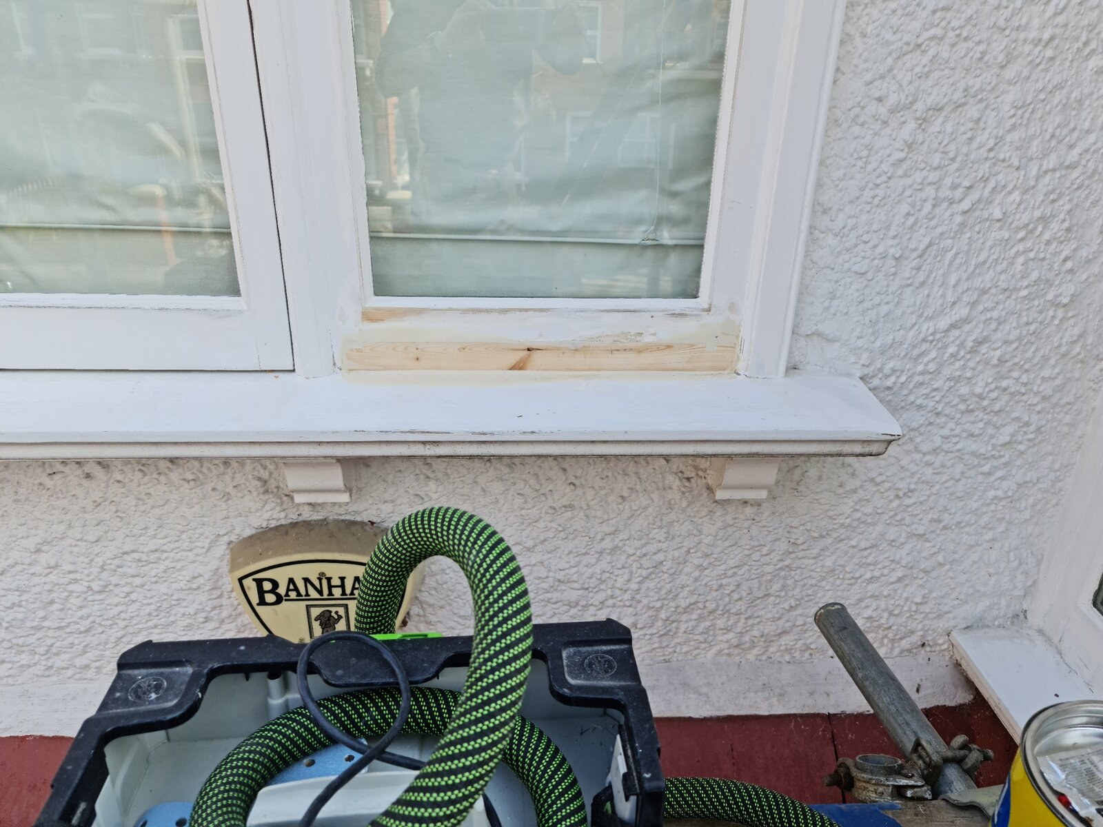

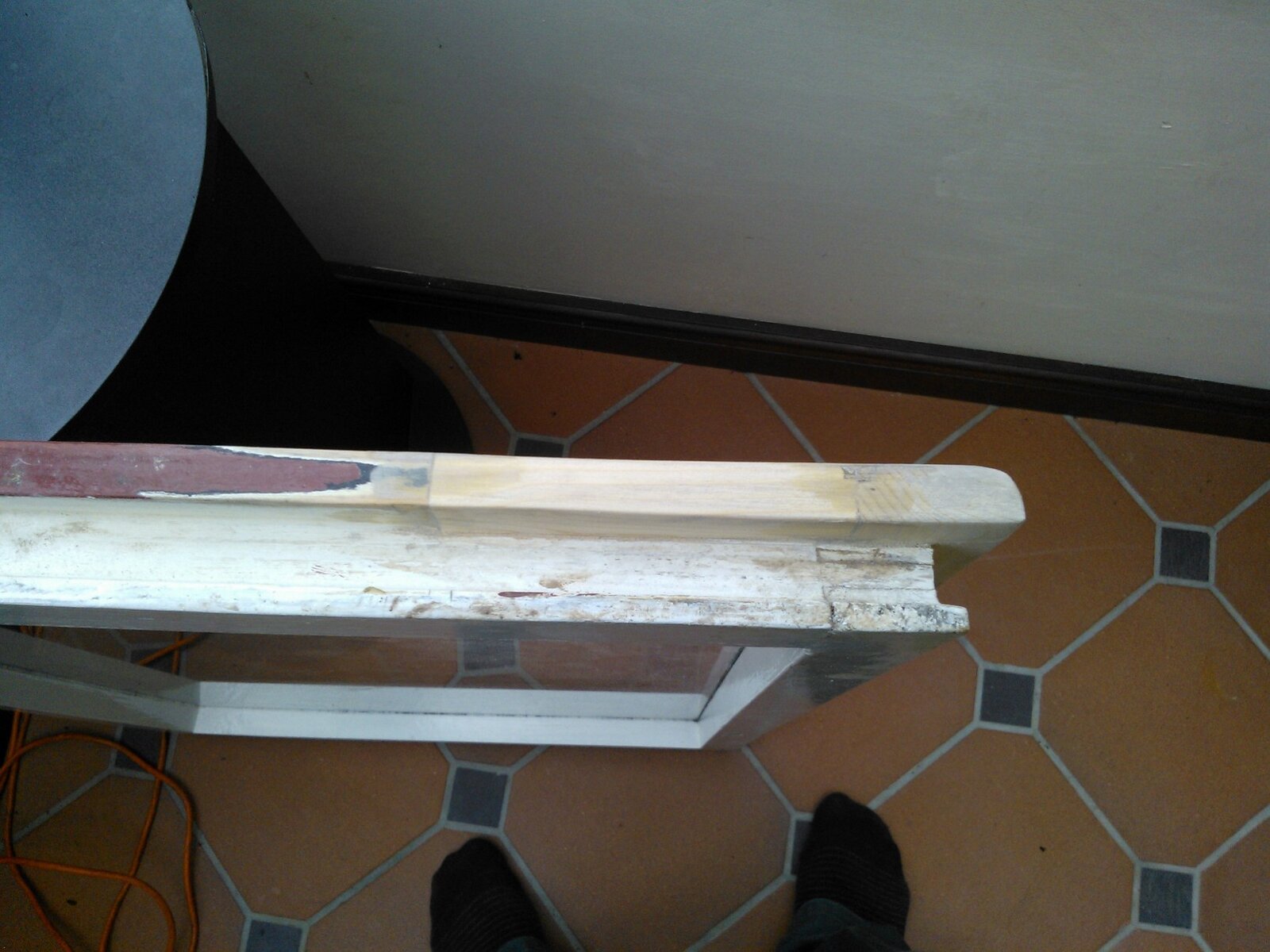

The water ingress is pretty common on timber double glazed units.
I am a decorator and having been dealing with this kind of stuff on my current exterior job...
Sorry, it is not the best of images but it was caused by water getting behind the exterior wooden bead and running down on the inside.
In the next image, I had to dig out most of the lower part of the window and splice in a section of 40mm tall by about 12mm deep timber using epoxy resin
On other windows, I had to use a router to create the profile of the wooden glazing bead and then use my bandsaw to rip it down. I then applied a bead of MS Polymer (CT1) to prevent water ingress where the timber moulding meets the glass.
It is definitely "do-able". the problem is that epoxy resins are expensive. If you are only doing a small job, £40 for a tube of epoxy resin plus £25 for a gun, plus £15 for the 2 pack epoxy wood hardener is expensive. You can buy epoxy resin that will work in a normal skeleton gun though
https://www.duluxdecoratorcentre.co.uk/repair-care-dry-flex-4-2-in-1-2022102
it is still £30 but no need for the special gun.
