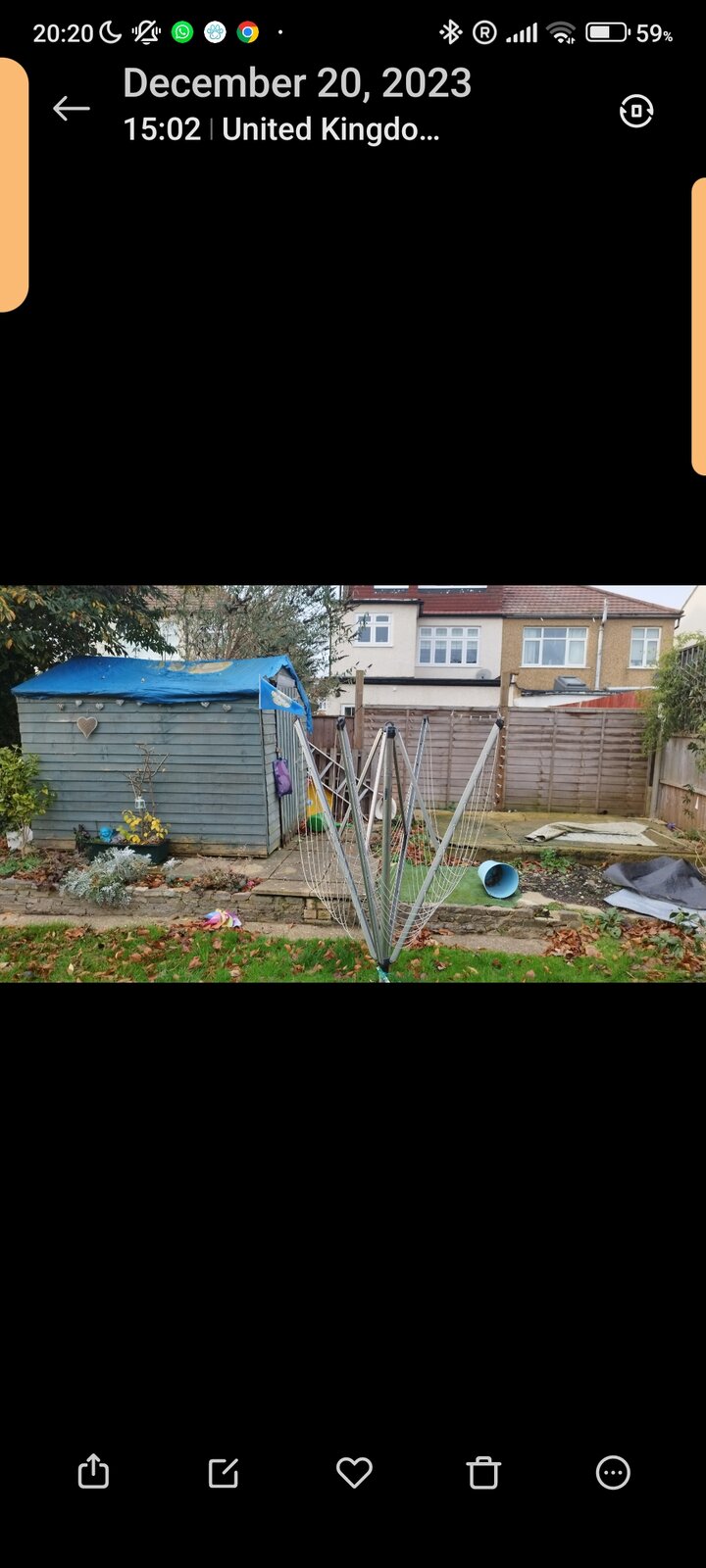

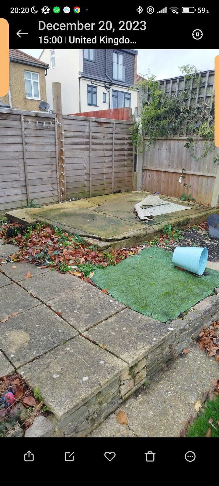

Hi there, I'm an avid woodworker and looking to build myself a wooden workshop with an attempt to soundproof the building properly in my back garden. To simplify things I will make it 15sqm floor space and 2.5m from the ground to the top of the roof. The location will very close to the boundary with two neighbours. The two attached pictures show the concrete area the outbuilding will be positioned and vicinity to both neighbours' fences.
As I don't know my neighbours yet (just moved in) I'm really worried about upsetting anyone with an eyesore structure and noise. They may well be nice people but I'm worried that once I'd get started complaints will follow. I'm also aware that woodwork can be loud at times, especially when opening windows for ventilation during summer season. That said, it's not a job for me, just a hobby so takes up only a small portion of my week.
I wonder if the attitude should be, so long as I'm under permitted development to forget about what my neighbours might have to say about it and get on with it? And yet why am I so bothered??
Should I be looking to spend money on prior lawful development certificate and building regs visit? Should I write a letter to neighbours inviting them to voice any issues beforehand?
Any thoughts would really be helpful to build up my confidence before I take the plunge.

Just go ahead and build it
I dont know what wood working power tools you want to use but they can be noisy -so just be considerate, if your neighbours are outside on a summers day dont start up the lunchbox thicknesser and extractor
if it was me I would do STS construction board around the rear two sides that face the fence and featheredge boarding on the garden sides
you could use rockwall insulation as I think its got better sound insulation
you need to use 50 x 25mm vertical battens externally over the studwork and then the cladding -to create a cavity, that makes it very water and weathertight

Just go ahead and build it. Agree you need a walk space between it and the fence/boundary to maintain it and the fence. Build it to PD standards, that way you will shut any adverse comments down.

I'd build it right up to the fence and choose maintenance free materials - even if they are different to the parts that will be visible. The closeness of a wall to three fence also protects the panels from weathering.
