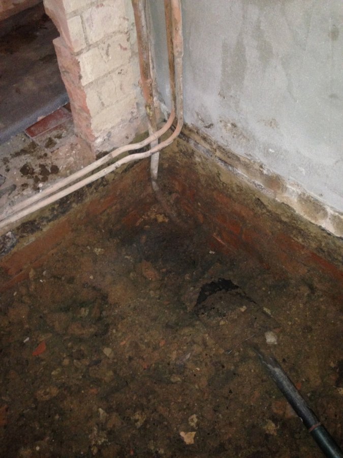

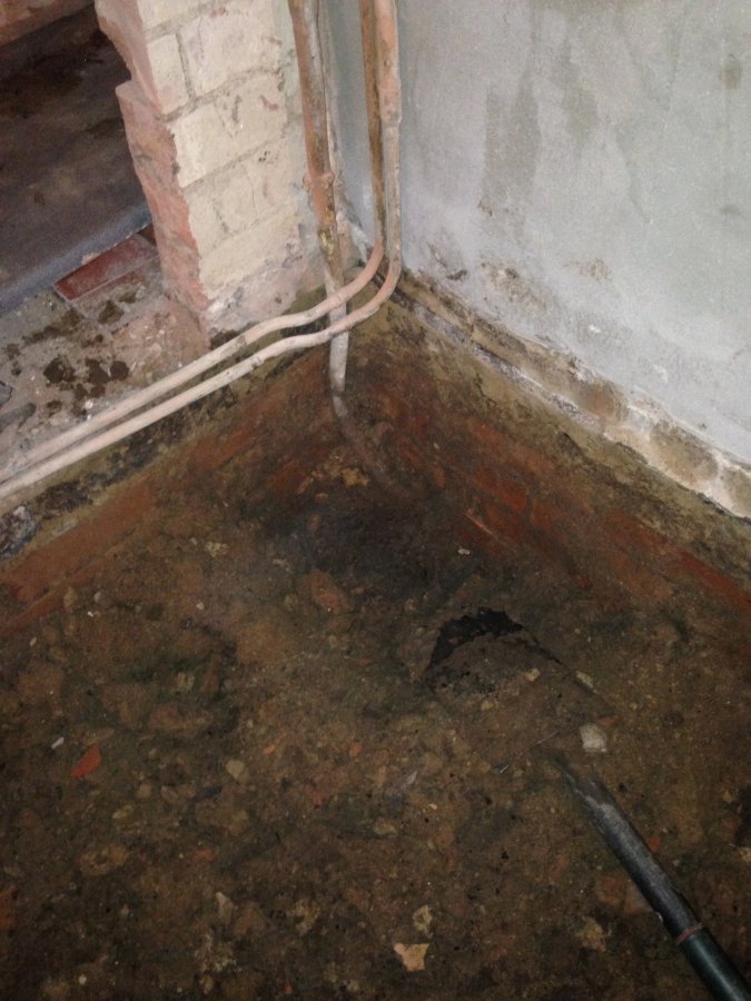

The clay under the quarry tiles is quite damp. theres an old lead water pipe which is the water main coming in there and when I took the sink off the cold water pipe was dripping where the kitchen tap was connected... ( have added service valve and stopped that drip )

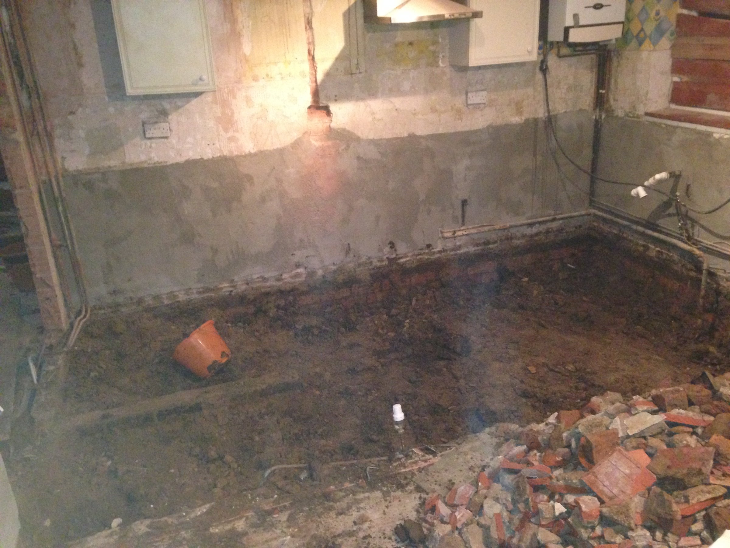

OP, why not post pics of internal above floor and below floor level - and external at ground level?
Is the water main still in lead?

ok I will take some pics tomorrow.
yes the mains is a lead pipe to the street.. Severn trent have sent forms so we can find an approved plumber to replace it with PVC- the house is almost 100 years old!

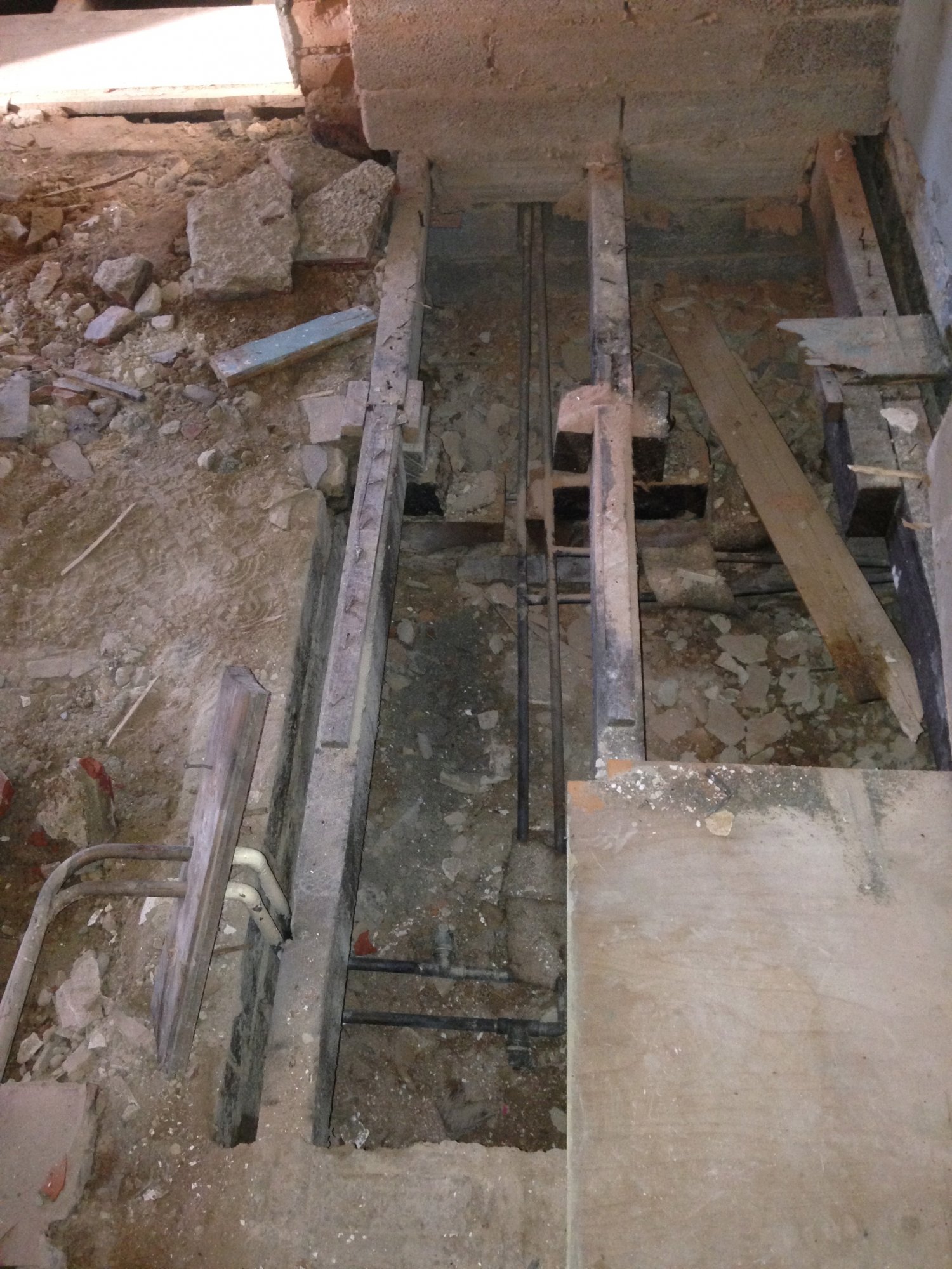

i like the soft wood on the wall for mounting rather than hangars,, actually I see the builders just sat the original joists on dwarf walls....
soil seems much wetter in the area of the lead water main - theres also a drain on the other side of that wall - looks like the water main follows the drain

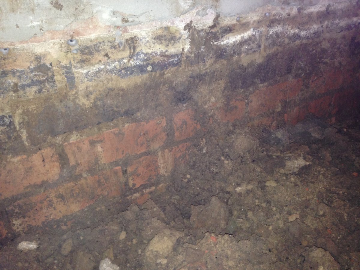

all the clay is a bit wet actually but the other 'wetter' spot is by the kitchen sink... and theres a drain on the other side of the wall there.

10cm will be plenty for ventilation, but definitely resolve the sources of water first. I think you can get a free repair on a lead pipe although it may have to be the one in the front garden. Replace with blue mdpe.
Thanks for the photos!

You could bolt plates to the walls as job&knock suggests - if you do then wrap the back of the plates with DPC material to protect them from damp & fill the bolt holes with silicone before entering the bolts.
Or you could cut pockets in the walls and insert the joist tails - the tails to be capped with DPC material.
If the joists rest on any knee walls then isolate them from the masonry with strips of DPC.

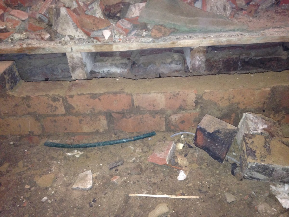

looks like I can sit them on the old wall by take a course of bricks out- will the brickwork be close enough to level if I use it as a guide on the other side?
I will probably get some treated wood - if I bolt it to the wall I worry that the wood will rot in time. ( so need to use damp proof membrane between it and the wall. fill holes with silicone to stop moisture goign up the bolts.
What do you mean by "old wall" and why would you "take a course of bricks out"?
Brick courses are good guides for a rough level.
Treated wood is not necessary.
Is the pic with the green hose showing a knock-through? Is this the old wall etc?
FWIW: clean up & remove all debris as you go along - it will make working conditions far easier.
yep pic with green house is the wall thats been knocked thru. I will have to take a course of bricks out to get the joists to meet up.
I took a few bricks out to take the photo..
