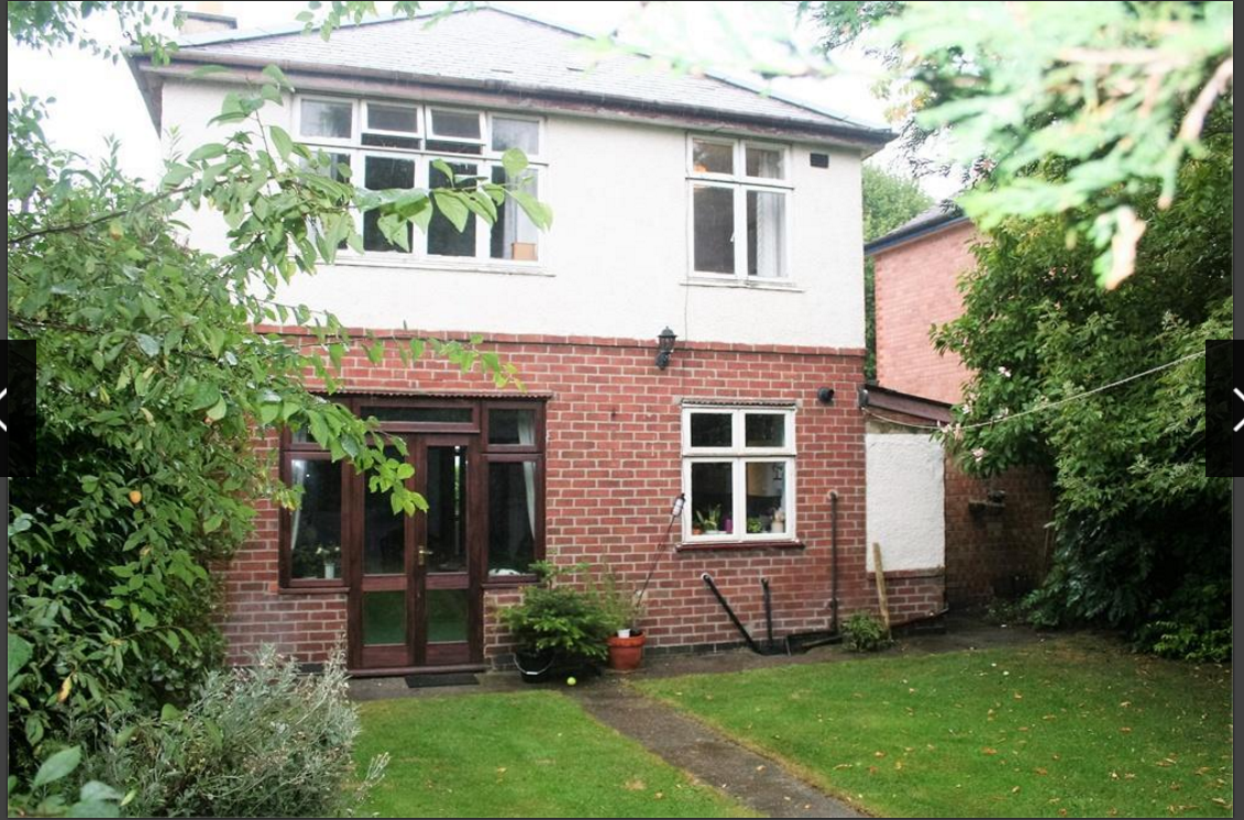

Why not post pics of the outside at ground level?

searching for photo now - if it doesnt exist -will have to take one... but basically the exterior ground is about the top of the bottom course of blue engineered bricks in previous photos
havent got a close up.

actually seems I have dug down at least 20 cm below the level of the existing joists ( if they were extended over the new void )
