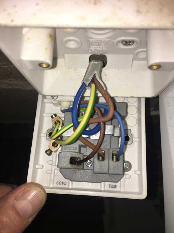

Had a new Worcester Bosch Greenstar 37 fitted just over 9 years ago, brilliant boiler, never a problem. Then two weeks ago, no hot water. Up into loft to find boiler dead. No lights, nothing. Nada. Called out the Plumbing/Heating firm that fitted it/did the re-plumb of the house, who took the front off, had a look & a fiddle and found the isolation switch next to the boiler had burnt out due to "a standard 13a fuse being left in the switch when fitted, instead of being changed for a 3a fuse..." (we had the whole place rewired at same time as new boiler) - so he advised me to fit a new isolation switch & 3a fuse which I did. The boiler now started up and worked as before.

So the fused spur burnt out because it had a 13 Amp fuse instead of a 3 Amp ???? total rubbish, if it popped a 13 Amp then there is a real problem with your boiler or its electrics, the EA on the boiler is not connected, that is a different problem
Thanks Ian. From what I understand, the actual fuse was ok. Trouble is, as someone who knows zip about these things, I could be told anything... The 'live' wire from the boiler inside the fused isolator switch had burnt through so had lost contact - see attached image. I think we probably need to call in an electrician to check it out...

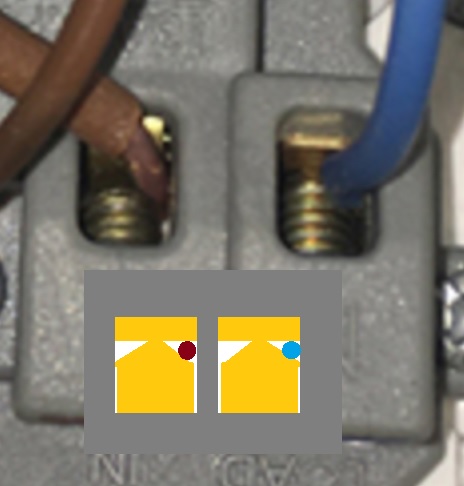

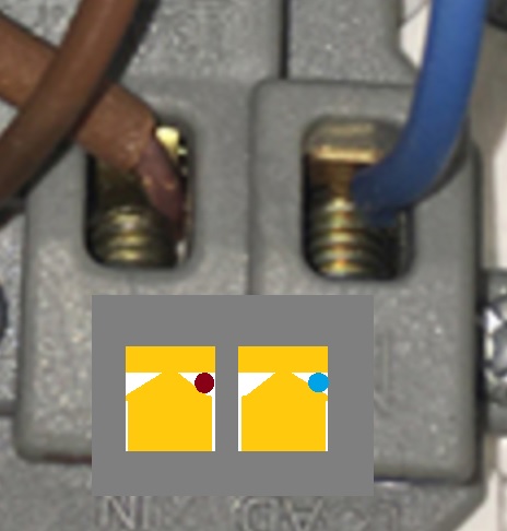

When you replaced the isolator did you ensure that the screw was pressing onto the wire and not onto the terminal plate with little if any pressure on the wire
Bending a U end to the bare wire creates a better connection

Yes, I did several years in Avionics a long time ago, but those lessons in how to make a firm connection never leave you! But a great reply, thanks!
looks like it has had a poor connection, cut the wire and strip it and make a good tight connection and fit a 3 Amp fuse, the post about a fixed price repair from worcester wont work they will not repair anything outside of the boiler
