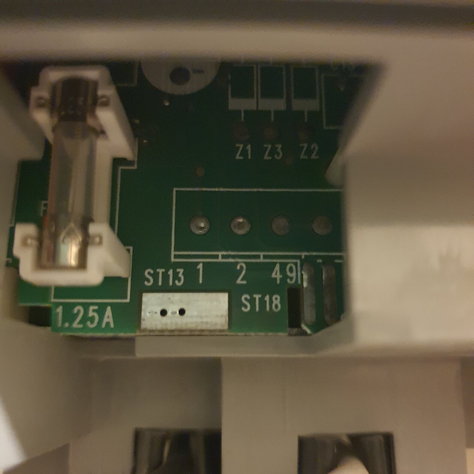

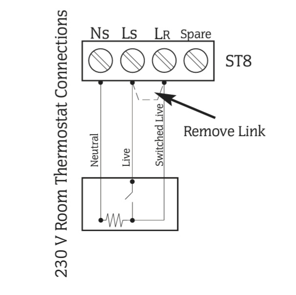

Hi all,

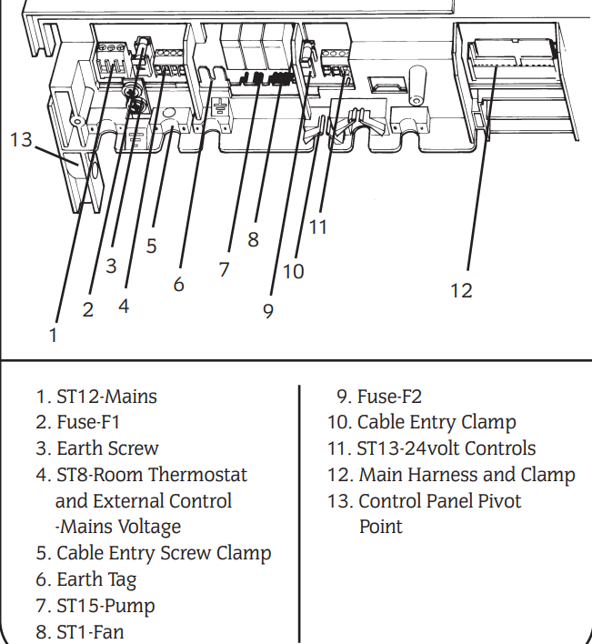

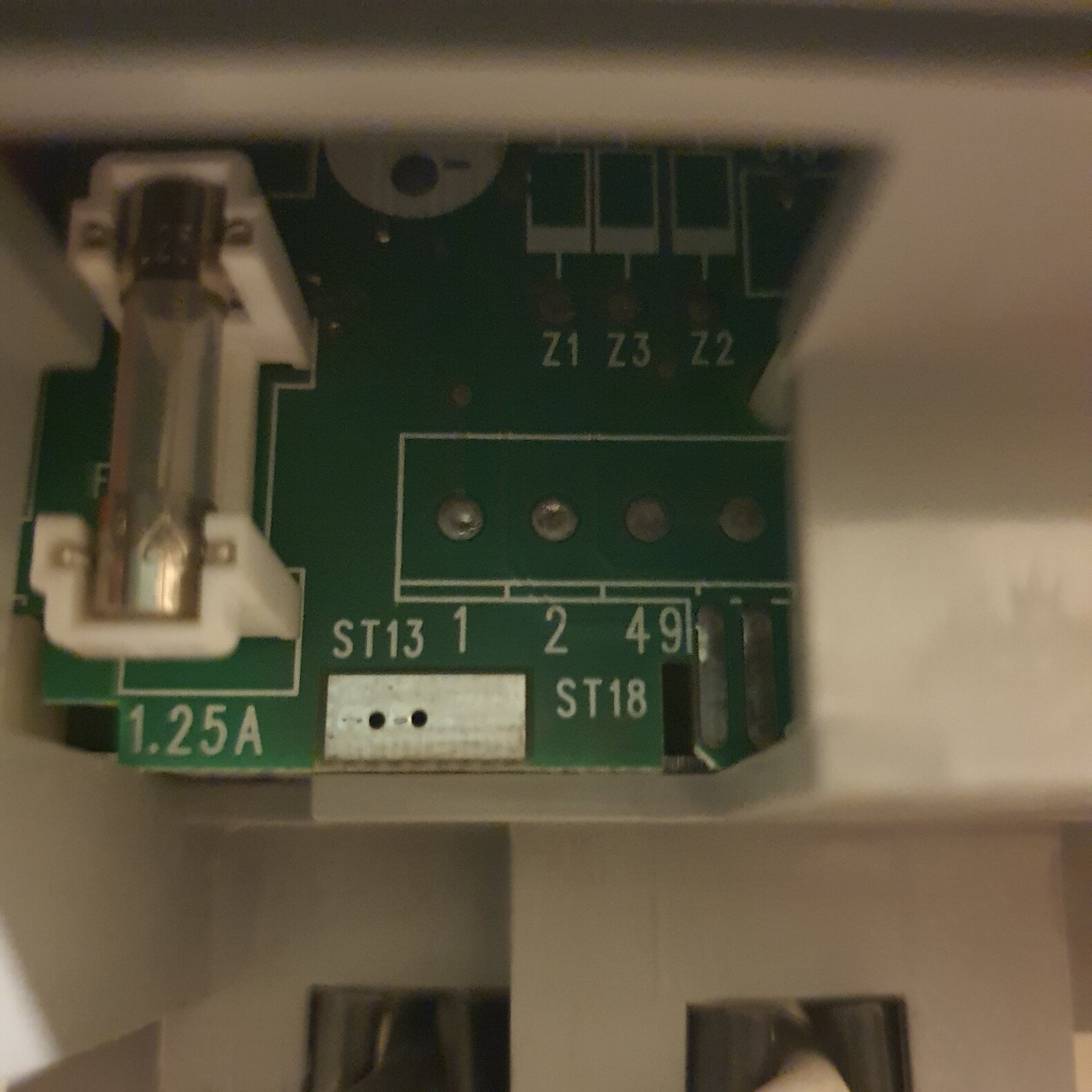

My first post so please be gentle. I have a Worcester 24 or 28CDI. Trying to connect a Nest Gen 3 Pro Thermostat. ST8 is mains so as I beleiev the Nest is 24v I would
attach to St13, No11 in the pic. But my boiler only has PCB solder point and no connecter as per the picture. Wondering if I can solder direct or not? And I think it would be the first two solder points, but which is negative and live? Can't find anything on the web so hoping someone can help here.
Thanks in Advance.

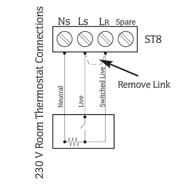

The Nest is quite happy to switch mains voltage (as long as you use the correct terminals!), so you would use the mains switching terminals (ST8) on your boiler.

I’m struggling to see where it’s a soldered point on the pcb.

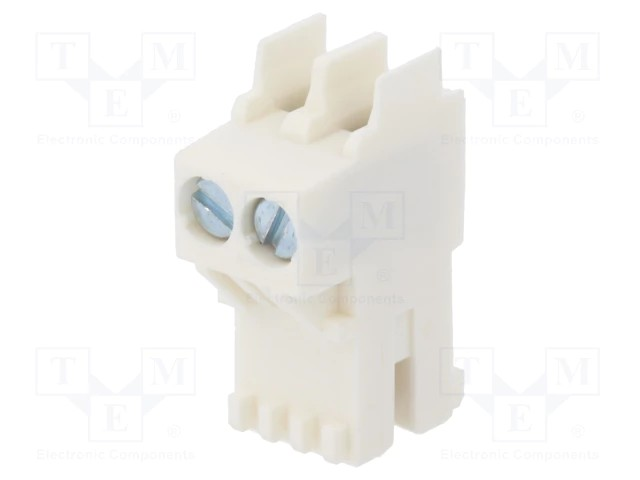

I'm not absolutely sure if this is the correct PCB, but if the 24V connection was supposed to be used on ST13...
then, there would be a dedicated board edge connector in place, something like...

It's old. 24 or 28CDI Worcester. connections in the pic I first posted, On the nest, terminal 2 and 3 to ST8 terminal 1 and 2 with the link removed

On the nest, terminal 2 and 3 to ST8 terminal 1 and 2 with the link removed. And the fuse that blew was on the pcb next to the mains wire in. 5x20 2A
You don't have an ST13 connection.
There are components missing on the PCB, that would relate to the 24V controls.
Even if you could solder wires on, the circuitry to respond to the call-to-heat is missing!
ST8 is the connector to use.
Ls and Lr (terminals 2 and 3) on boiler, to Nest terminals 2 and 3...

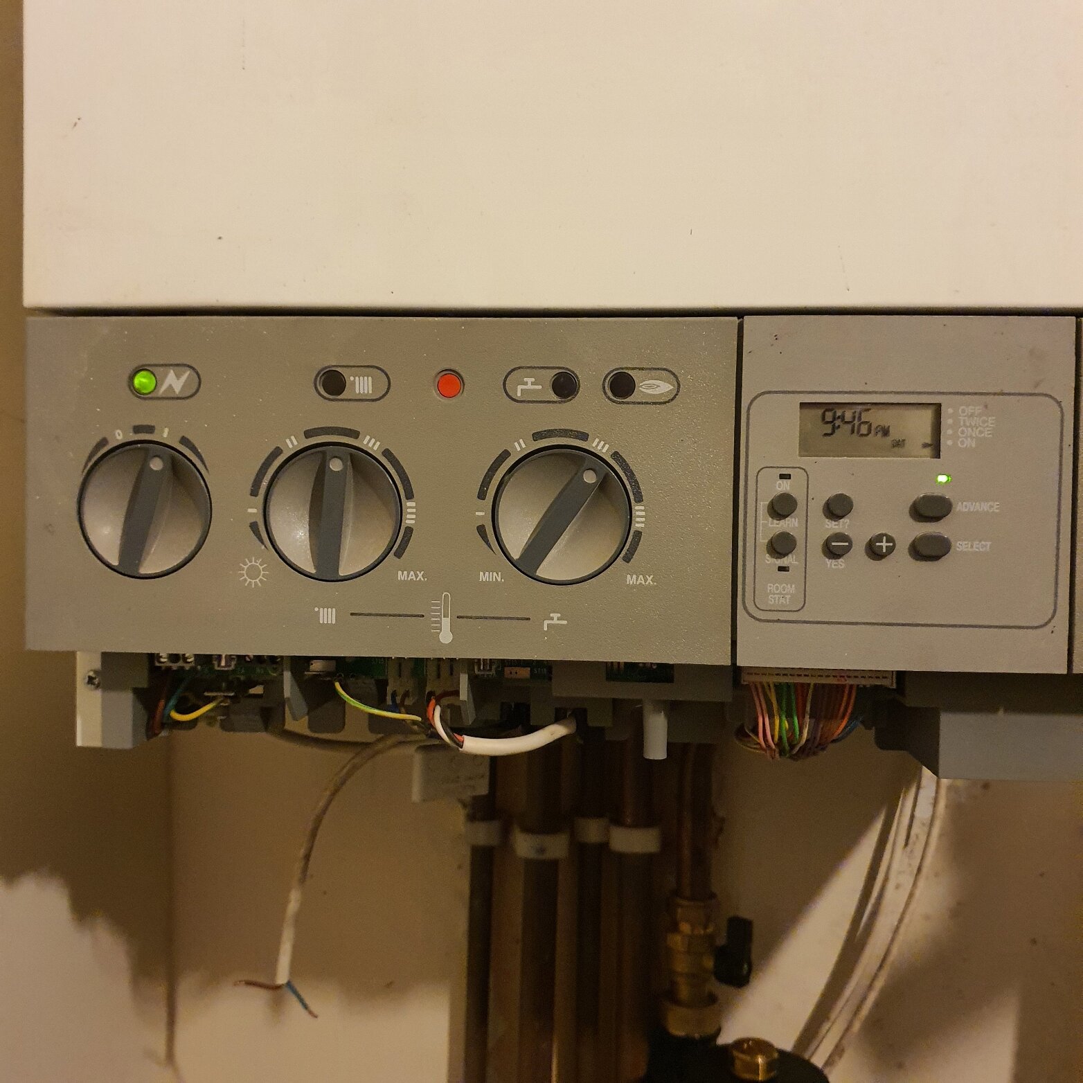

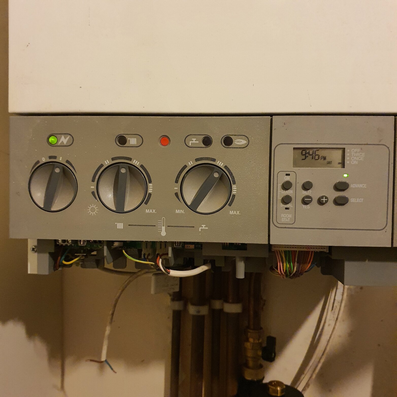

Well that has worked to a certain extent, fuse isn't blowing. But, heating is not coming on. Should I be setting the installed room stat on the boiler to something specific? Or disconect it? It's in the "on" mode at the moment
Any existing room thermostat should be set to maximum and the Nest will take over. If you wanted to disconnect that we can guide you through that too
Can you press the 'On' button on the "Room Stat' panel, and see if that provides an override? - I'm guessing the LED above the button should illuminate.
