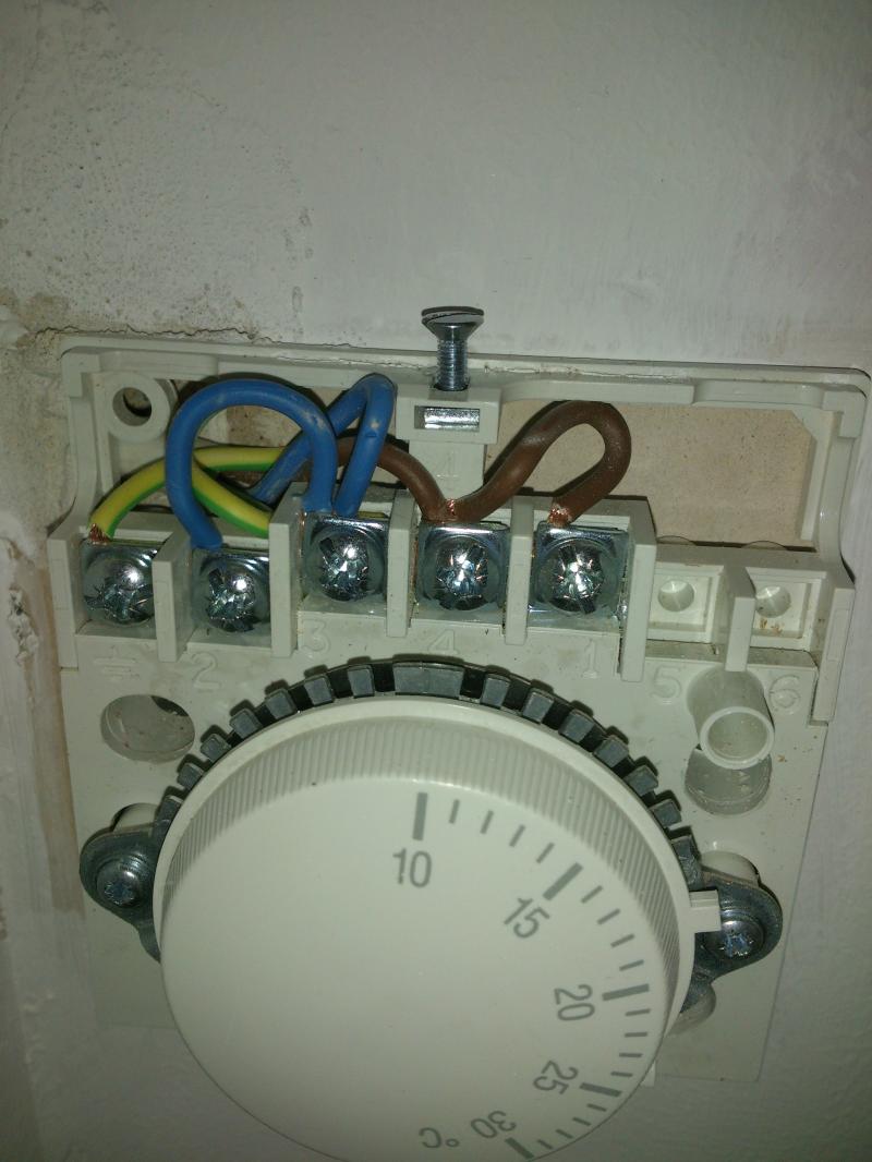

Hi all,
We had a builder friend (friend of my dads) complete some work on our new house when we moved in. Most of the work was completed but he only partly completed connecting a thermostat up to the combi boiler before suddenly becoming too busy to come back!
I've tried taking a look myself and reading up the instructions on the Honeywell and Bosch manuals, and have got part of the way there, but just want to make sure everything is ok.
Boiler: Worcester Bosch 28i - http://www.worcester-bosch.co.uk/ca...instructions-for-28i--discontinued-nov-05.pdf
TS wiring instructions on page 12
Thermostat: Honeywell T6360B - http://www.honeywelluk.com/Documents/Installation-Guide/pdf/1151.pdf
I've attached some pictures.
The first picture (T6360B-01) shows how the builder left the connections at the stat. The other end of the cable was not connected to the boiler.
The second picture (T6360B-02) shows what i changed the stat connections to.
The third picture (T6360B-03) is the wiring example inside the TS cover.
Currently, the thermostat is not connected to the boiler. I did temporarily connect it (using the connections as per further down), and it seemed to work in manually controlling the boiler and firing the heating on, but I wasn't sure if it was fully correct.
Some other comments:
1 - The builder has used a 2 core plus earth cable. It seems like I needed a 3 core plus earth. I guess to be able to wire in the anticipator on the thermostat and also for future proofing? The wiring has already been run across the house and through walls/under floorboards, so there isn't any way for me to change the cable now (carpets already laid in most of the house where the cable was run through).
2 - When i changed the connections (as the connections bythe builder made no sense to me when compared with the wiring diagram), i ended up shortening the brown wire such that it wouldn't reach terminal 1 for the stat. I temporarily swapped the use of the blue and brown wires so that i am using the blue as "Live". If i do connect the stat up to the boiler permanently I will be sleeving the wires so they now match what they are connected up as.
3 - When i connected the Stat to the boiler, it was like this:
Stat Term 1 - blue wire (as live) - to Boiler term RL (Live)
Stat Term 3 - brown wire (as switched live?) - to Boiler term RI (Switched Live)
Stat Term 2 - no connection
Stat Term earth - earth connection still connected - but not connected to anything on boiler (made safe)
I am able to control the heating using the Stat with this set up, but am I right in thinking that as I only have a Live/Switched Live connection, the boiler will be firing up and running based on its internal thermostat/heat control, and wont adjust according to the anticipator in the thermostat?
Is there a way I can get the anticipator working in the thermostat using a 2 core and earth cable? Is that what the builder had been trying to do with his original wiring set up?
Or could i potentially use the earth cable as the neutral between Stat term 2 and boiler term RN? The Boiler it self is well earthed and has its fuse right by it.
