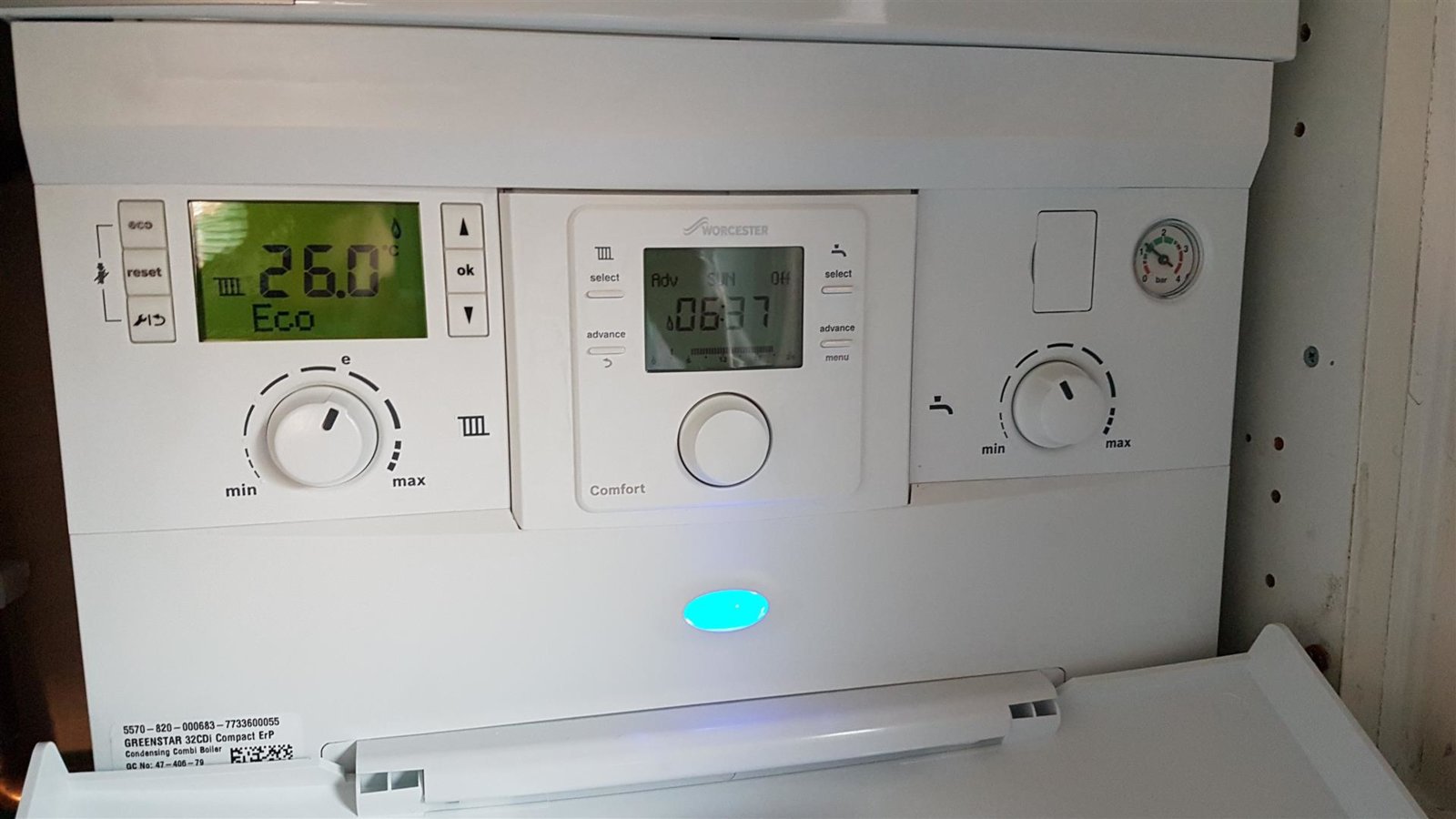

We had Worcester Bosch boiler fitted last year and so far so good. The only thing I miss about our 20 year old Glowworm boiler with its recurring self destructing PCB capacitor issue was the Drayton LP722 programmer that was mounted on the wall beneath it. The programmer was great, battery backup, a dizzying array of options, a boost 1/2/3 hour function and most useful of all accessible.
The new boiler is in a kitchen cupboard so to access the control panel you have to open the cupboard door and then the flap on the boiler. First world problems I know but is there anything out there to make it more user friendly, as with this varying weather just popping the heating on outside of programmed time windows is a faff?
I’ve had a Google but the only things that seem to come up are these silly Nest/Hive/Wave things which connect my boiler to the internet. Lo and behold it may be the next best thing since the wheel/sliced bread but I simply don’t care.
Is there a remote panel available from WB or anyone else that can just act as either a remote additional panel so the control panel is accessible or alternatively an extension box/wiring kit to relocate the panel from the boiler to a wall?
Any advice appreciated.
Stanski

@ericmark means well but his answer to your post is completely irrelevant , if you want the correct advice you need to post your boiler model and set up
Sorry, it's a Greenstar 32CDI
I wasn't specifically after another 722 controller, it's just the functionality of the controller on the boiler seems bacward compared to the much older 722 unit. The main gripe is the fact it's physicaly on the front of the boiler and not out in the open where it is freely accessible.
Just post a pic of the control panel of your boiler, its like pulling teeth, if we dont know what you already have how can we advise you
Here's the front of the boiler:
Not a remote panel as such as your existing "panel" as you call it does a lot more than just turn the boiler on and off, but if you want any external control be it wired or RF or internet controlled then yes you can have anything you want
