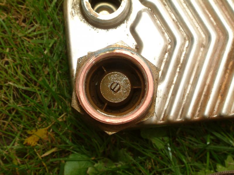

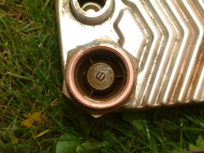

Replaced the vessel and things did improve, but still seem to have water flow through the heatstore/plate exchanger when CH is in demand. Once again pipes either side of the pump are only warm not hot so diverter valve can be ruled out.
Think I have sussed it though looking at the plate exchanger that sits on top of the heatstore. That plate exchanger has a one way valve that I think has turned into two way. This would explain the behaviour I'm getting with CH hot water flowing through the plate exchanger, heat store and related pipework.
I'll update again once fitted. Picture attached is of the plate exchanger that another guy posted when he had a different issue. It shows the check valve.
