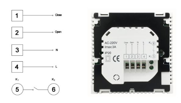

When you get it, if the wiring terminals look like this:
Then the wiring is:
Remove the wire link between boiler terminals 2 & 3
Boiler terminal 2 connects to L (thermostat terminal 4)
Boiler terminal 3 connects to 'Open' (thermostat terminal 2)
Boiler terminal 6 connects to 'N' (thermostat terminal 3)

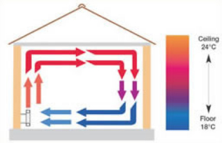

Be very careful when selecting where to site the room thermostat. Get it wrong and you will regret installing it.
Mine is very poor in its location with two doors between the wall thermostat and hall radiator, and two doors and a stair case on the other side. circulation.jpg this can't really happen with my house, there are 6 radiators all able to send heat to centre of the house where the wall thermostat is located, it really needs moving to the living room, but on my to do list. Leaving a door open or closed, will affect the wall thermostat, so even with the algorithms of the Nest learning thermostat it can't learn as always changing.
However in most homes there is some compromise, be it morning sun shine, opening doors, or other factors there is no perfect location, I have stated entrance level with not outside doors, the only room which would fit that is the toilet/shower room, and that is not suitable for thermostat anyway, every room has doors to outside. And living room is south facing so morning sun can cause the temperature to sore.
In real terms my boiler may cycle, but the thermostat stays on for quite a long time, moving from 17°C eco to 20°C comfort in the morning takes some 2½ hours, if I let it do it in one hit, it would over shoot, so I go from 17°C to 19°C then raise it 0.5°C an hour to 20.5°C so it takes 4 hours to heat hall, it however does not take 4 hours to heat the other rooms, so dinning room, kitchen and living room have all reached temperature set within an hour of change, the stepped change in hall stops hall over shooting as it takes so long for the heat from radiator to reach the wall thermostat.
So main point is time, and set a radiator TRV at 20°C and a room thermostat at 20°C and since the room thermostat is mounted higher than the TRV and it is some distance away the room will heat to 19°C rapidly, then slow down getting the last 1°C as the TRV closes, but will still in the fullness of time reach the 20°C at the wall thermostat and turn off the boiler, however because the last 1°C was slow to be achieved, one every other room in house will have had the time required to heat up, and two the room with wall thermostat will not over shoot to any great degree so boiler will restart sooner so reducing the hysteresis.
Then the wiring is:
As you have purchased a programmable thermostat, that includes both time and temperature control, the existing heating time control at the boiler will need to be set to have the central heating permanently 'on'. But don't panic, that will allow the new thermostat to take over control.

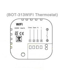

The rear of the one I have ordered is the same as the one you pictured.
The instructions say to connect L and N to 220 voltage power, 5 and 6 to your gas boiler, 1 and 2 are thermal actuators, please do not connect them to your gas boiler.
My boiler is oil, and according to the FAQ's when I ordered, this thermostat will work with any boiler.
OK, thanks for the additional info. In that case:
Add a wire link between thermostat terminals 'L' and '6'
Boiler terminal 3 switched live connects to thermostat terminal '5'
Just realised the 5 and 6 are the other way around on the one I have, so I would need to Bridge L and 5 on the thermostat and connect boiler terminal 3 to 6?
I doesn't really matter terminals 5 & 6 are connected to either side of an on /off switch. When the thermostat is 'on' the two terminals are electrically joined together. Convention says that the terminal with the 'switch contact' attached, as per the below is used as the live, but it will work either way around.
