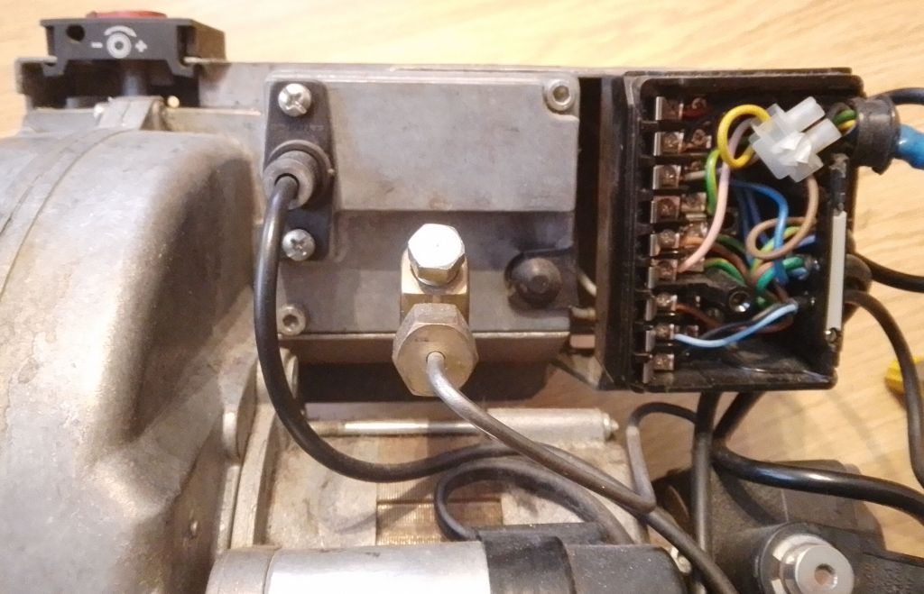

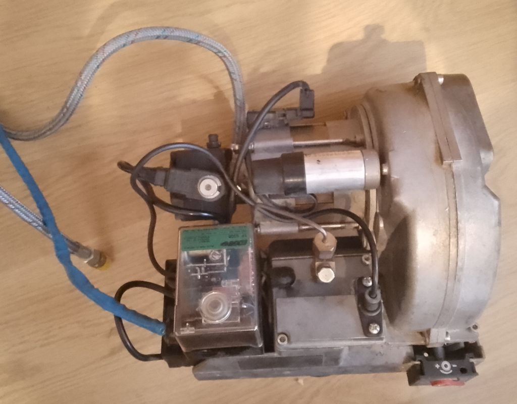

Sorry, this weekend didn't quite work out as planned, with my dad getting taken into hospital! However, I did manage to swap the complete burner assembly. Obviously, this hasn't fixed the problem, but as I had a spare assembly, it means I can still keep the house warm and I can work on the other assembly at my leisure.

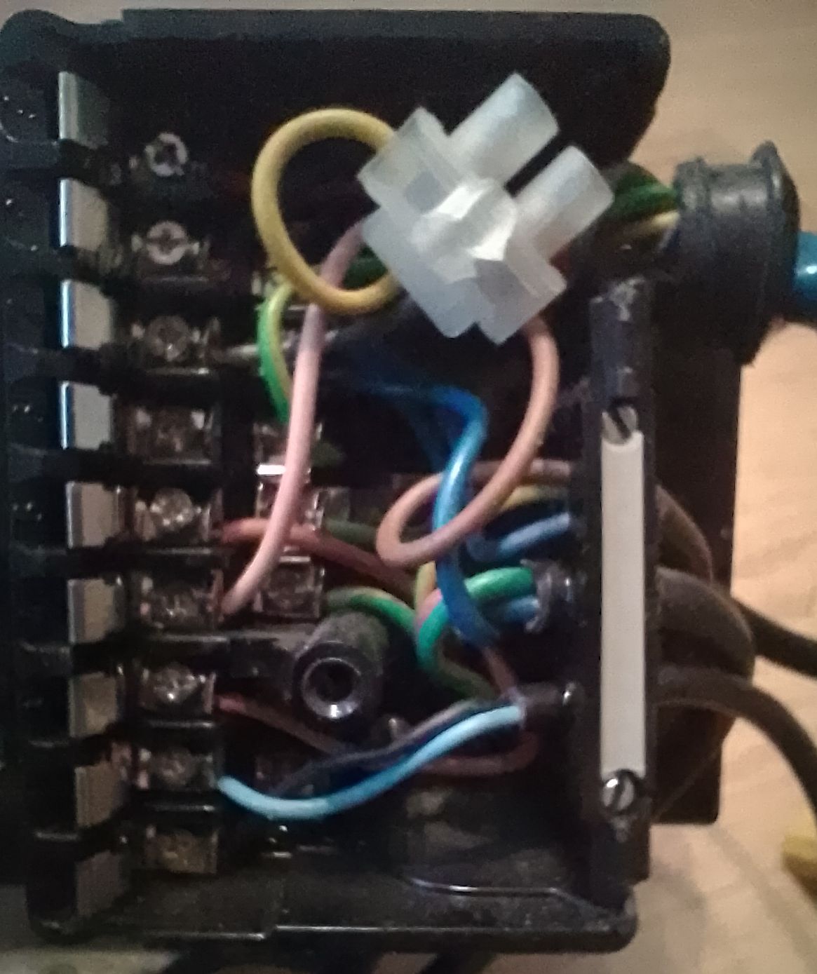

The connector right t the top of the photo is, I assume, the power to the motor. (There's another wise coming from the motor but it just goes to the motor's own capacitor).
Sorry, not a great photo. Will try to get a better one, but that's the Satronic control unit off.
Again, I'll try with a better camera.

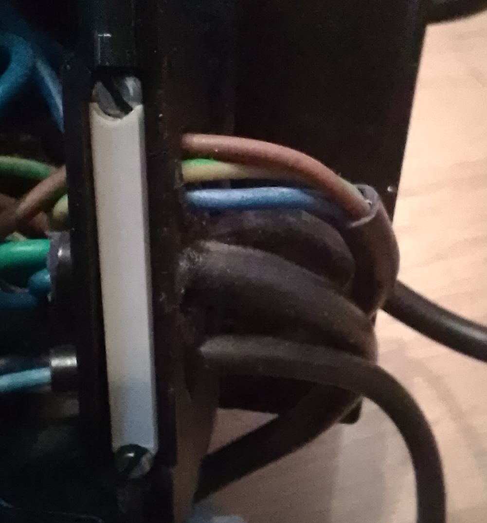

The three wires from the motor coming into the junction box, are the standard blue, brown and yellow / green.
That's as far as I've got up to now!

as both Terry and I have both said, if the problem is with the post purge unit, then changing the burner will not saolve the fan running on problem. You need to feed the motor live feed direct from terminal 4, and disconnect the ppu conections and make them safe.
Yes I know. This just allows me to keep the boiler running (it's quite cold up here!) while I do that on the other burner.
