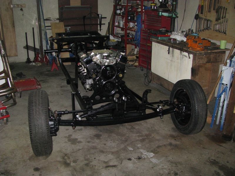

My latest project, built the chassis, suspension etc and such from the ground up, and there is a 'glass body to go on it.
This is my current 'workshop', about 8' by 12'. Not many cats get swung around in there when the car is inside.

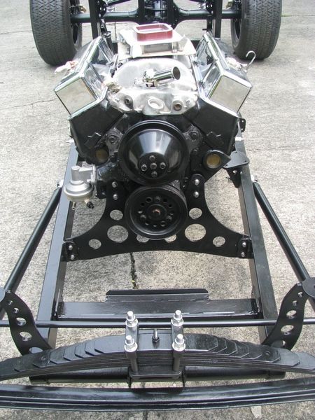

The front axle is 1930 Model A Ford, the front discs are Mitsubishi L300, modified and bracketed to fit by moi.
The motor is 5.7 litre Chevy from a 1970's Camaro and the rear axle is from a 1960's Mustang.
The rest is all handmade by me, chassis, brackets, suspension included. :D
The body is a replica 1928 Model A Ford pickup.
This was what I started with, plus some doors.
:cool:
fantastic job keep it up :D :D
the very simple suspension was giving me the clues to the age you where aiming to be authentic too ;)
