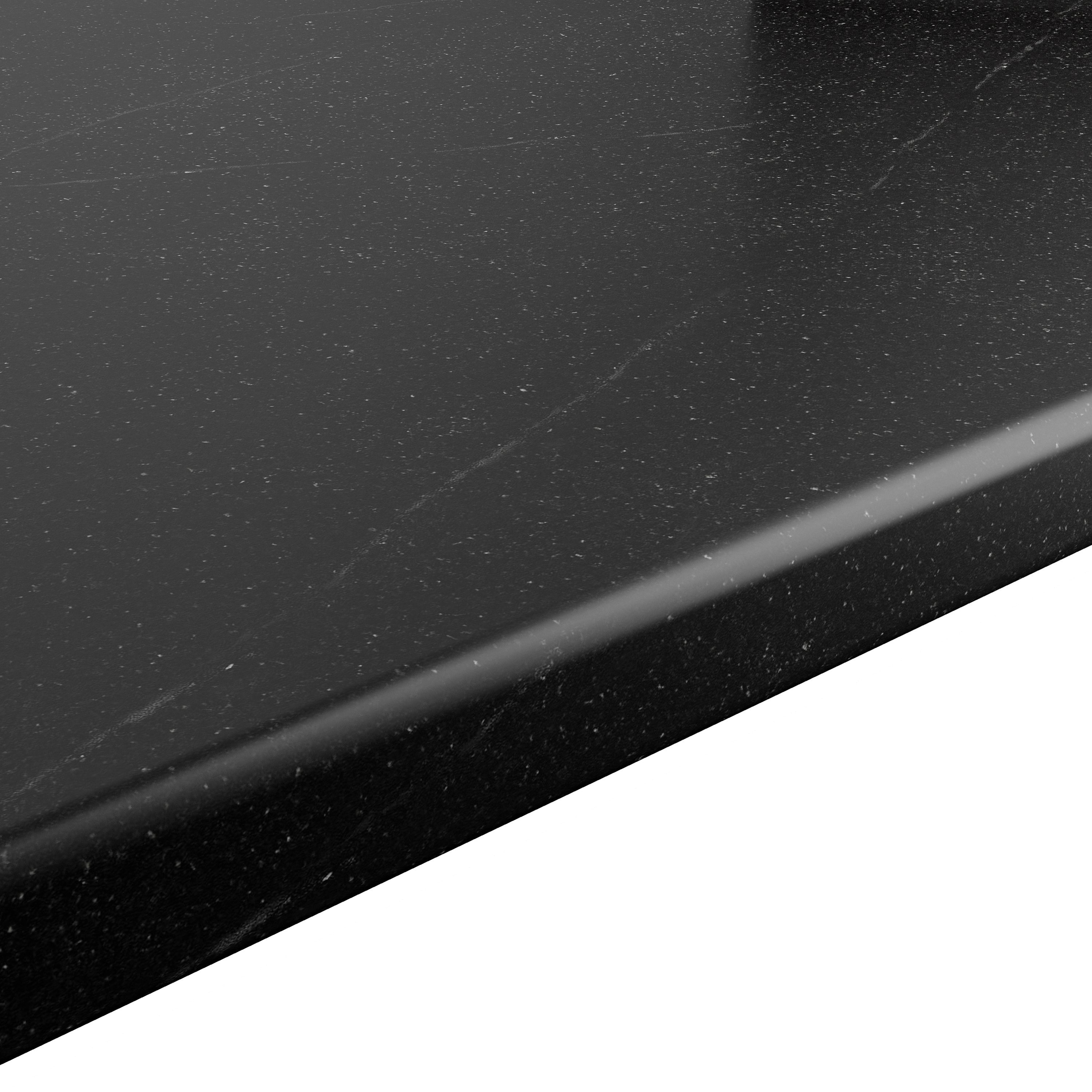

Don't know yet, though I assume that they are square edged. Pleased to report that I'm going there today to do the job with a jigsaw and worktop edging strips.Is it not a square edge worktop? Not seen rolled edge for a few years.
My local b@q only have square edge.
Yes you can.They definitely still sell them.
Dark grey Stone effect Laminate Post-formed edge Kitchen Worktop, (L)2400mm (T)28mm
This dark grey stone effect worktop is designed to be functional and easy to maintain. There are a wide range of options to suit your style and home, they also compliment the GoodHome doors and accessories that are available, making it easier than ever to create your own individual space.www.diy.com
Regardless, even with square edge laminate, you can not butt them up together.
Yes you can.
Yes , so it’s possible .Ok, yeah you can butt up square edge laminate, but it will stick out like a sore thumb.
Where the front face meets the top edge, there is a chamfer. You need to remove the front face laminate over the section where the two boards meet.

Should never assume .Indeed it is but any DIYer reading your initial post is likely to assume that you were suggesting that you could just remove the polythene covering and butt them up.
Any advice can be misinterpreted, I am not responsible for other peoples errors .Blimey mate. We are here to help DIYers. Why would you knowingly provide advice that could reasonably be interpreted incorrectly? If anyone follows your advice and it goes wrong, are they at fault for assuming that you were giving them good advice?
Had you said that square edge worktops can be butted up but only if one removes the front face laminate, I would have done the "thumbs up". You didn't do that though. You let the DIYers believe that you can butt up the two up, without explaining the extra steps required.
