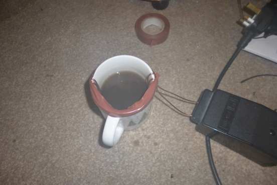

Just a update, In a impromptu fashion I tried sticking two bits of 0.75mm² copper wire spaced about half an inch apart in a glass of water what were in turn connected directly to the mains via a UK plug. Nothing happened other than the copper wires oxidising with small bubbles forming what happened rather quickly; I suspect the water did not heat up because I did not have differing materials for the electrodes.
Hardly an activity I would advocate!! However, if you wanted more to 'happen', you could try adding a pinch of salt (or almost anything else which dissolves)!
Kind Regards, John

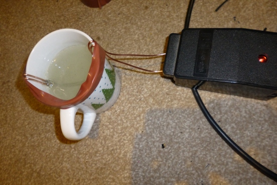

I just did it with normal (soft water here) tap water and copper wire. It boiled fast but copper is not good for the electrodes as it turned the water a horrid green/black colour!
I have a vague memory of conducting a similar experiment years ago. As best as I can remember now, my electrodes were just a couple of stripped lengths of 2.5 sq. mm copper cable, probably about 3 or 4 inches in length and held in a beaker of water an inch or two apart. I remember by the time I'd finished adding salt, the current (240V AC applied) was getting up somewhere around 10A.
Why would different materials make the water heat up?
Because doesn't the differing materials affect the electrode potential. Been a long time since I was at school .... Although I could and am likely completely off track and may be thinking about power generating sources like Lead acid batteries.
Yes, you're a fair way off-track - what you are doing today has not really got anything much to do with electrochemical reactions - you're simply passing an electric current (from an external supply) through the resistance/impedance represented by the water (well, a dilute solution of electrolytes).
Whilst, for your present purpose, it doesn't matter whether the electrodes are of the same or different materials, you'd do much better with something (like gold or platinum) which, unlike copper, was sufficiently inert not to get involved in reactions and/or develop surface coatings.

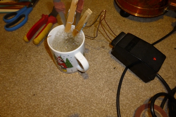

I just did it again with stainless steel spoons and the result was much cleaner this time!
Yes, I should have mentioned stainless steel (a lot cheaper than gold or platinum :) ), which ought not to be too bad.
Kind Regards, John
I take it this is not how you like your brew of tea then? :LOL: Is it copper oxide in the water??
Doh! - That makes sense, I did notice that I was only drawing 20 watts of power and that the half inch of copper exposed on each wire quickly oxidised. I live in a very hard water area, and had very little copper exposed in my tests. I knew that impedance through the water should generate the heat in principle, just I dumbly wondered if electrolysis and electrochemical reactions would have had any part to play as well.
