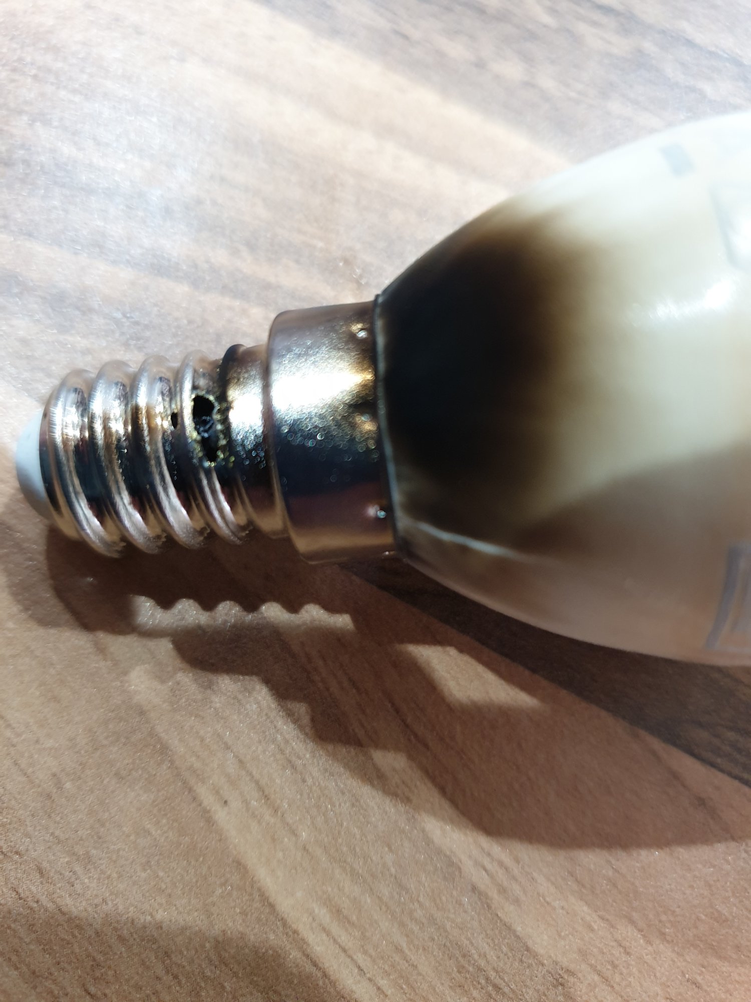

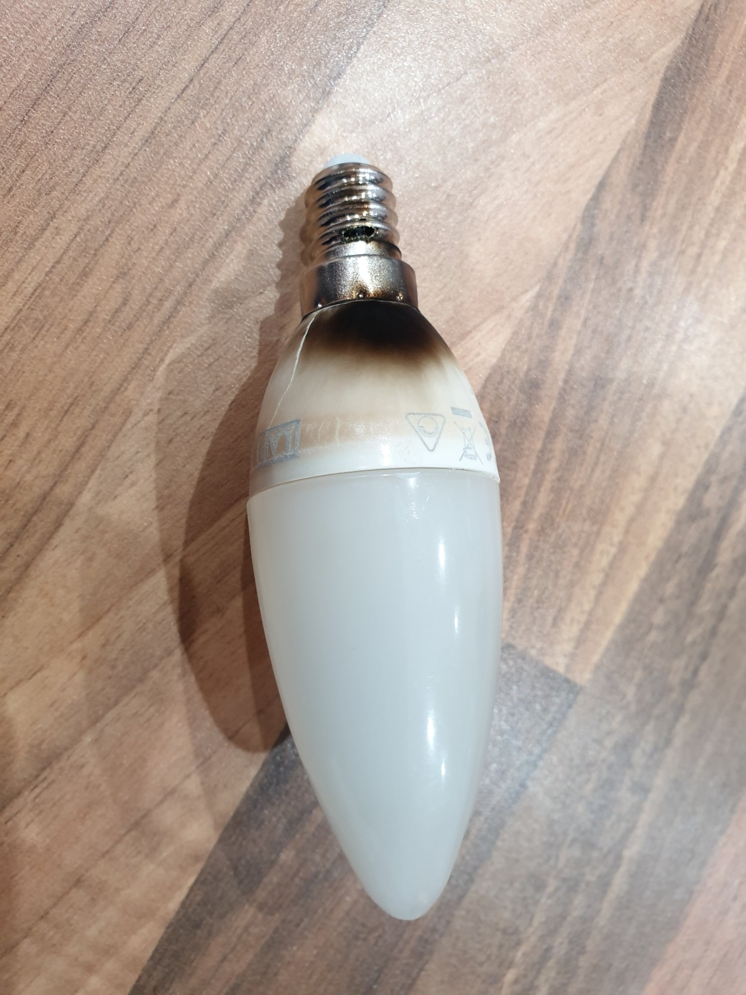

I've had a bulb blow on me today which isn't unusual. However, it is the manner in which it has happened that seems worrying. The fixture is a ceiling light that has five bulbs in it. They are all 6W LED bulbs. One of them today suddenly popped, tripped the fuse and a small cloud of smoke could be seen. The bulb had a burning smell and looks like the pictures below. Is this normal as over never experienced it before or is it a sign of something more concerning?

I don't know about 'normal', but I've certainly experienced similar. They sometimes go 'bang' and the plastic envelope comes flying off (exposing live parts).

Not at all unusual. Inside the metal cap there is an LED driver. This is a printed circuit board with a few components fitted to it. When one of these fails the PCB can be scorched or ( as in your case ) burnt before the fuse blows.

In my experience, it is often the 'fuse' (commonly just a flimsy bit of exposed foil) 'blowing' which appears to have caused the bang, the blackening and the smoke.
