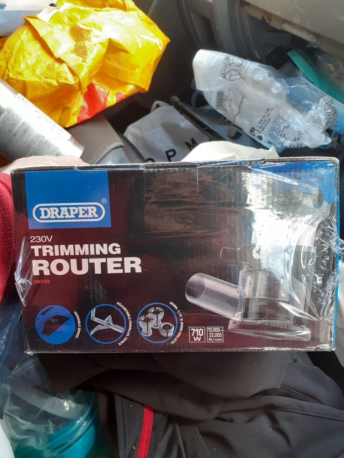

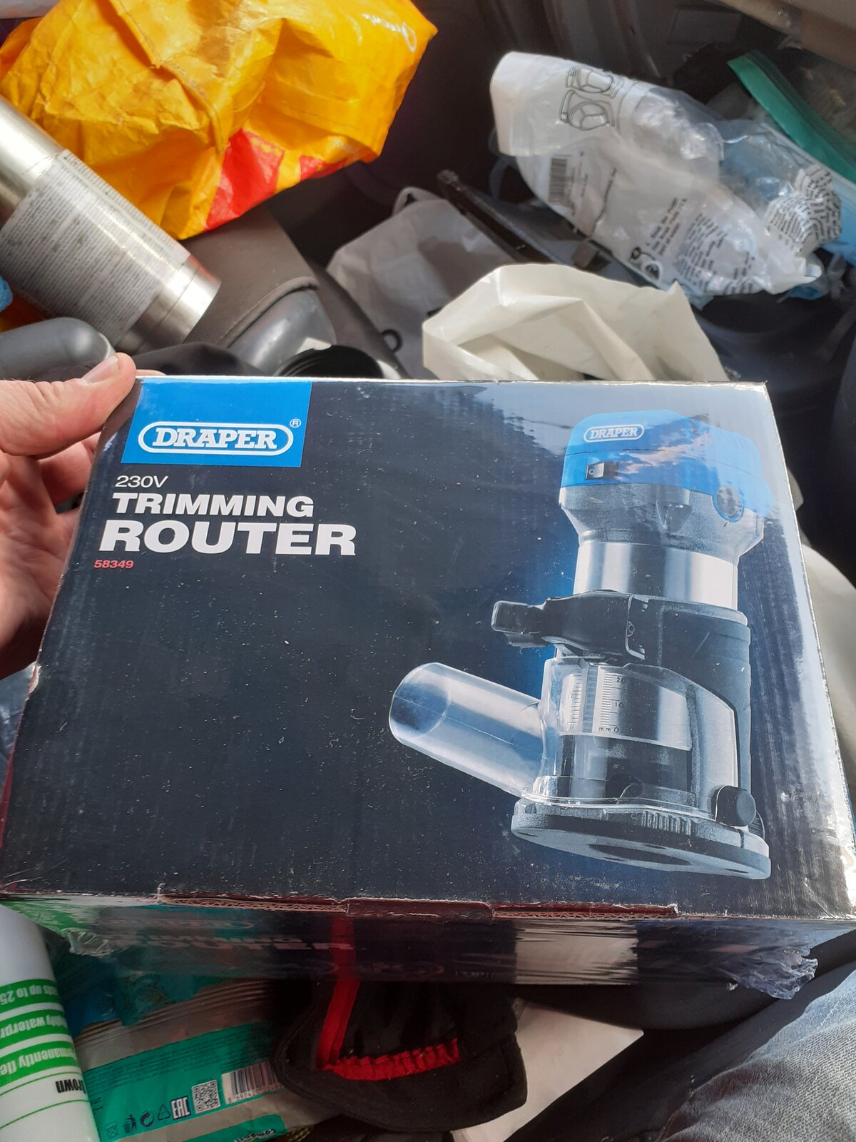

Ok. I've decided to buy this -£65. I can still take it back. I just couldn't afford £300 at the moment. I really need cordless but I guess I'll have to make do

The Draper model you have there is a bit more expensive than the one from AIM, which comes in at £28.99 with the fixed base. Go for a set with fixed, plunge and tilt bases and it will be £61.99. Surely this makes the Draper look dear
