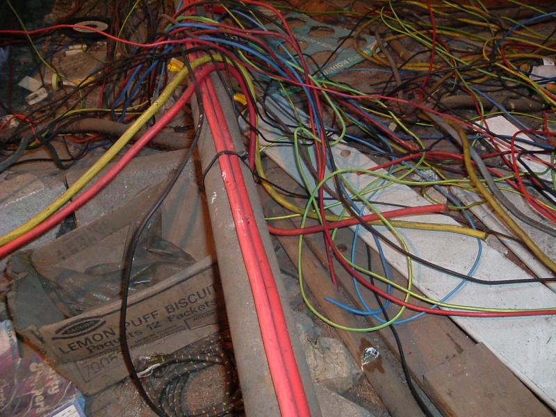

A few years ago I was asked to have a look at some wiring for a local market. A stall holder had lost his supply and could I check it out.
Here's a little of what I found. Prepare to be amazed! :eek:
No's 1 & 2,
Nice and tidy?

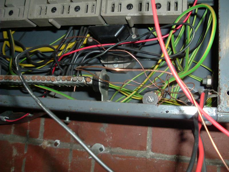

At least there are a few spare ways!
Well some of the earths are covered! ;)

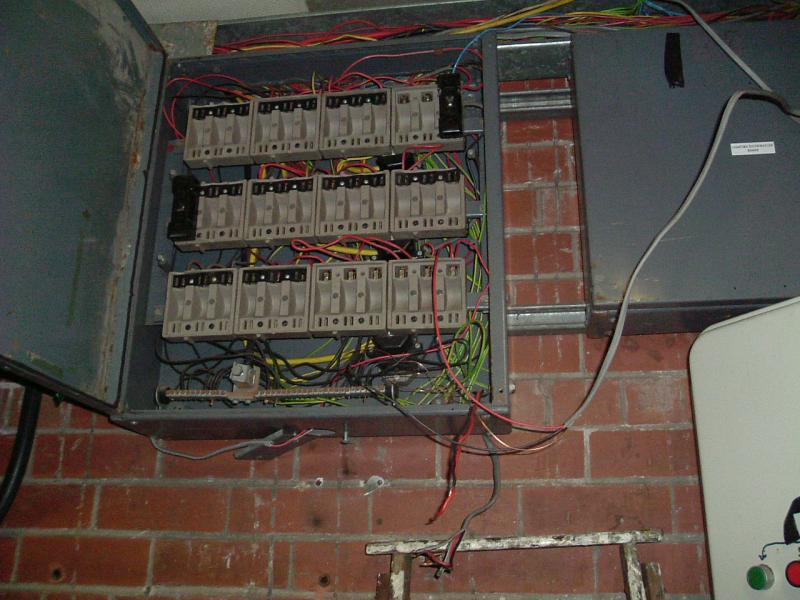

Nice secure terminations :?:

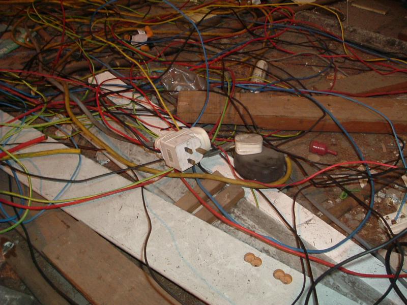

This was supplying 2x4 gang extentions! :eek:

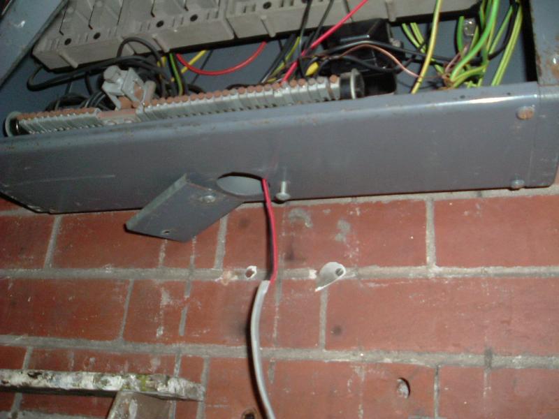

Ooops! forgot the grommet! :LOL: :LOL:
I shut down 7 stalls that day and was not very popular when I turned up un-announced 2 weeks later with 2 'Heavies' to virtually close down the entire market and discovered 4 meter by passes!
Those that were left open were safe and legal but less than a year later the place burnt down after being petrol bombed by an irate ex-stall holder who had been turfed out after my little visit.
