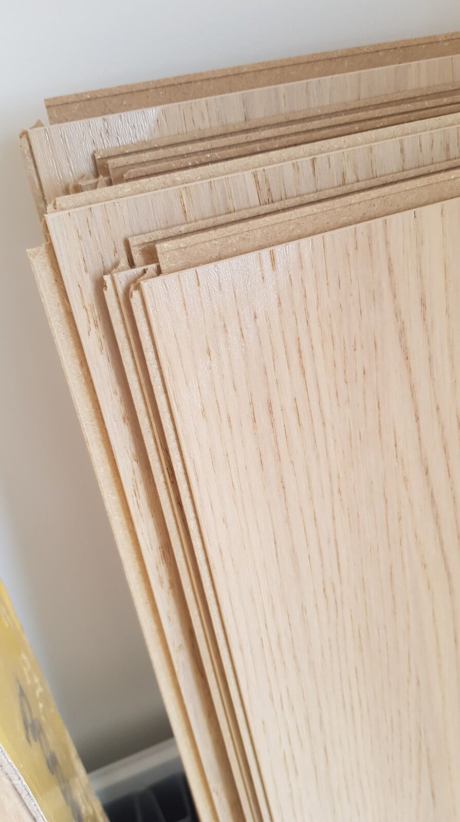

Had this flooring installed. It's basically rubbish, chipping, marking etc. after two weeks. It was advertised as engineered wood by the company I bought it from. People have now told me it is not engineered wood due to it's composition. I knew it was thinner than good quality engineered wood but bought it because it was cheaper and thought I was getting a compromise between a high quality engineered wood and laminate. However, I would have been better off with laminate as this isn't going to last longer than a few months.
Has it been falsely advertised as engineered wood?
- Dimensions: 1203 x 190 mm
- Thickness: 7.2 mm
- Top layer: 0.6 mm
- Click system: Uniclic
- Finishing: Brushed
https://www.par-ky.com/en/collection/oaks/milk-oak/
Looks like laminate to me.
Mdf in the middle.
Engineered wood is made up of lots of pieces of wood glued together.
The website clearly states it's not engineered wood. (It claims to be better for green purposes)
If a retailer sold this as engineered wood, your argument is with them.
Would you still call it laminate even though the top layer is real wood, despite it being so thin?
I think their argument is going to be that laminate is synthetic but the top layer of this is real wood. But it's obviously not engineered as they have described it either.
Only sweeping it and walking on it in thick socks is exactly what I've been doing. It's terrible. I don't know what to do. I'm writing a complaint to the company but unlikely it's going to help. I feel it's been falsely advertised by them.
Your link to the uk supplier calls it engineered wood.
Your link to the manufacturer says it isn't
I would call Trading Standards and have a chat.
Any argument is with the supplier not the maker.
