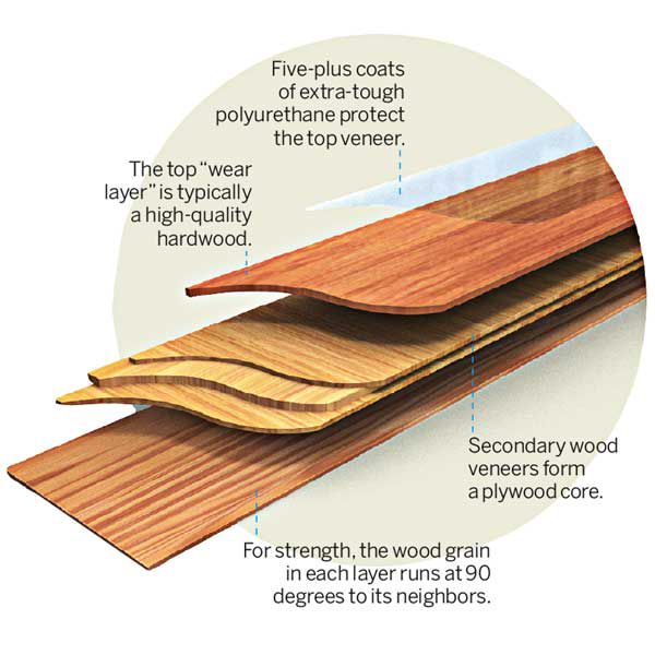

That would be made of lots of pieces of wood glued together and a veneer finish on top.
They haven't lied in their website, I think you misunderstood.
Maybe you're think of wooden flooring constructed like the picture below?
