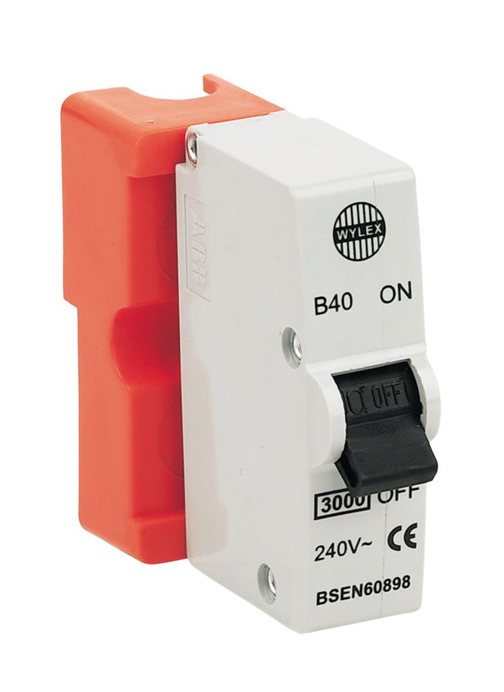

Hi.
The MCB on my shower has started to trip. The shower has been installed for years with no problems. When I checked the MCB I noticed it was a 30A. The shower is 8.5kW the cable is 6mm.
Now with further investigation I have discovered that the MCB is a type 2 (Wylex) so replacing with a 40A is not straightforward as with the more modern consumer units.
Are the MCB's replaceable without dismantling the consumer unit.
I am asking cos it looks like a longer job than plugging in a new 40 unit.
Steve

The fact the existing MCB is a type 2 doesn't really matter - although they are not made any more, newer types can probably be fitted instead.
There are many varieties of Wylex consumer units and MCBs, a picture of it would be helpful.
It is likely the MCB is a plug in type like this
ae235
as to if you can replace with this
ae235
depends on how the cable is run. 6mm² thermoplastic insulated and sheathed flat cable with protective conductor Reference Method C* (Clipped direct) is 47A however Reference Method 103# (in a stud wall with thermal insulation with cable not touching the inner wall surface) is just 23.5A so it is not as simple as saying 6mm² cable is rated X amps. In the main we consider it is good for 34A i.e. Reference Method 100# (above a plasterboard ceiling covered by thermal insulation not exceeding 100 mm in thickness) but there is no simple answer until inspected.
However simply replacing with a B32 will likely mean it will run for another good few years. Although the shower will be an overload what is important is the MCB trips before the wiring gets too hot and because the B32 will trip before wires get too hot even if technically overloaded it is still safe. This may not be the case if you change to a 40A.
Although in my house the two old fuse boxes now with MCB's fitted are protected by two RCD's that is not normal with old fuse boxes. In the main a RCD will need adding.
It is likely the MCB is a plug in type like this {.....} as to if you can replace with this {.....} depends on how the cable is run.
And on whether it's a Wylex board which will accept an MCB rated over 30/32A. Some have only one slot for >30/32A, some are 30/32A max. in any position.

Up to 30/32A there's no problem, but the coded base for higher ratings has a restricting lug and will fit only in positions designated for those higher ratings.
Up to 30/32A there's no problem, but the coded base for higher ratings has a restricting lug and will fit correctly only in positions designated for those higher ratings.

Those MCBs do not plug in.
If you can find a 40A Type 2, or a B40 which is compatible, I'm pretty sure (but welcome to be corrected) that that CU would support it.
But then there are these issues:
1) What is the current carrying capacity of the cable given its size and installation method?
2) Testing.

I agree, you cannot just upgrade a protective device without first checking all of those items.
My other concern would be the capability of the (63A rated) RCD. I see that current for all of the circuits, with the exception of the lighting, is through that one RCD.
Looks like three x 6mm², two ring finals plus immersion heater (?), all on 63A RCD.
Yes, but it was OK'd when we bought the house five years ago so it may be 'on the edge'.
My original question though was .....it it easy to replace the 30A MCB with a 40A. It looks like you have to remove the bottom busbar but there don't appear to be any screw and it looks to be all in one piece. Or do you have to unscrew all the lower MCB connectors
