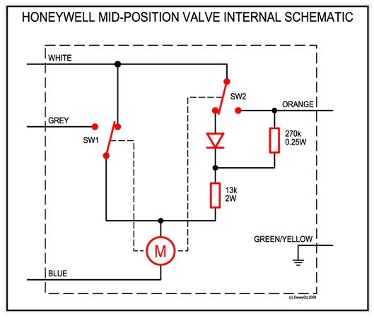

Hi all I have the above issue, I have a hive active system with a worcester 18ri.
The problem is I am getting very low voltage coming from the orange wire from the 3 port valve approx 90v! this is when the heating only is selected and the hot water is satisfied. the boiler still appears to fire up and the pump runs. the pump is switched from the boiler as it overruns. about a month ago the cylinder thermostat was replaced. I can't help thinking its been miswired, the cylinder stat has a short piece of 3 core flex which goes to the wiring centre (brown,blue and Green & yellow)

It may be the 3 port valve is faulty, the orange wire is 90v I can't get it to change, this is when the grey and the white both have 240v (heating only), so I don't understand why there is only 90v coming from the orange and not 240v?
The reading of 90 volts is almost certainly a false reading due to capacitively induced voltages on the orange wire. The orange wire is in the same cable as wires that have 230 volts AC on them and this will induce voltages on wires in the cable.
If you measure the voltage with a low impedance volt meter ( such as one with a moving needle ) then the voltage would be very much lower.
The induced 90 volts suggests that both ends of the orange wire are open circuit ( un-connected ).

It is odd that a reading of 90volts can be found on the Orange wire as one end of it is ( should be ) connected to the boiler and/or pump. Either of those should provide a path to Neutral with an impedance low enought sink any induced voltage to 0v (relative to Neutral )
Stuart how exactly are you measuring the 90 volts ? Obviously one meter probe is on the Orange wire but where you putting the other probe ?
Thanks to John Ward and Geoff Drage the mystery is solved. The sneak circuit in the valve across the terminals of the micro switch SW2 putting half wave rectified AC onto one end of the Orange wire and a control input ( high impedance ) at the other end of the Orange wire. So yes 90 volts on the Orange wire is possible.
