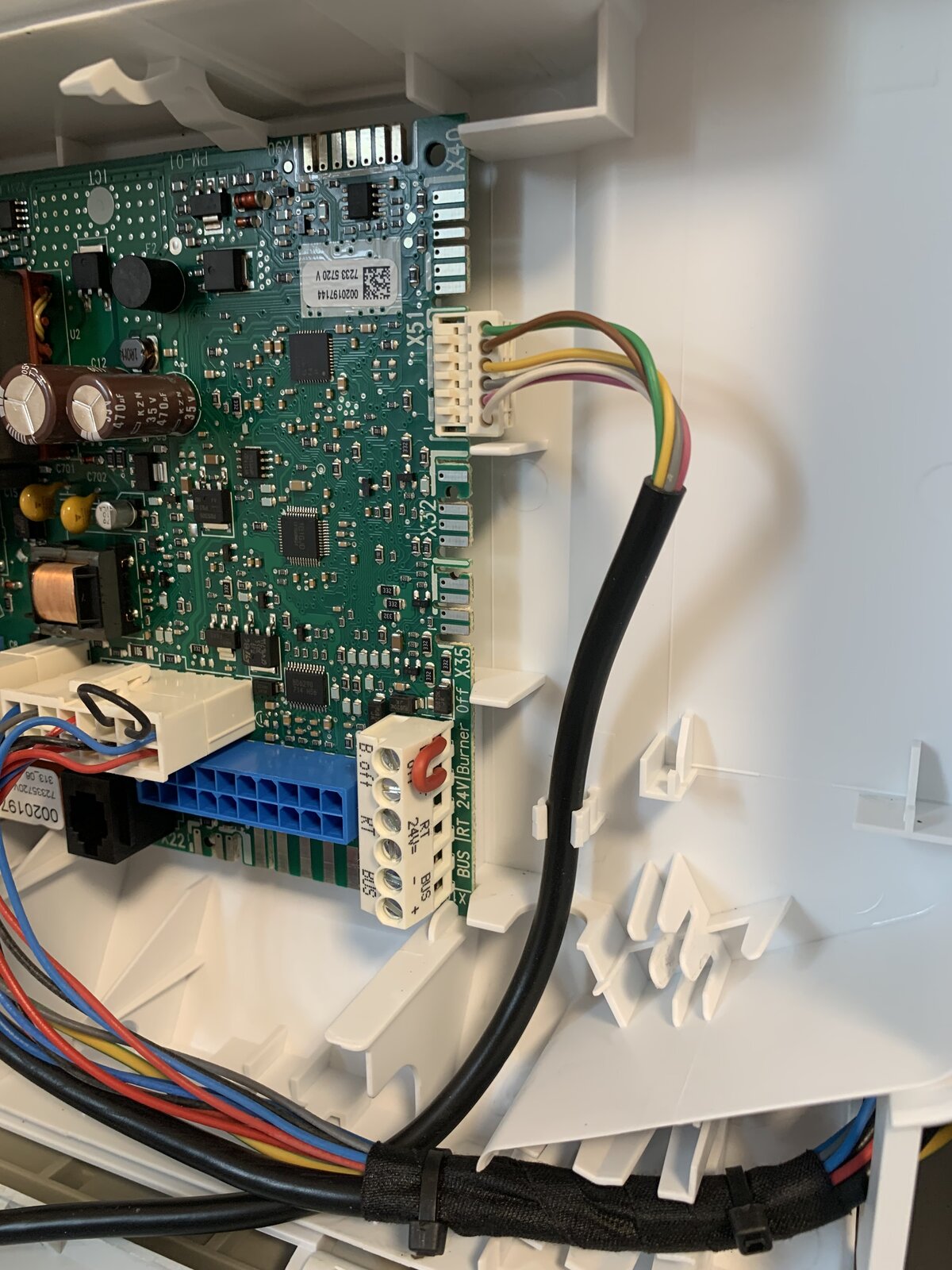

Y plan heating with vaillant eco tech boiler and nest link
Yep

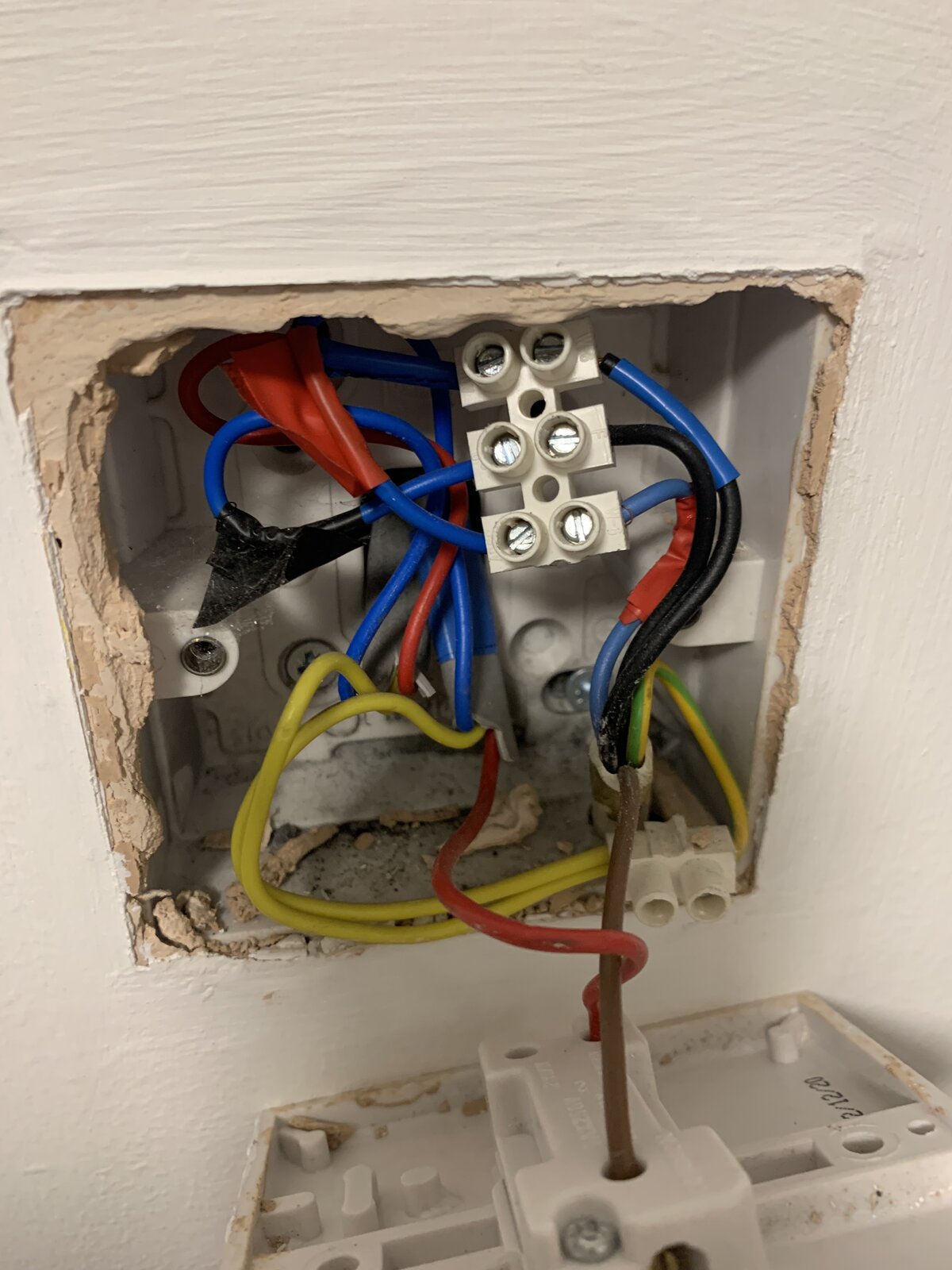

That’s the cables from the wiring centre to a simple light switch on the wall adjacent to the boiler
Then the 5 core to the boiler
I’ve just edited my message above

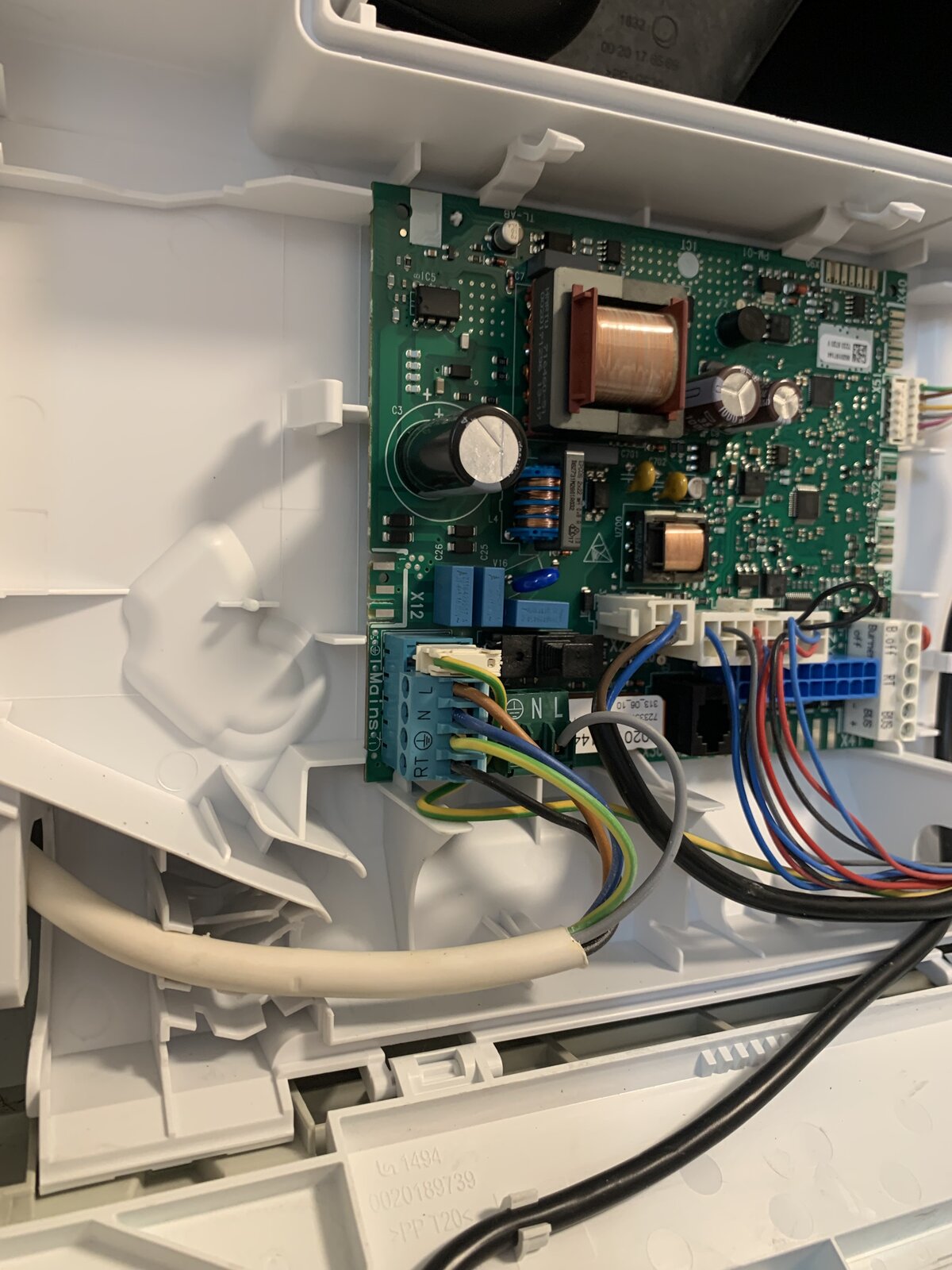

After the discovery of the cables going to the boiler with just the live being switched
I decided to open up the boiler to see how these cables were connected and was there a link left in??
After seeing the set up (see attached photos) I’m beginning to think it may well be the three port valve resistors or motor??
No link was left in. Either motorised valve failure or wiring fault, probably the former.
Thanks for your support
Need to go back to the original plan and change the valve and sort out the wiring centre
