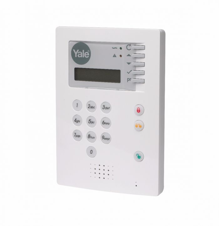

Hi
We have a Yale alarm that we fitted ourselves we have had it in for 2 years now without any problems but 2 days ago it started randomly beeping (this is not the fault beep as I have heard this before when batteries needed changing) This is louder and there doesn’t seem to be any pattern to it the keypad freezes and you cant do anything until the beeping stops. The fault light is not lit and there is nothing on the fault log has anyone got any ideas of how to stop the beeping as it is very irritating.
you're going to have to tell us what model it is. A photo of this handset would be useful.
How old is the battery?
Hello, can you please tell me whether your issue was rectified. My alarm, HSA6000 series, started beeping irratically yesterday and after a couple of hours of pulling my hair out, it returned to normal. Everything was fine today until about 8:00pm, then it started again, beeping constantly but there is nothing showing on the fault log. The keypad also froze for a short while. Any advice would be appreciated.

None of the posters is willing to say what model they have or provide a photo.

If you can, view the fault log and note any entries before clearing them. It might bleep if the power supply or the phone line go dead.
If there is nothing on the fault log and the buttons stop working, it looks like a panel fault. Do you know how old the internal standby battery is? Are you using a genuine Yale power supply unit?
You could take the panel off the wall (it will go into Tamper alarm) and put it in another part of the house, just in case there is an electronic device such as an internet wifi router or a phone interfering with it. I have never experienced that, with a number of Yales, but it is presumably possible.
You could also factory-reset the panel. Have you got the instructions? you will have to re-learn all the components afterwards.
You can buy an official replacement battery, but I've used one intended for radio-controlled model cars, because it was cheaper and had greater capacity. I had to make up a new connector though. I have not experienced the symptoms you describe from a poor battery, though.
Replacement HSA6400 panels are in great demand second hand because they can be used to upgrade the lower models of HSA alarm, and the dial-out phone capability is the key advantage.

Hi, I was wondering if you had any luck with the factory reset or getting in contact with Yale? Our unit started doing the same thing which was driving us crazy. I managed to get into the programming menu at one point and I could see that the unit thought the up button was being pressed (the menu was scrolling while I was looking at it but not touching). Occasionally I can get it to stop for a while by pressing that button vigorously a few times but it always comes back. I would love to find a fix for this.
If you have a sticky button, do you think something like tea or a soft drink was spilled on it? Or a lot of cigarette smoke?
I doubt it could be fixed without dismantling.
Though if it was mine I might try cleaning round the keys with a small paintbrush moistened with soft warm water and half a drop of Fairy, then sponged off.
