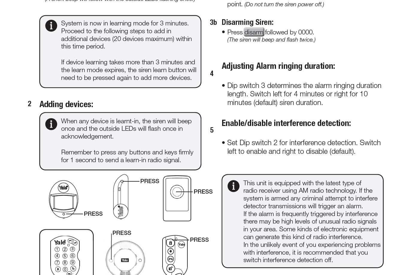

Radio transmitters and arc-welders have been mentioned as sources. It's possible for an electronics hobbyist or a burglar to generate interference, but we've never heard of a case where this was associated with a Yale break-in. Millionaire diamond collectors usually have better alarms, and teenage crackheads just use a brick. It's possible to turn off the interference detection, but much better to find the source.
from the Yake manual
The switch you need to turn off "interference detection" is in the siren. One of the progamming switches shown here.

Turning OFF "interference detection" is the same as turning OFF the tamper detection. Thus any jamming or blocking (malicious or accidental) that prevents the siren being triggered will not be detected.
And the latest type of radio receiver ? AM ( Amplitude Modulation ) was how radio signals were transmitted way back in the 1920's and before, AM is still used but it is far from "the latest"
Can I ask for a clarification on this. Does turning OFF the interference detection also permanently turn OFF the tamper detection on the whole alarm system (siren box and individual sensors)?
The tamper ( interference ) detector activates when the radio channel is blocked / jammed and the siren is unable to receive commands from the control panel.
The siren box is receive only, it cannot send messages to the control panel. Therefore when it detects that it is being blocked or jammed all it can do is sound an alarm.
When the tamper ( interference ) detector in the siren is disabled the panel will still have active tamper detection. The sensors are transmit only and therefor cannot detect if the radio channel is being blocked or jammed. The panel should be able to detect if the radio channel is being blocked or jammed. It could then create an alarm at the panel but if the radio channel is blocked then the panel cannot send a command to the siren.
Interference detection circuit in the siren has nothing to do with Tamper switches
Correct..... The tamper switch in the siren is the switch that detects that the box siren has been pulled off the wall or that the cover has been removed.
Interference detection circuit is part of the radio receiver system.
