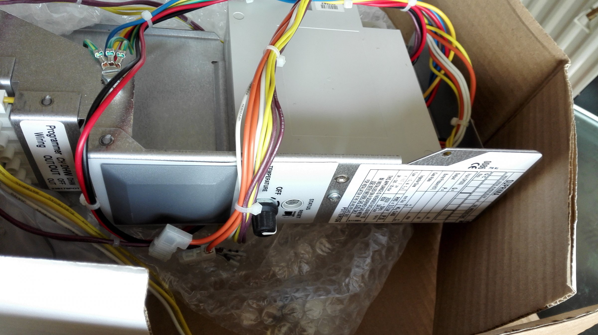

I have read possibly all the threads and blogs about the Suprima issues but can't find any that help with my current problem. It is a Suprima 70l with the new Siemens type PCB, and locks out with a solid red LED sometimes every few minutes, sometimes every few days. When the red LED comes on and you hold down the reset button for 10s I get the fault code of one flash orange, them 10 red flashes. I cannot find this fault code anywhere on the web. The boiler resets fine but the time it runs for without failing again seems competely random.Any help would be much appreciated.
I replaced the PCB in desperation a few weeks ago but the fault has remained. So same fault on two PCBs, the previous PCB was the original factory one.
Edit: having said that it is the original wiring loom etc. I just swapped the PCB, although I did receive a full wiring loom etc with the new board.

I think I need to rewind and explain a bit. The boiler has always had a new style siemens PCB with the plugs to the wiring loom.
The old system pump failed around Christmas and we had lots of boiler lock outs. A heating engineer replaced our pump and we were charged an arm and a leg for the pleasure of him ignoring phonecalls texts etc before coming round and replacing the pump after 6 weeks. We were told the system would continue to trip out for a while but would settle down. Well it hasn't, it is still faulting (as described previously) although now it is a different fault than before when the pump was on its last legs (flashing red- boiler lockout). Having read most of what I could find on faults with this boiler type, a continuous red LED was either a wiring fault (unlikely as my fault is intermittent) or a PCB fault. I then discovered if you hold the reset button for 10s it gives a fault code. I could not find this fault listed anywhere on the net so...... As a maintenance technician for many years who had worked on many control systems including industrial boilers, I thought I would give it a whirl and replace the PCB. The PCB comes complete with a new wiring harness, which I left in the box and just replaced the PCB assembly. The fault remained the same with the new PCB.
I now just want to know what the fault code means, if it is a boiler issue I will get I repaired by a heating engineer, I know not to mess with those as I have no test equipment to check its safety. BUT if it is an ancillary part to the system causing the issue, I would like to try and repair it myself and save my self the grief of finding a decent heating engineer who won't let me down and charge me handsomely for the 'privilege'.
You can only fit the new PCB to the new wiring harness.
So at some time after manufacture your boiler must have had the harness changed for the new type.
I recently replaced two Suprima gas valves and my charge was somewhat less than the figure above.
NB. The boiler was fitted brand new, in it was ALWAYS a new style PCB. I could only ever find people on the web saying that there was a fault in the PCB that was close to what I was experiencing. In know most of these related to the old style boards, but some people were mentioning the new boards were starting to fail as well, and mine is nine years old. I wanted to replace it with a NEW board not a refurbished one as I would always prefer new components to ones whose history I don't know. Anyway you can only buy a new boards as part of the kit for replacing the old style ones and it therefore comes with the full wiring harness. To replace my full wiring harness was a lot more work than replacing the PCB unit so I did that first (three or four screws, remove the knob, unplug, then do the reverse). Now it is done he fault remains, now I know it is not the PCB, it could be the harness(which I would replace myself) or it could be a fault with the gas/combustion/bits I won't touch part of the boiler. I don't want to get "a man in" until I know what is wrong with it so that I can repair it myself (only if safe to do so) or so that I know they are not trying to BS me as I've already forked out several hundred quid and been mucked about for weeks by the last "professional" gas safe engineer to touch it. (Also this Muppet had put the boiler back together incorrectly, the side section with the PCB has machine screws and self tappers, which he had in all the wrong holes).
