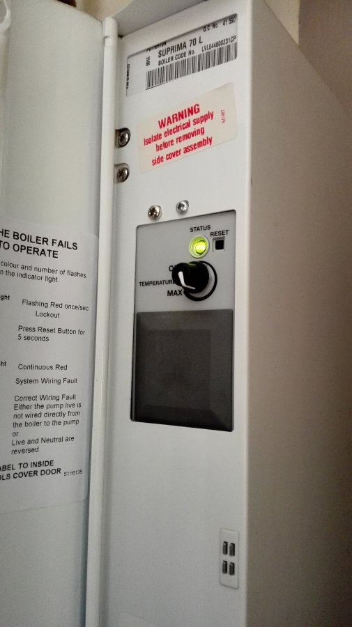

Right then, can we agree that my boiler was installed in 2006 ( it was around the birth of my second daughter, it was done in a hurry because of this and was a direct replacement for the one that was in before, no doubt to keep installation to a minimum). As far as I know it has not had its PCB replaced before I did it a couple of weeks ago, but it is possible it was done as part of an issue when the gas valve was replaced.
All these things are moot though. I only want to know what is wrong with the boiler/system now, and how to progress. If you would like me to test some stuff I can do so, I may even have a contact thermometer lying around in the garage to check pipe temps if required. I have no problems checking out electrical systems etc, what I don't know is what to look for.
Any help in this matter is heat appreciated.
That is a distinct possibility as on that model it was sometimes found that a faulty gas valve would damage the original style of PCB.
Can you post a picture of the control panel of the boiler?

Thank you moderator, I was beginning to give up on this thread. Anyway please find attached a photo of my control panel, currently working for over 36 hrs but only lasted a couple before that. The HW is set on timer for twice a day, the CH is on all the time off a programmable thermostat.

Why does what PCB was in my boiler years ago matter. It is surely the PCB that is in it now that is relevant. I have posted a photo of the PCB I replaced, and a photo of the replacement, both if these are the newer style Siemens PCB. Both if these have shown the same 10 red flashes as a fault code, after my pump was replaced. It was a couple of weeks later that I first noticed the fault as it was tripping on lockout before that. The guy who installed the pump told us it would take a week or so for the system to "bed in" and it did. But after that the current fault manifested itself.
