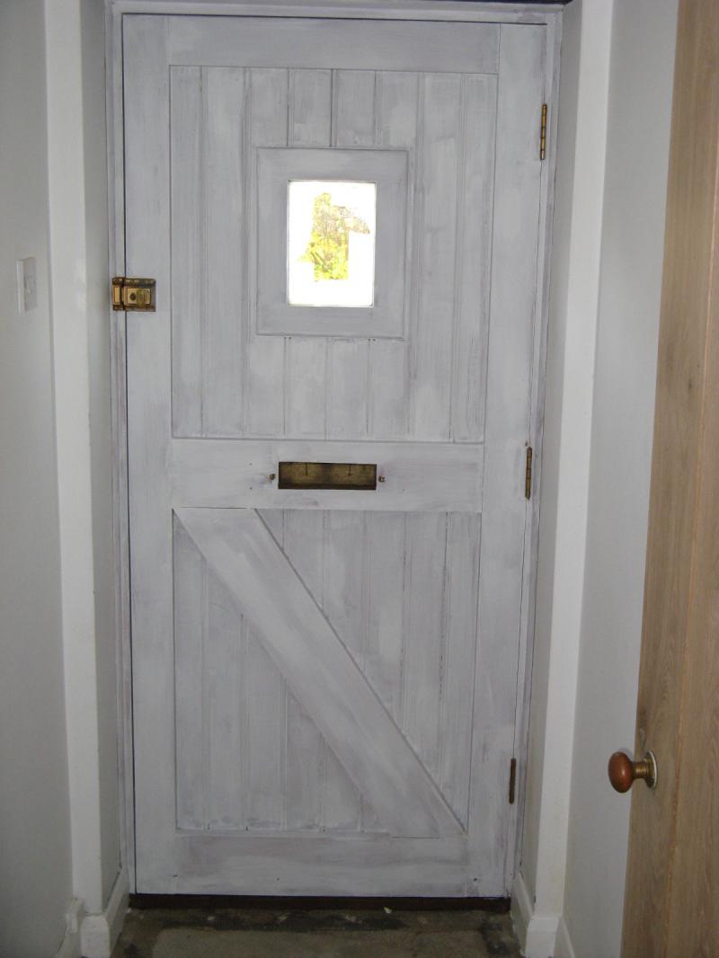

I used some Zinsser Bulls Eye 123 a few days ago, for the first time. I'll be using Sikkens Rubbol Satura BL as the top coat. (And I used Purdy brushes for the first time :D ). Got a few questions if anyone can help...?

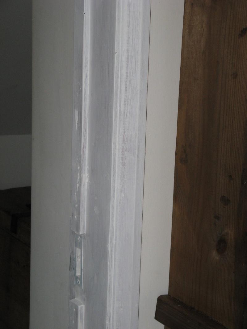

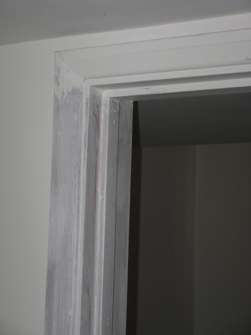

1. Did we put the primer on too thinly? Here's some photos:
In the last photo, the vertical piece was painted on the varnish (the previous paint had been removed), whereas the horizontal piece had the old satin paint beneath. So - did we apply too thinly?

You have to remember what primer is. Its not a decorative coat of paint, its job is to satisfy the porousity of the timber and provide a suitable surface for further paint products.
It is important to stir any paint before use as binder and pigment can seperate in the tin and in your kettle if used for a long time.
The primer doesn't look to thin and they can look a bit transparant sometimes because they're not really a high obliteration coating like undercoat is.
Yes its good to rub down between coats, a primer only needs a light sand to de nib and smooth down any raised grain.
Next step is filling, allow to dry, rub down and prime then two coats of satura.
