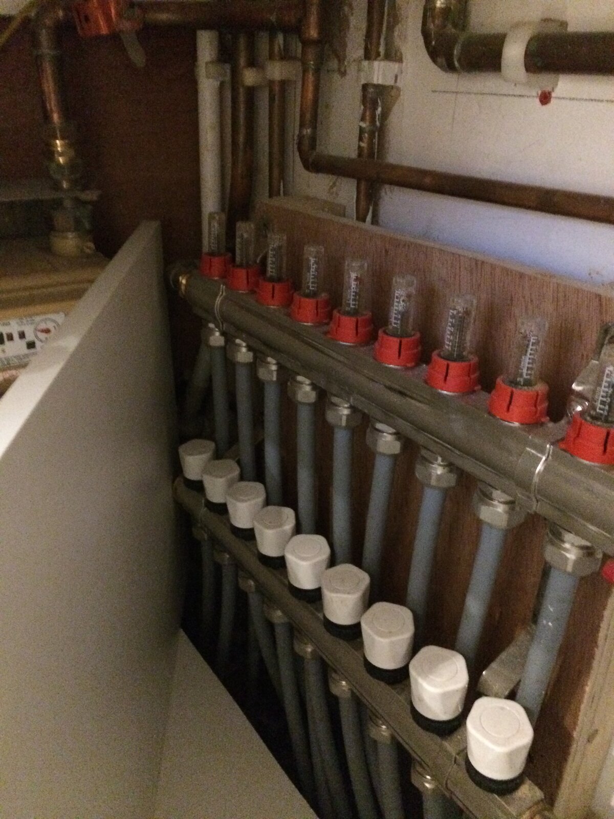

You dont need adaptors, here is a rad manifold that I installed
all done in 15mm pipe.

Picasso, Thanks for the info & picture. Is that 15mm multilayer or standard grey pipe? What size were the manifold ports you bought, 15 or 16?
For the 15mm pipe do you add the 15mm eurocones or 16mm cones? Most manifolds are 16mm but if using 15mm pipe i wasn't sure which you pick.
