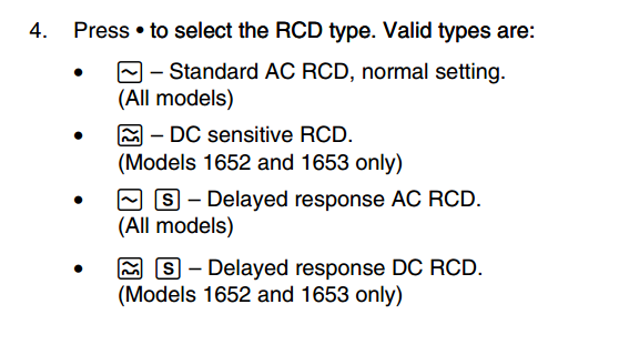

Having said that, the 1650s have settings for various RCDs.

Yes it's a 1653, I've only just got it. The later B models have a no trip test function for getting a Zs.
I'm just wondering how it differs to what I can do on mine so that I don't go round inadvertently tripping customers RCD while I go round getting a Zs.
