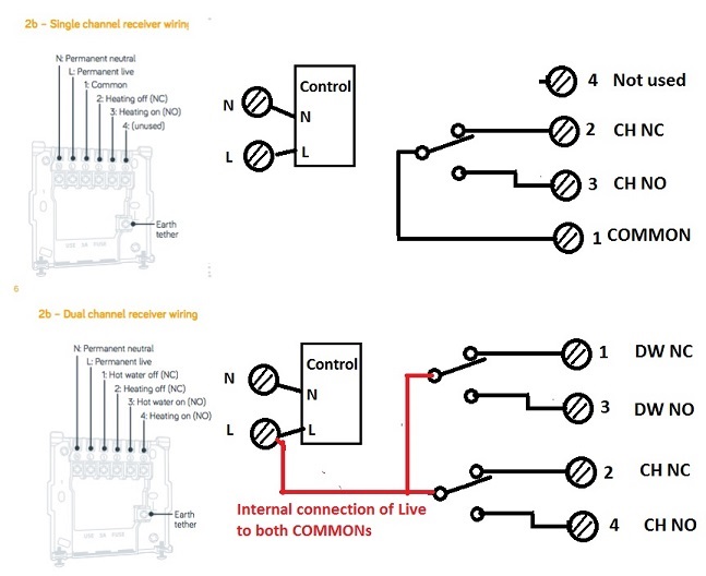

You cant install the dual channel hive with that wiring centre

This photo from a group on FB seems to have it working with the same wiring centre? Am I missing something? What do I need to get it set up and working?
Those are both single channel hives, the single channel has volt free switching , so can switch the 5Volts that the ESI wiring centre has, yours is a dual channel and can only switch 240V so cant be used, you can use a nest dual channel though

He has a duel channel hive and it cant be used as it only has 240 v switching
