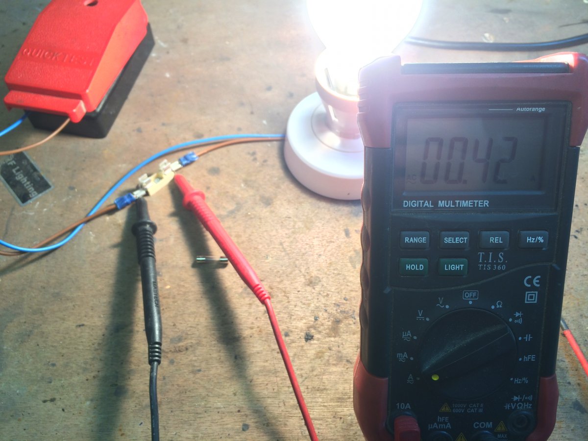

Following on from a recent rather bold statement I thought I'd do a little experiment for everyone here. I was quite surprised by the result.
Sadly your advice is misleading. Anyone fitting a 500 mA fuse (next size above 0.43 amp) for a 100 watt bulb would be confused when the switch on surge blew it every time.
Cool vid, was that a real 100W lamp?0 A few recent ones I tested were really nearer 60W!

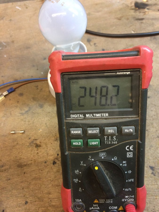

Never thought about that! Just done a couple more tests.
248.2 x 0.42 = 104.244W
I'd say that's pretty close!
It is what I would have expected, a fuse takes time to rupture so within that time the lamp will have reached temperature. I know my clamp on has a max/min reading, but no idea how quick it will react, so cold resistance is a better way to work out the maximum current while it warms up.

It's a 240v bulb as can be seen 15 seconds in on the video.
His mains is 248.2v not 230v as many would like to tell us.
Yes, Winston but his meter does not measure nominal voltage.
It wouldn't be a lot of good if it did, would it?
Do you have a multitude of tables for whatever the voltage is at the time when you are working?
I'm all for what some people may call pedantry but when you are actually wrong and just keeping on, it makes you look silly.
The abbreviation for voltage is a capital V because it is derived from someone's name.
And here I frequently measure between 230 and 238 Volts (and typically nearer the 230V end of the spectrum).
I wonder what Winston makes of that?
