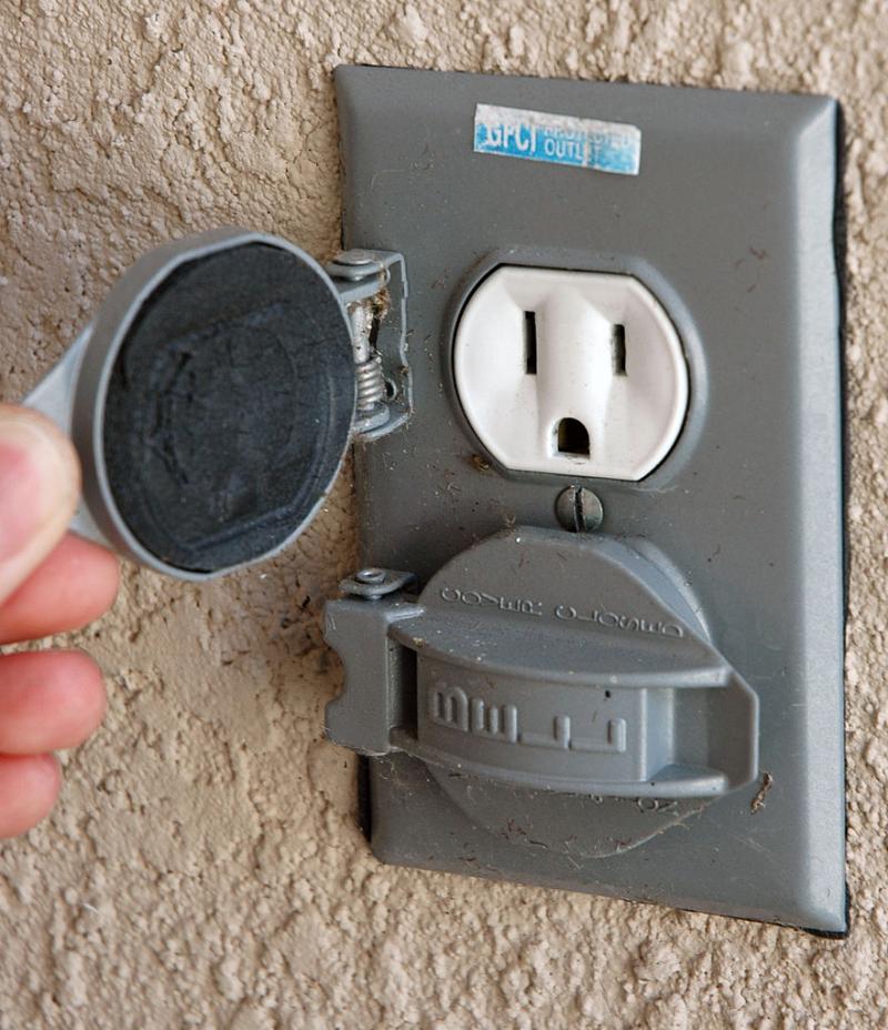

You might be interested to know that, in the US, there is no such thing as a ring main. All circuits are 20/15a radials (one for each room). Lights run in the imperial equivalent of 2.5mm cable on the same circuits as outlets. It is code to install two separate outlets in laundry areas. One for the dryer and one for the washer. Most non-gas dryers require a 30a dedicated hookup (like ovens). You're violating code if you plug both into the same outlet. Dishwashers and waste disposal units require dedicated lines. Also, there must be an outlet fitted on every wall 2ft or more in length. No floor area should be more than 6ft away from an outlet, and on continuous walls, outlets must be spaced 12ft apart. At least one outlet in each room should be switched from the wall (to plug in floor/table lamps). Outlets also REQUIRED outdoors and in bathrooms. No such thing as consumer unit RCD's or RCBO's. Only outlets in wet areas (kitchens, bathrooms, outdoors) require CGFI protection. In the UK, there seems to be no regulations about designing installations based on how people use things or to reduce likelihood of overload, trailing wires, extension cords e.t.c. (the things that actually cause fire and electrocution). One of my many gripes in life.

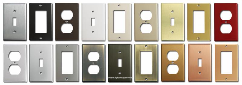

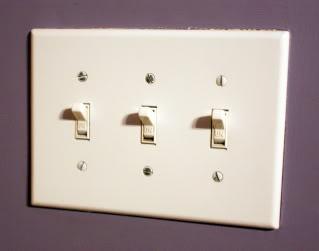

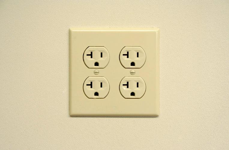

Another thing the UK is terrible with is having standard plug socket/switch plates. In the US, ALL plugs and switches are one standard modular design (like MK or Click modular). All plates are a repetition of the same vertical rectangle e.g. meaning you can combine plugs and switches on the same plate, combine different kinds of switches e.t.c. you can also choose different materials/styles of plate which all fit together with any switch/socket. You end up with things like 'quad' plates which are compact compared to two British double sockets and ideal for behind TV's or on kitchen counters. Switches repeat horizontally on the vertical rectangle plate too, so you can have as many switches as you want in a row instead of faffing around mounting separate square or horizontal switches as you would here in the UK. It's all very well thought out. I wish the UK had come up with similar standards a long time ago.

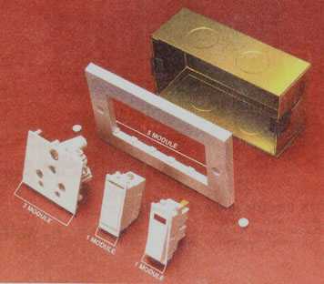

We also have a grid switch system were modules are used to build up sockets, switches and fuses with plates but it is more expensive than the all in one single, double and triple switch or single or double socket so not used so much.

Using the grid switch system which you like from USA you can have sockets, fuses, and switches all on the same plate.
Not saying I like them but clearly can be got.
