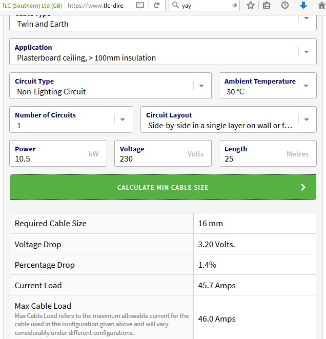

Yes of course:-

I'm not so sure about that - I doubt that length of the cable is often relevant. Even if one is concerned about voltage drop (and I personally don't see why one really needs to be, in the case of a shower circuit), as the figures Sunray posted illustrate, VD is not going to be the limiting factor. His figures, using a very unfavourable installation method, require 16mm² because of CCC considerations. The cable run could be more than three times greater than he postulated without even the regs' guidance on VD being exceeded.
