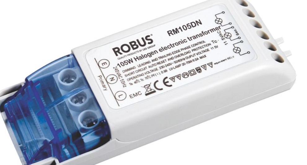

all I could discern were 3 output pairs, each one showing one lamp connected to it, and I thought "35-105VA"..... "3 x 35 = 105"..... "Probably no one output should have more than 35W on it".....
It now sounds as though he had 100W on one output anyway,

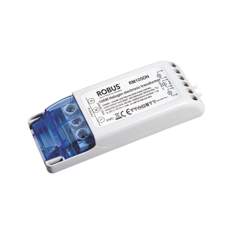

Thanks to both for the images. As observed, they don't clarify much.
Does it have other terminals on the LV side which we can't see? The blurb says "Large mains terminals for loop-in and loop-out, no need for a junction box" but I can't work out how just L/N/E does that.

Ah, hmmm... OK - an assumption too far. I couldn't find a good image - all I could discern were 3 output pairs, each one showing one lamp connected to it, and I thought "35-105VA"..... "3 x 35 = 105"..... "Probably no one output should have more than 35W on it"..... o_O
If so, what would be your assumption about the meaning of "20-70W max"?

In Iggifier's photo nothing on it agrees with "35 - 105".
I can't think of a more reasonable assumption than 20-70W per output, total ≤ 105W, and possibly total ≥ 35W, but that's not to say that is a reasonable one.

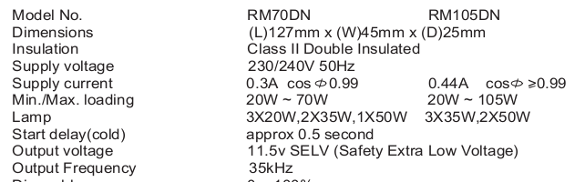

20 min//70W max. per output is the only sensible conclusion I could come to given the apparent contradiction between the "LV lamp 20-70W/6.0A max." marking and the overall 105W rating.
The "35 - 105" description appears to be Screwfix's. The manufacturer's specification says 20W minimum total load:
