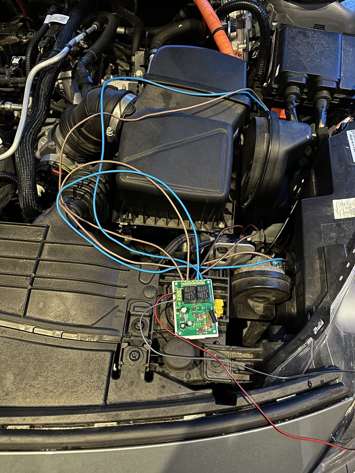

In short, my EV makes a horrifically loud and weird noise when reversing. Which is the law… ‘The problem’ is, this echo’s through my cul de sac when I arrive home late.
As per that forum thread I linked to. I have wired up a resistor to ‘cancel’ the noise, but because it’s not exactly pedestrian friendly… I want to have the ability to toggle the sounder…
So having the choice to switch channels/sources, between A/B, is the idea.
A, being the default, ON, via stock wiring.
B, being OFF/cancelled/routing to the resistor.
C, also this is just a learning experience…
I think maybe you could do that just using channel A that always defaults to the NC contact, use that for the thing to sound, when switched it changes to the NO contact, use that for no sound and connecting the resister
Just leave channel B unused

In conclusion, thanks to your help… it worked…
Will I actually use it? Maybe, maybe not. Part of this was purely a ‘what if’ learning task

My concern for wanting to swap both wires was based on believing you had two completely different audio sources - if both were differential amplifiers, commoning the negatives could have been a problem.
As it is, your sources are exactly the same - you've just added resistance - commoning the negatives will be fine.
If you still wanted to play, your two channels give you the option for 3 settings - if you swap the module back to 'toggle' mode:
A and B off, the default, full volume
A on, B off, reduced volume through resistor.
A on and B on, no sound...

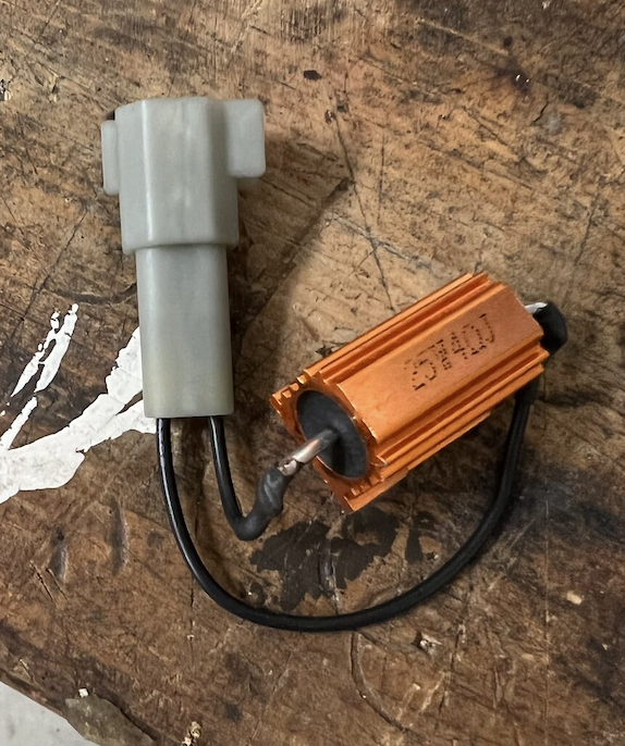

Out of curiosity, what is the resistance and wattage of the resistor you have chosen?
Cheers @RandomGrinch … the problem with the third option is that if the car doesn’t detect any load, it gives an error. So one has to be selected by default…
The resistor is a 25w 4ohm Resistor.
