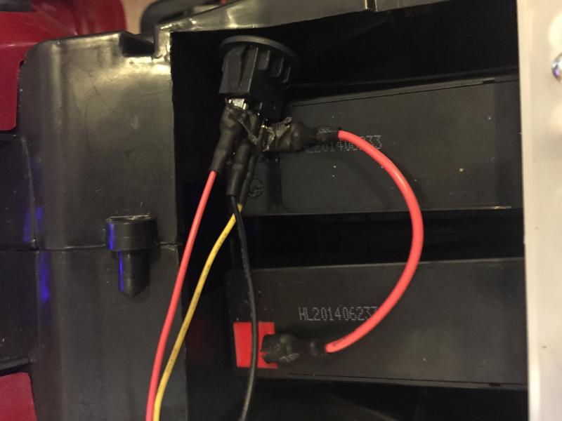

I tested the bike when I got home as you said and when I plug the charger in Im not getting any increase in voltage over the 13v no matter what combination of black yellow Etc I try!!
After giving up I went to move the bike back to where we store it and I never realised that I had the charger socket balanced on the battery itself, and low and behold the whole thing suddenly started working when the yellow wire touched the red wire of one of the batteries (see below)
As soon as I moved it or removed it, it all died again, and the U it only showed that it was getting 6v (there's a little battery indicator on the display I never knew was there when it's working) if I pressed the foot pedal the motor would not run but the charger wasn't plugged in so it was effectively running off the battery..
Does this prove that the socket is faulty? Even tho if I touch the red black and yellow wires together without the socket , it still doesn't load up.. Or am I bypassing the faulty component somewhere else??

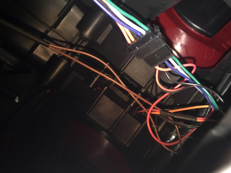

Finally I also managed to get a picture of where those VCC GND etc wires go off to under the bike and on/off switch..
Hope some of this helps ...
Edit: weirdly I've now just gone back to the bike after a couple of minutes (was gonna show the wife what I discovered), and even when I touch the yellow on that leg of the battery again, it no longer works, but just now I was able to lift the socket off the battery and put it back on and it was working on an off
At this point I would be looking for a fault between the charger socket and the battery that has disconnected the battery.
Probably something inside that plastic module.
At this point I would be looking for a fault between the charger socket and the battery that has disconnected the battery. ... Probably something inside that plastic module.
Indeed - I suppose it's always been fairly likely that we would end up there ...
I fear that, sooner or later, we are probably going to be left, by default, with thinking that something must be wrong within that 'PCB' housing.
