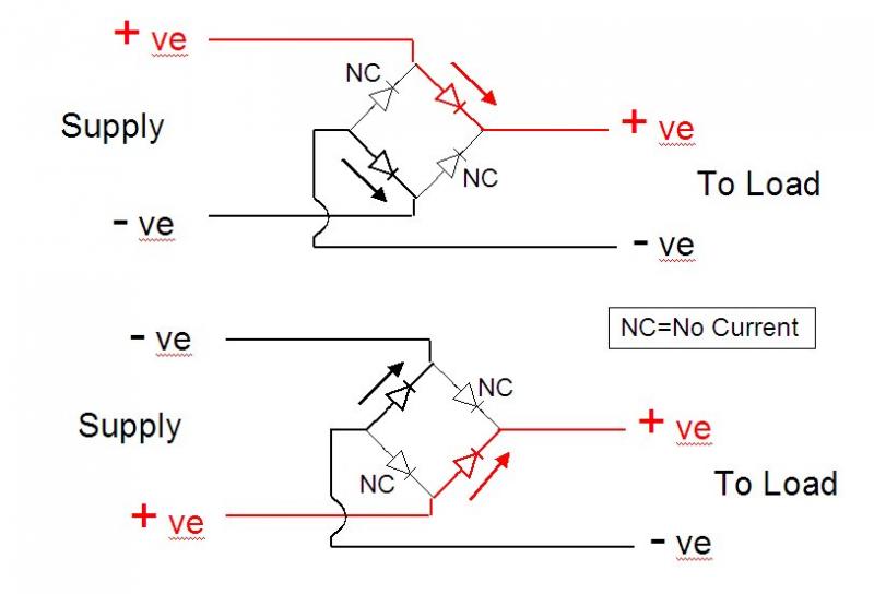

A bridge rectifier is rated for rectifying AC, not sorting out the polarity of a DC input. If you feed it DC, only two diodes will conduct, and the rating must be reduced.
Are you just quibbling about the fact that I refered to it as a 'bridge rectifier', rather than 'a ring of four diodes'? As I said, it's been a recognised way of 'sorting out the polarity of DC' for decades - and I've made it clear all along that I was talking about DC. Indeed, this whole thread has been about the polarity of DC LED lamps.
As for 'the rating must be reduced', even that's not true in terms of maximum current rating since, even with AC only one pair of diodes is conducting at any given point in time (after all, AC is effectively DC which keeps changing polarity!).
In case anyone is not clear of what I'm talking about, this is the standard arrangement for using 'a ring of 4 diodes' (aka 'bridge recifier') to provide a DC output of fixed polarity, regardless of the polarity of the DC supply:

Peak currents are time limited, the thermal mass of the diode determines how much peak current can flow and for how long before the diode overheats to the point of destruction.
A bridge rectifier rectifying AC will be dissipating the heat from 4 diodes. When the same bridge rectifier is used with a DC supply only two diodes are dissipating the same amount of heat that 4 would be when the supply is AC
Running on DC the maximum safe continuous current may be less than the maximum safe continuous current for AC
The derating for use on DC depends on the construction and method of heat disipation inside the bridge rectifier
Peak currents are time limited, the thermal mass of the diode determines how much peak current can flow and for how long before the diode overheats to the point of destruction. A bridge rectifier rectifying AC will be dissipating the heat from 4 diodes. When the same bridge rectifier is used with a DC supply only two diodes are dissipating the same amount of heat that 4 would be when the supply is AC. Running on DC the maximum safe continuous current may be less than the maximum safe continuous current for AC. The derating for use on DC depends on the construction and method of heat disipation inside the bridge rectifier
Yes, I agree with that, but I'm not really sure what/why we are arguing about. As I said, the use of a diode bridge to achieve supply polarity independence for DC equipment is very well established, and I have used in countless times (for currents varying from trivial to very large) over the years/decades. All that matters is to make sure that the diodes can cope (at operating temperature) with the DC currents involved - not a problem with present-day components. Nor did I necessarily mean custom-made 'bridge rectifiers'; on the contrary, I've usually used discrete diodes for this purpose.
