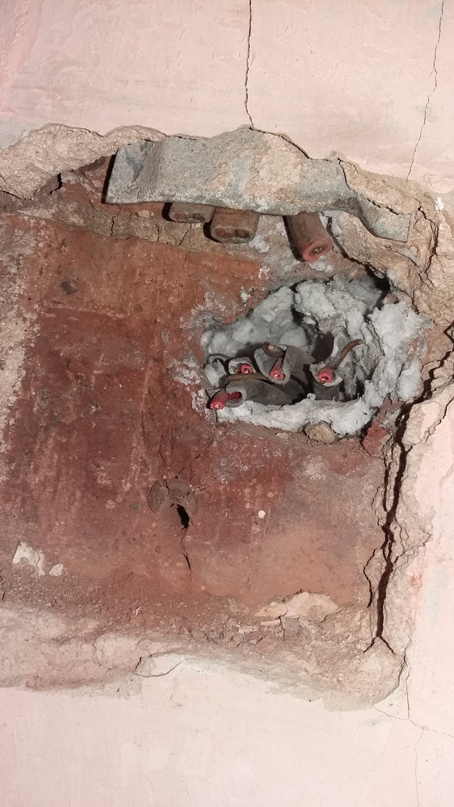

I have a house built in the 1950s for the local authority. On peeling back the decor, plaster, ceilings, etc we have revealed interesting combinations of wiring.
On an original (pink) plastered wall, a socket wired in pvc in undisturbed pink plaster. Yet in the ceiling above there are (unrelated) VIR cables. Were houses ever wired with a combination of VIR and pvc? When did pvc start being used? What were the standards in the 50s?
Am I mistaken that this pvc cable is original? Could it be newer?

I don't think PVC cable can be original to the house. I have seen lead-sheathed and VIR of that age.
However, it could be the same age as the plaster, which is not the same thing.
How many strands in the cores, and what colours are the strands, and the insulation on the three cores? What shape are the pins in the sockets?

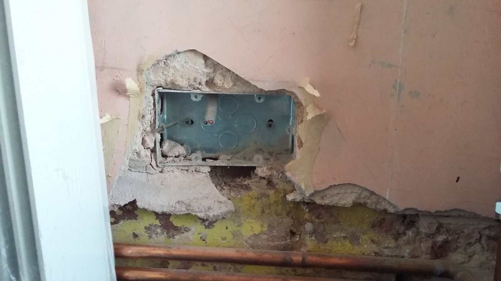

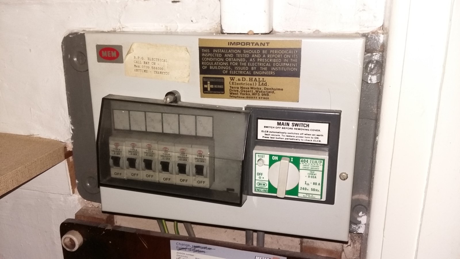

The pvc is stranded so imperial sized. Now I think on the house had a late 80s rotary type main rcd consumer unit when we bought it. So at least this had been replaced.
But see my picture of the socket back with a mysterious pvc wire disappearing into old plaster. When was pink plaster last used? This wall certainly looks original. There is no visible capping or conduit.
Then the switch position on external wall. The capping contains a mix of vir and pvc, then the pvc cables coming from the cavity were in use when we bought the place. I just can't work any of it out!

PVC insulated wiring was available from the late 1950s, and in common use by the early 1960s, at which time rubber insulated wiring was no longer used.
In the 50s there were houses which were wired in both PVC and rubber.
This was simply because at the time both were available, and one would use whatever was in the van.
I have seen a house built in 1953 with both systems.
Since it was all neatly buckle-clipped to the joists under the floor it was clear this was all original.
The pvc was in excellent condition, and hardly needed replacing - the main issue was no earth wire in the lighting cables.
As I recall the cooker cable was rubber, so no doubt the electrician had some old 6mm2 equivalent to use up.
Send more pics if you can, always interesting to see old wiring, and how well it is usually installed.
I used Sirapite in the 1980's as a finish over bonding or browning. it dried pink, but plasters used to vary in colour according, I suppose, to the materials used in the batch, or possibly where they were sourced.
But judging by the variety of colours, I think yours is a later patch or refurb applied to the old wall. The whitish colour plaster might be lime, which was out of general use before my time.
