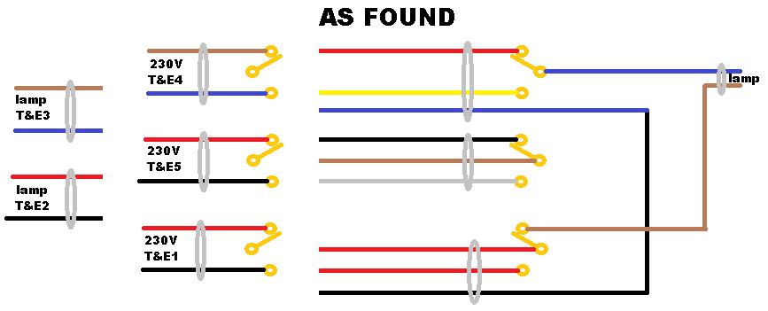

My first was for a builder who had cut a door opening in a wall and the second switch had gone with the rubble, not understanding the wiring I converted the replacement system to conventional with a connector behind the remaining switch. Then later sat with pencil and paper...
In the end the site was not available on Monday, 8PM Friday was when they wanted me in.
The back story is the builder took switches and sockets off and made notes of how they were connected, The original terminal numbers and wire colours but no indication of cables. Excuse my additional notes in black.
When I arrived with my colleague I found (for safety) he had connected the '3 power in' cables connected to L1 & L2 terminals in the replacement 3G switch, leaving the lamps and strappers disconnected in the left switch. The whole of the right switch was terminated but with errors. Other than identifying the live cables he had not tried to prove what the other cables are.
The 3 feeds are on different phases.
We proved and marked the cables, confusion crept in as there is an intermediate in the harmonised strappers (not shown in sketch) and of course it was in the 'operated' position, reversing the black and grey.
Comparing with the DB listings it was then easy to wire as:
Connectors shown as pink stars.
Simple once there but difficult over the phone, especially as he confused me by calling them 3 way and Chicago/California method.

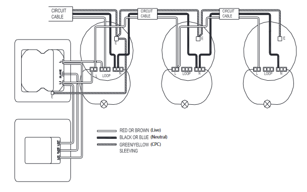

the problem is to use it means a connector block in the switch, so we have used this
but today we seem to be moving yet again this
with a slave terminal seems to be the new method, which allows the dimming to be controlled from either switch, or in this case also can use a remote control or hub and internet control. The main problem is
MIHO43 User Guide said:
IMPORTANT:The Master and Slave units will NOT operate with any other manufacturer’s switches in a two way configuration. Doing so will permanently damage the switch units.
it seems gone are the days of mix and match.
