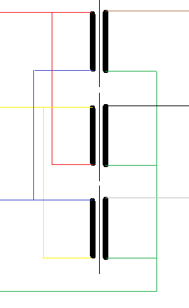

My comment is based on the configuration of the transformers, I can't identify all of the primary wiring but I think it's wired Δ as shown in old colours and the secondary wired Y with earthed mid point as shown in harmonised colours:
Of course it's possible, but doubtful, this is is 11KV to 5KV or something.

While the "usual" practice in North America is to supply each "premise" with a single phase 240 V secondary supply, "split" by using an Earthed/Neutral Centre Tap from a single transformer - so that there are two supplies of 120 V out-of-phase by 180 degrees - (as illustrated in the first picture), in some cases what is supplied is 2 out of 3 phases of 120 V secondary supplies (relative to the Earth/Neutral) - so that the supply derived from between two of these phases (out-of-phase by 120 degrees) is (only) 208 V.
The situation is shown in
https://www.thermalcorporation.com/208-volts-is-a-weird-voltage-where-did-it-come-from/
and "explained" in
and
