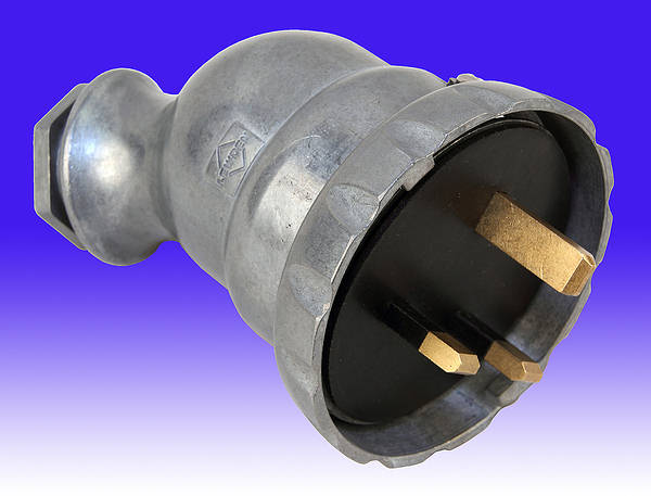

%A plugs with fuses are certainly availableee, but I'm not so suree about 2A ones - havee you found theem?
MK certainly used to make them, but I'm not sure if they do anymore. The part number is 639 WHI but the only supplier listing I found was listed as discountinued https://www.rapidonline.com/mk-639whi-round-pin-mains-plug-2a-fused-white-23-0331.
Agreed, and IF fused 2A sockets exist, I'm not sure what fuse they would have (a BS 1362 one would probably not fit).
Fair enough - as I said, I don't think I've ever seen a fused 2A plug. However, I wonder where the fuse goes, with those screws where they are, I presume it must have going lengthwise 'up the middle'?
Assuming you mean plugs, all of MKs fused BS546 plugs took BS646 fuses.
Yes, sorry, I obviously meant plugs - and yes, you're probably right about the BS646 fuses.

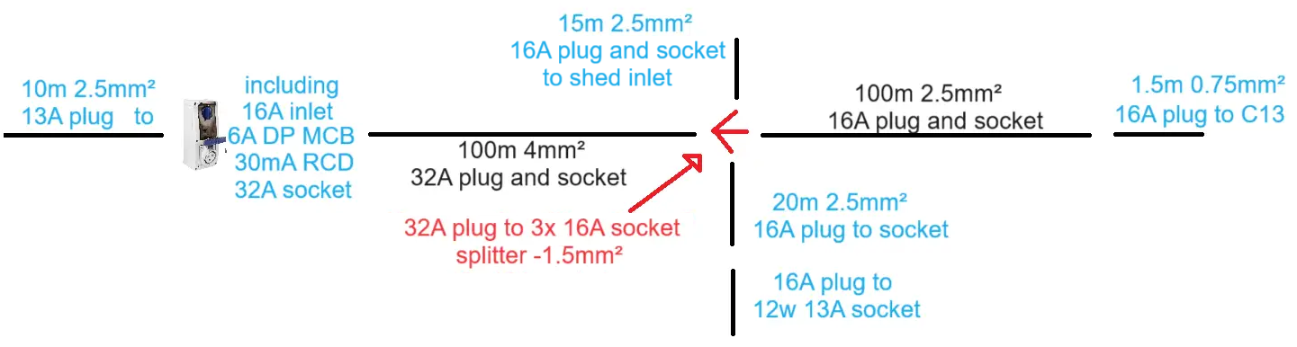

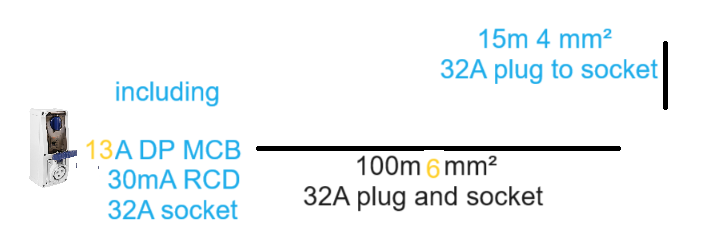

Which is why I'm conflicted too often, yes I have an adapter cable; 2A plug to blue 32A socket, 0.5 or 0.75mm² 3c flex about 3m long which I assembled for a specific job and used a number of times once per year. Do I have any form of widow maker? yes of course. Do I have big plugs on small cables? you bet, including a 63A plug on a C13 and a 128/3 male to 16/1 female etc but all kept strictly under my control.
Would I sell or hire any to a customer? NFW as I have no idea where it may end up or what botch they may do with them.
One of my regular jobs 3-4 times per year grew from a fairly simple PA system with a 50m run for my power to providing power for the organisers for a light and till in a hut and a till at the entrance
Would I dry hire that to a customer? No
However they wanted more regular power in their hut without running a generator (it died) so They had the 32A socket fitted to the house and upgraded inlet and installation in shed, then rolled the cable out as and when required, I added the rest when providing PA. I supplied this:
Kind Regards, John
Look at my post on page 2 for pics of a Fused 2a plug to see where the fuse is,ie in the same position as 13a plugs
So it does. However, although a similar arrangement might conceivable just about be possible in the one that plugwash linked to, it stilllooks to me as if it would be a bit of a struggle with those screws where they are ...
