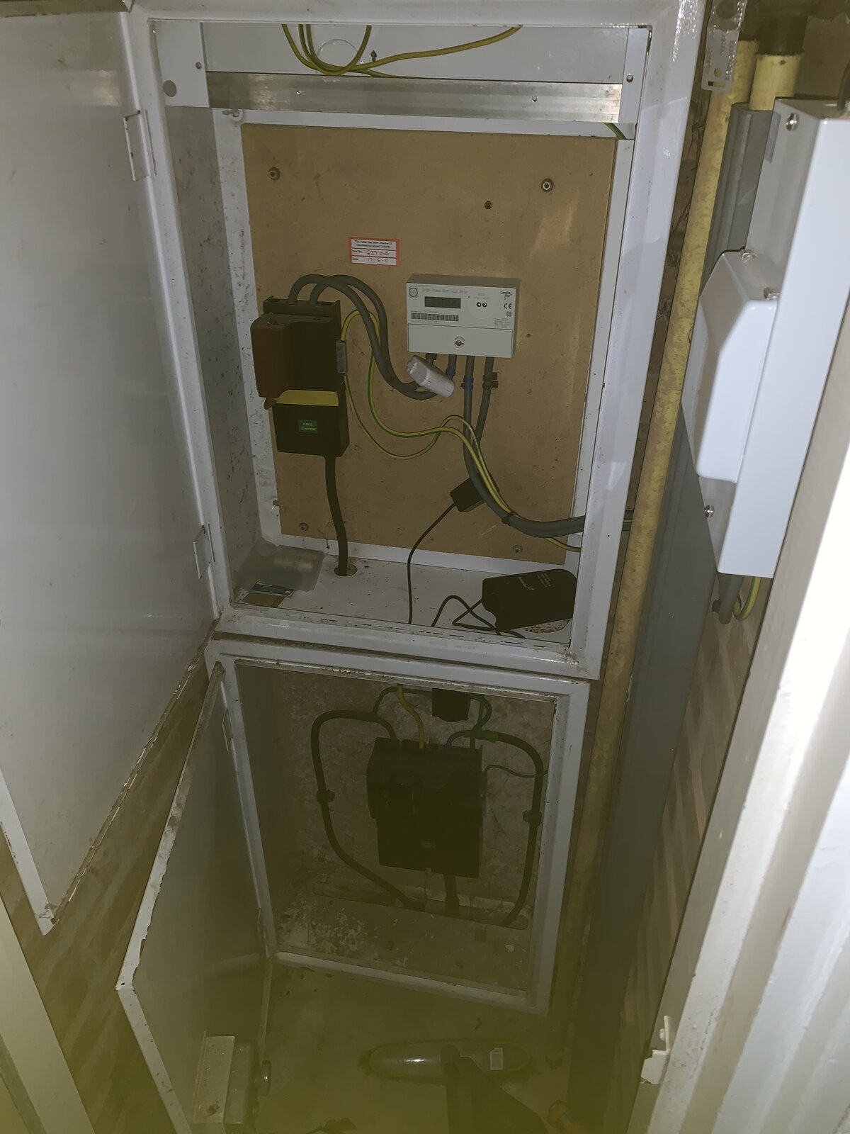

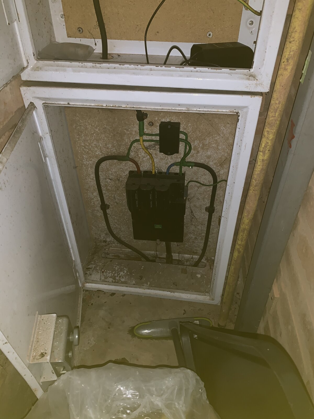

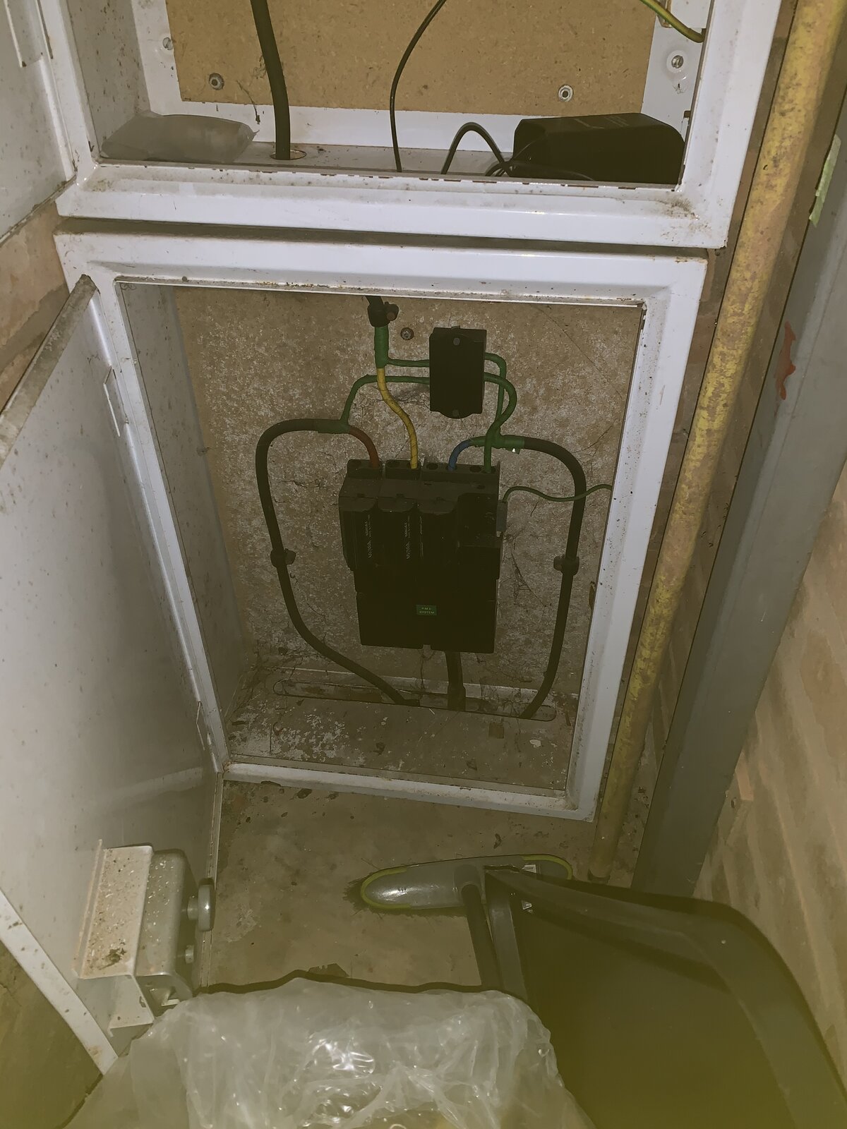

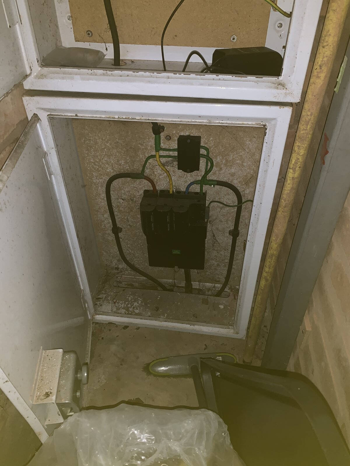

From my own house.
I live in a terrace of 5 houses (ex council) and have a three phase cutout into the one meter box which serves my house and the neighbours either side. Only links are in the single phase cutouts in the ‘meter’ box. So if one of the neighbours were to blow a cutout fuse, WPD would need access to my porch to replace the fuse.
I discussed it with an engineer I know from WPD and he said it was common at the time (mid 70s) and it is referred to by them as a looped supply

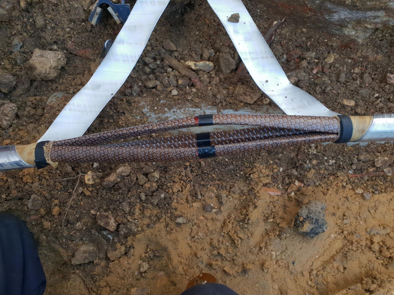

We have the dreaded consac cables feeding this estate and I’m reliably informed that this method was used to reduce the number of joints on the cable
For anyone that doesn’t know, Consac cable is notorious for failing, particularly at the joints, to the point where most DNOs that have it on their network have started running schemes to overlay it. More that one person has told me in the past that consac was only ever designed to go from A to B (think between transformer and switchgear) and not meant to have multiple services jointed onto it
From my own house. ... I live in a terrace of 5 houses (ex council) and have a three phase cutout into the one meter box which serves my house and the neighbours either side. Only links are in the single phase cutouts in the ‘meter’ box. So if one of the neighbours were to blow a cutout fuse, WPD would need access to my porch to replace the fuse.
I discussed it with an engineer I know from WPD and he said it was common at the time (mid 70s) and it is referred to by them as a looped supply...
Interesting. If they call it a 'looped supply', I suppose that must be because, in a physical sense, there is literally just one 'cable' serving three installations.
However, if you're saying that each of the three properties is fed by a separate phase (albeit fuses for all three are in your house) then, thinking 'electrically', I don't think that "even I" would call it 'looped', since no line conductor is carrying the current of more than one installation - i.e. it just 'happens' that the three line conductors (on different phases) spend some of their path inside a single outer sheath. If the three L's split into three separate 'cables' outside of the properties, I don't think anyone would consider the supplies to be 'looped' (regardless of where the fuses were), would they?
As you imply, and as I previously mentioned, there is obviously a bit of an issue (convenience and safety) with having all three fuses in the same house - 'convenience', as you say, if the DNO need to replace the fuse for one of the other houses but, potentially, 'safety' if flames are coming out of the meter or CU (assuming no external isolator) in one of those other properties.
We have the dreaded consac cables feeding this estate and I’m reliably informed that this method was used to reduce the number of joints on the cable ... For anyone that doesn’t know, Consac cable is notorious for failing, particularly at the joints ...
I must confess that I've never heard of it (what exactly is it, I wonder?), but it would certainly afford an explanation as to why they fed the installations in that way. Mind you, I wonder why they used it (cheap?) - on the face of it, if they knew that it was so likely to fail that they had to adapt their practices to minimise joints, one might have expected them to decide not to use it at all!
Kind Regards, John

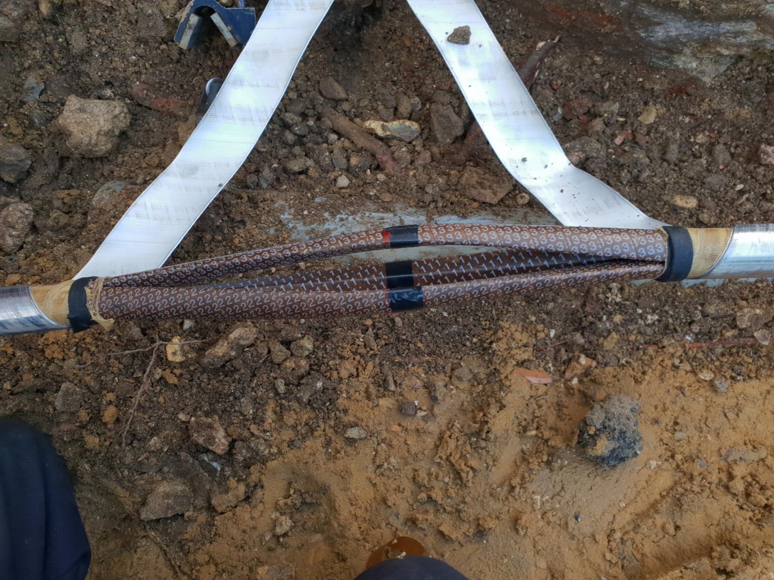

Consac is Concentric Cable with Solid aluminium conductor.
Seen here, it’s a three core paper cable with an aluminium N/E outer and a PVC oversheath. It was a cheaper cable that PILC which was typically lead with copper cores. There is a special depth saw to strip it live (as in the picture) to retain the neutral/earth continuity. I believe though that after a few incidents that some DNOs won’t work on it live anymore. Certainly on the larger sizes, the aluminium outer could be thicker on one side that the other so the saw would go through the paper cores as well resulting in a bit of a bang
The other issue was third party damage. If the sheath was ‘nicked’ during laying or other roadworks, water Ingress would rot the aluminium, over a Period of time and then one day, you’d have part of an estate losing the neutral and earth supplies which as you probably know has interesting effects! I believe Alpex cable has similar issues (alpex is waveform cable with aluminium n/e strands in rubber bedding around the aluminium cores) which is why modern waveform cables are aluminium cores with copper neutral and earth strands
I agree with you though on the looped supply designation, all that is different that three independent supplies, is that there is one joint and it all goes via my house. Interestingly though all three are fused at 60amp. Hypothetically If I were to enquire with WPD about installing a vehicle charge point I’d be interested to know if they would alter the setup. For information, vehicle chargers are not recommended on looped supplies and I believe all DNOs are obliged to alter supplies to remove the loop free of charge if you request it
Consac is Concentric Cable with Solid aluminium conductor. ... Seen here, it’s a three core paper cable with an aluminium N/E outer and a PVC oversheath. It was a cheaper cable that PILC which was typically lead with copper cores. There is a special depth saw to strip it live (as in the picture) to retain the neutral/earth continuity. I believe though that after a few incidents that some DNOs won’t work on it live anymore. Certainly on the larger sizes, the aluminium outer could be thicker on one side that the other so the saw would go through the paper cores as well resulting in a bit of a bang
That sounds like a bit of a nightmare - and, from what you've said, the only 'advantage' of it is cost?
That's presumably just a question of the CSA of the conductors and the capabilities of the local supply, isn't it? If the cores of the 3-phase cable have the same CSA as they would have used for a single-phase supply to a single installation, then I presume the 'possibilities' as regards fuse rating would be the same?

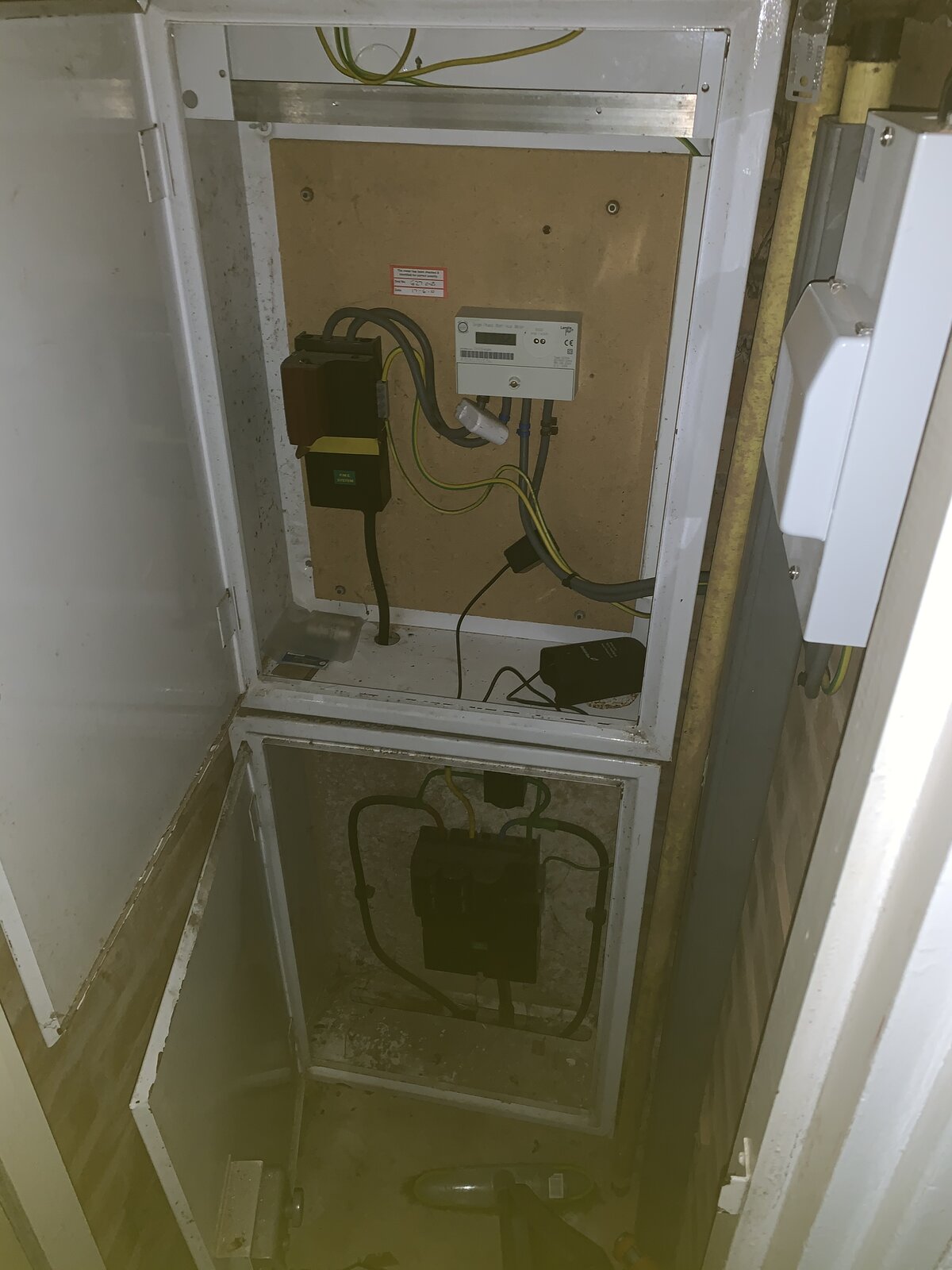

From my own house.
As has also been said in following posts this is not what I'd call a looped supply, if that is the acceplable term for this installation then so be it and I'll try to get into the habit.
However if the supply companies are removing looped supplies I'll bet a pound to a penny this installation will very quickly be reclassified to a different title as there doesn't seem to be technical reason for its alteration.
As I've said (and jelliottelectrical seems to agree), in that situation, with three different phases, each with totally separate conductors/fuses, I personally definitely would NOT regard it as being in any sense 'looped'. It only differs from a plumb-normal set of three installations in that (a) the three (different/separate) L conductors 'happen to be' within the same outer sheath for some of their path and (b) the fuses for all three (separate) single-phase installations 'happen to be' in one house.
In this case (with three separate single-phase supplies, absolutely nothing 'common') I would certainly agree that there is no technical/electrical reason to change it (the only conceivable reason I can think of being that relating to 'access to fuses'). However, if it were (what I would regard as) a true "looped supply" (i.e. with one L conductor carrying the total current for two or more installations) then there could be good 'technical reasons' for alteration, particularly if an EV charging facility were being installed in one (or more!) of the houses.

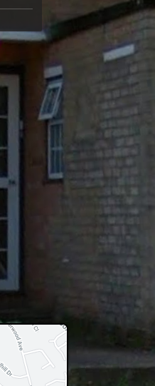

I suppose I have to take your word for that, but I have to say that I don't recall having seen any terraced/semi houses with 'sheds adjacent to the front door' - and I'm not even sure what the Planners would have to say about sheds in front gardens! Do you really mean 'shed', rather than some sort of 'cabinet'.
The word 'shed' is somewhat unintuitive. The irony is I have worked in 2 such properties recently but they are both in pedestrian walkway locations and not visible on Street View, hopefully this sketch will offer a better idea:
Typically there are a pair of walk in cupboards, my 2 recent are ~3x3ft and 5x3ft, which are often crammed to the gunwals with the sort of things usually found in the garden shed. It usually contains the meters and CU and commonly one has the I/C services. With a single head it's a perfect example of my 'Two Services'. May be 2ph but bearing in mind these date from >40years ago when power demand was nowhere near todays it's commonly 1ph with 2 fuses and sometimes even just the one fuse.
If there is joint access' to the 'shed', then I suppose that's not too bad. However, that's not really what we have been talking about (and is more akin to the multi-occupancy buildings you go on to mention). If the equipment is within one of two dwellings, then there are clearly some potential issues (in relation to both 'safety' and logistics/convenience) houses if the DNO fuse for one dwelling is within the other (and not necessarily always easily 'accessible').

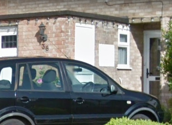

The word 'shed' is somewhat unintuitive. ... hopefully this sketch will offer a better idea:
Thanks for clarifying - so, as you say, essential an 'outdoor cupboard', closer to the 'cabinet' I suggested than a 'shed'!
... With a single head it's a perfect example of my 'Two Services'. May be 2ph but bearing in mind these date from >40years ago when power demand was nowhere near todays it's commonly 1ph with 2 fuses and sometimes even just the one fuse.
Indeed - but there's a big difference between 1-phase and 2-phase. The 1-phase case is what we've been discussing. However, if it's two separate phases then it's the same as what jelliottelectrical described - which , for reasons I recently explained, I would NOT dream of regarding as 'looped' - it would simply be two single-phase installations whose (separate) conductors happened to share an outer sheath in some places and with the fuses for both being in one house (or shed/cupboard!).

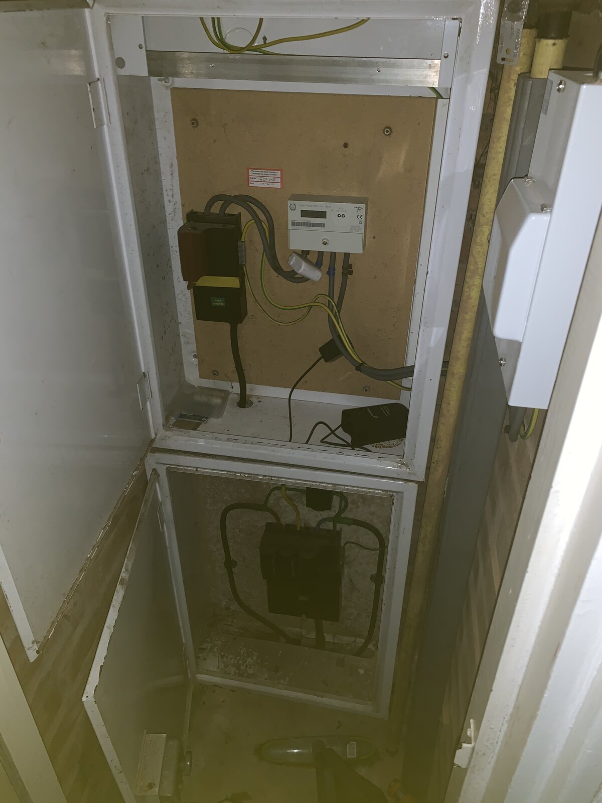

I think more information might help in this situation, I mean if the OP lives in a detached house with some distance between neighbours then it is unlikely that the second fuse ever served a neighbour
My money is on it being an old Dc supply that has been converted and is now just two phases, given the age of the incoming cable and the cutout, and that the fuse holders have been changed
That being said, the village where I grew up has no mains gas, and so a lot of people relied on storage heaters. A lot of people have now a second cutout fuse, that is redundant, having once served all the off peak heating. Most houses now use LPG or oil so they are no longer used. But the bigger houses around here were built like that, obviously too greater load for the one fuse, but not enough to warrant a three phase supply. Though on reflection the majority of these houses I have worked on are still overhead supplies, fed via singles to separate fuses, so I imagine it is easier to run three singles in this case. If it were underground I could see a three phase supply being installed and the third phase just not being used
Not an ideal example but here's one built into a garage [window beside it is downstairs toilet] This one is designed as a dustbin store with cupboard over. All the rest in this road have been bricked up to extend the garage space
