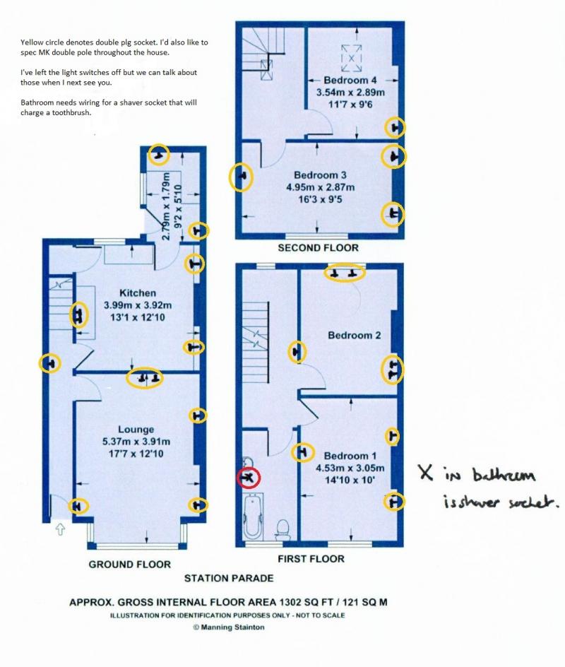

See image below of my plan of the house. Sockets are circled in yellow and shaver socket in bathroom needs to be prepped.
There are no light switches on there but we are happy with the current positions so they will all need replacing. I want to spec MK for all fittings.
The only thing missing is some extra switches for a range cooker etc but again that will be discussed in detail at the house. I'll be going around with a thick marker pen and pointing out everything.

Hi John, The main contractor did indeed say we needed a full rewire and the emergency chap seemed to concur with that. It seems to me that we can replace the CU and replace all the internal sockets and switches and save some money in the process.
Indeed. Most people would say that it would be worthwhile ('safer') to have the CU replaced, and you may well want to replace sockets/switches etc. for essentially aesthetic reasons (and you may need a few extra sockets or whatever), but that would be far less of a job that a 're-wire'. Despite what others seem to be suggesting, I still think it's very unlikely that and major amount of 're-wiring' (replacing cables) would be required. However, as I've also said, I think you really need to start with a formal report (and recommendations) from an electrician based on a 'full proper inspection' of the installation (resulting in an Electrical Installation Condition Report - EICR) - and it sounds as if that may not yet actually have been done.
