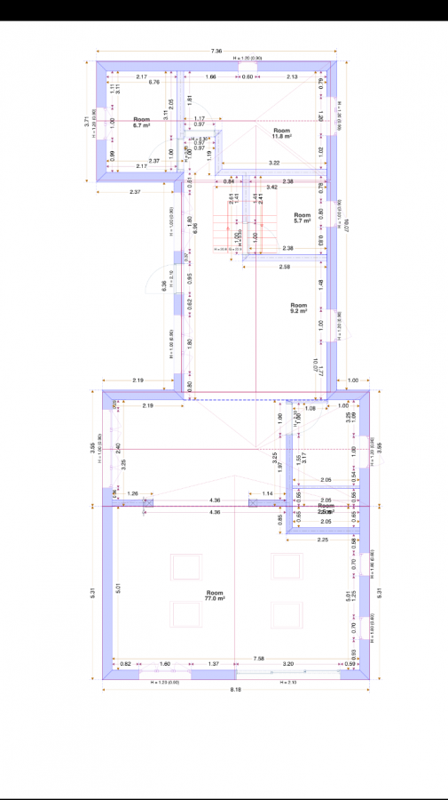

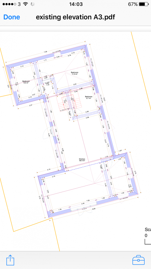

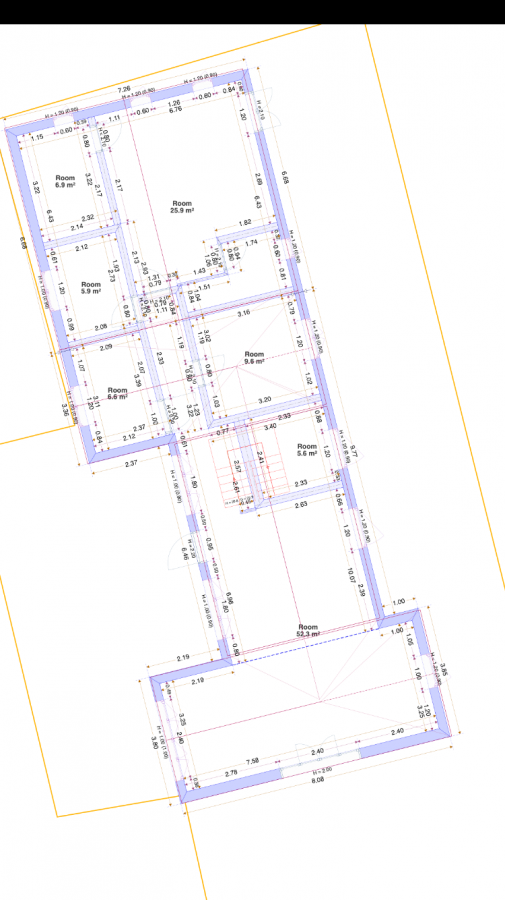

I'll post my plans later today and see what you think.
Existing floor plan - width @ 13.8 m
1 X side extension PD @ 5.31m
Original roof heigh @ ridge (bungalow) 4.8m
Extension roof heights at ridge 3.8m
Eave heights @ 2.7m
If you are so sure that the work is PD, then why are you applying for a certificate in the first place?
Because it's going to cost us obviously a lot of money- we got a refusal for planning on something which was 2cm over the size of a PD extension due to listed building next door so we don't want to have to fight to keep something we've already built- on a technicality. Our local planning is notoriously difficult and have proven to be also less informed than you or I!
